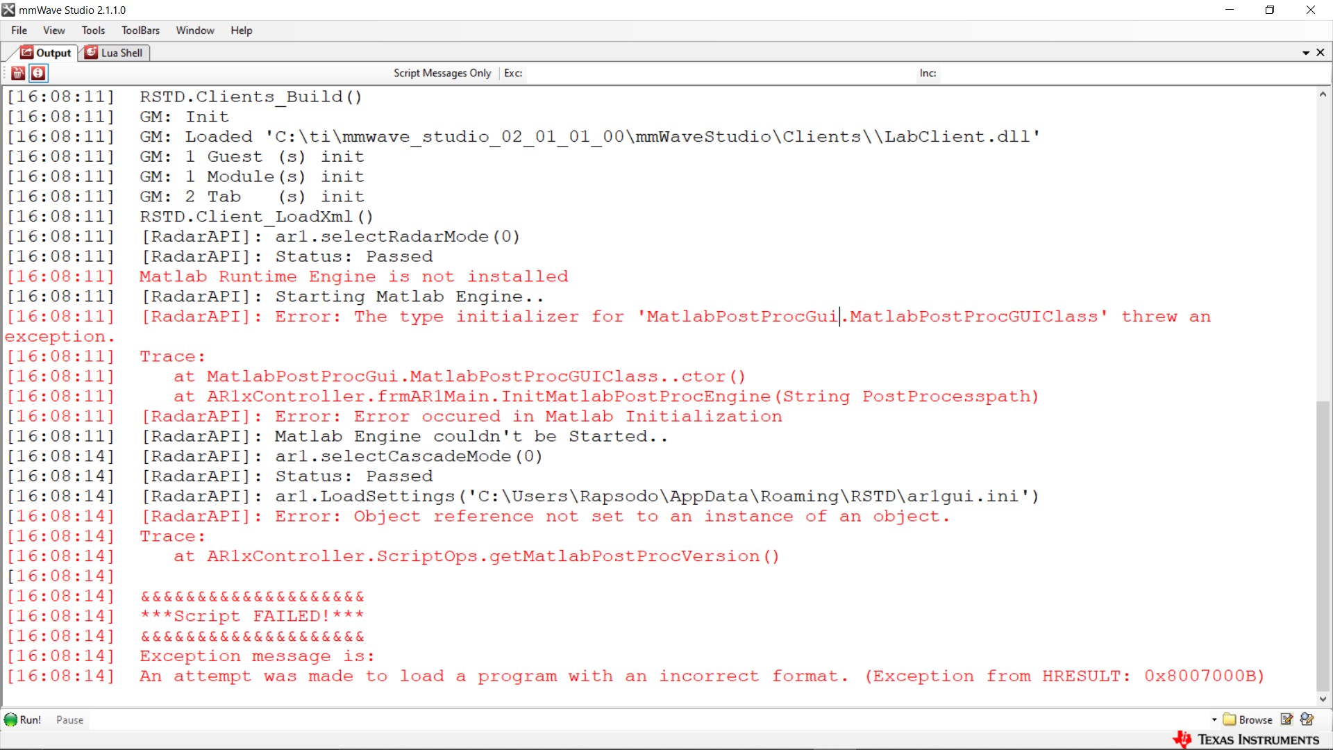

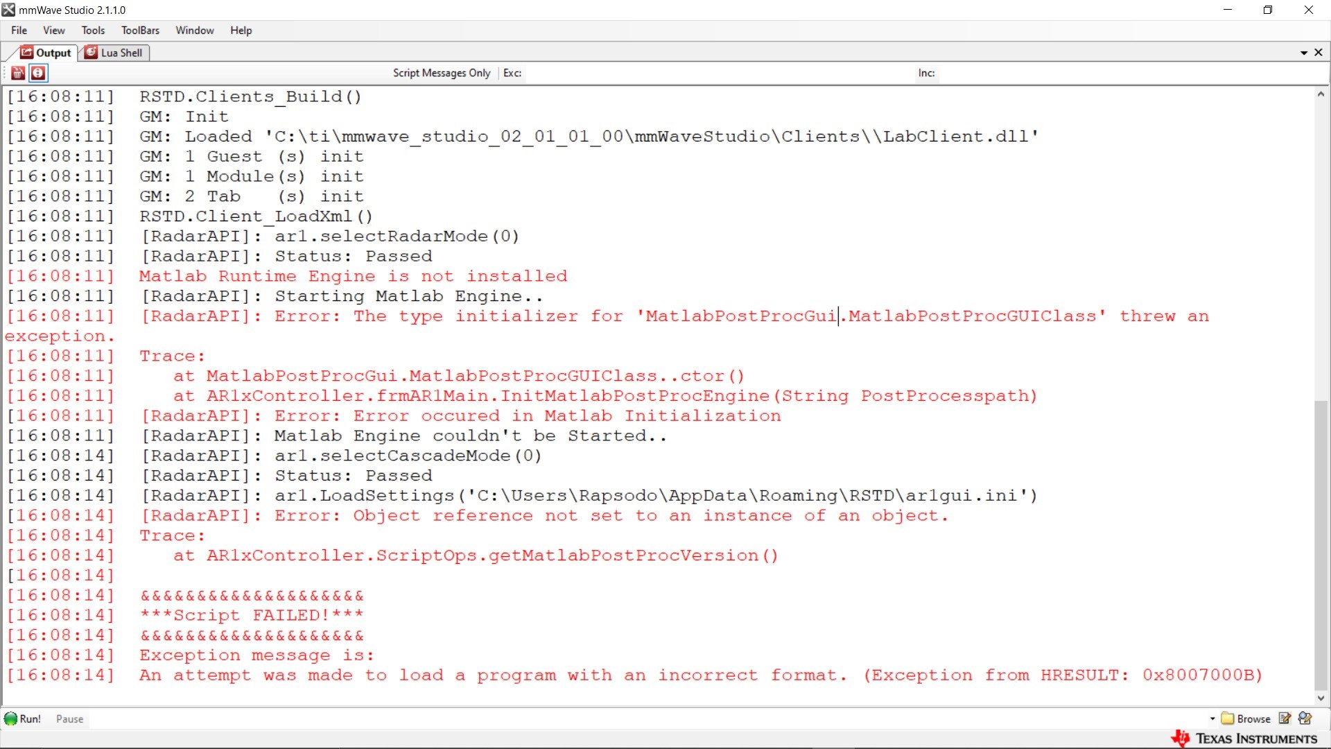

i am using an IWR6843ISK Rev D board and am trying to get it to operate with the CW mode.
However, i cannot do so as there is an error. Please view it a the picture attached below.
Thank you

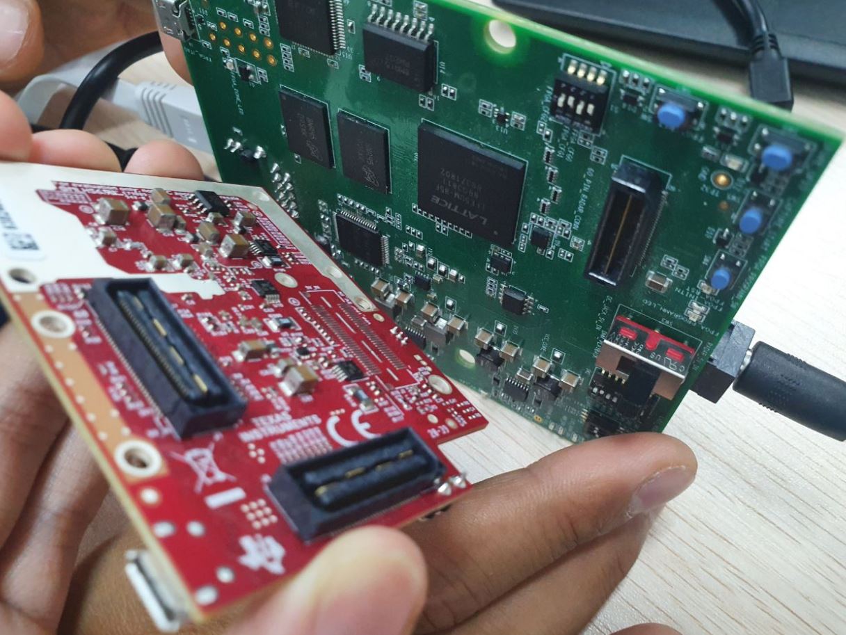

    Additionally, i am using a REV D IWR6843ISK board & a REV A DCA1000EVM board. Are they compatible? However, both boards are no lodging together well.
    Thank You.
  • Hello
    Please look at the very first error message in red in the snapshot and try to resolve that.
    Check   IWR6843Rev D UG,  for how to seti it up for DCA1000 connectivity :  MMWAVEICBOOST and Antenna Module User's Guide (Rev. -)
    Check all steps for DCA1000 guide or follow the training video :  2.4 DCA1000 Training Video
    Please make sure all SW installation steps are followed.
    Thank you,
    Vaibhav

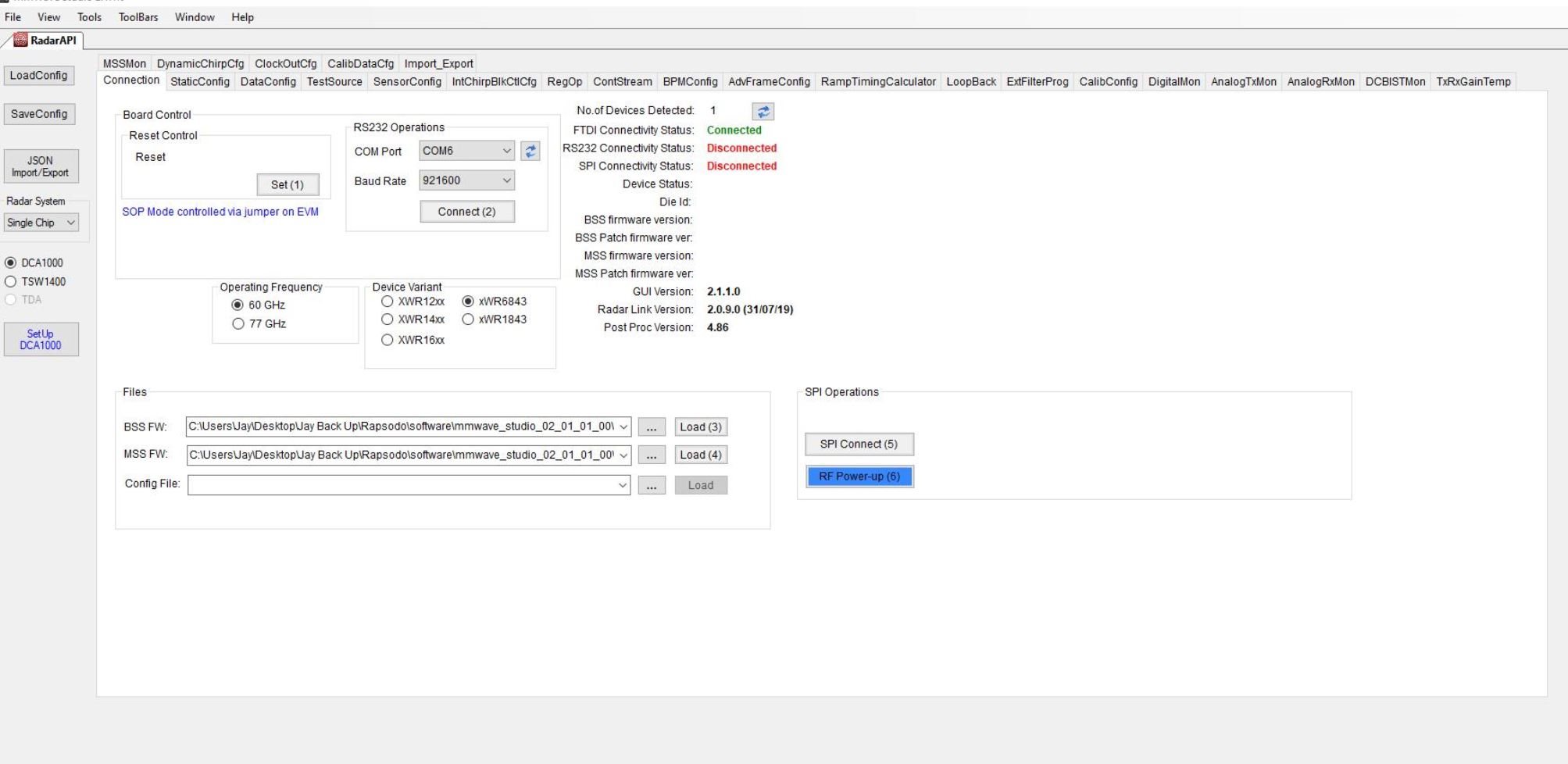

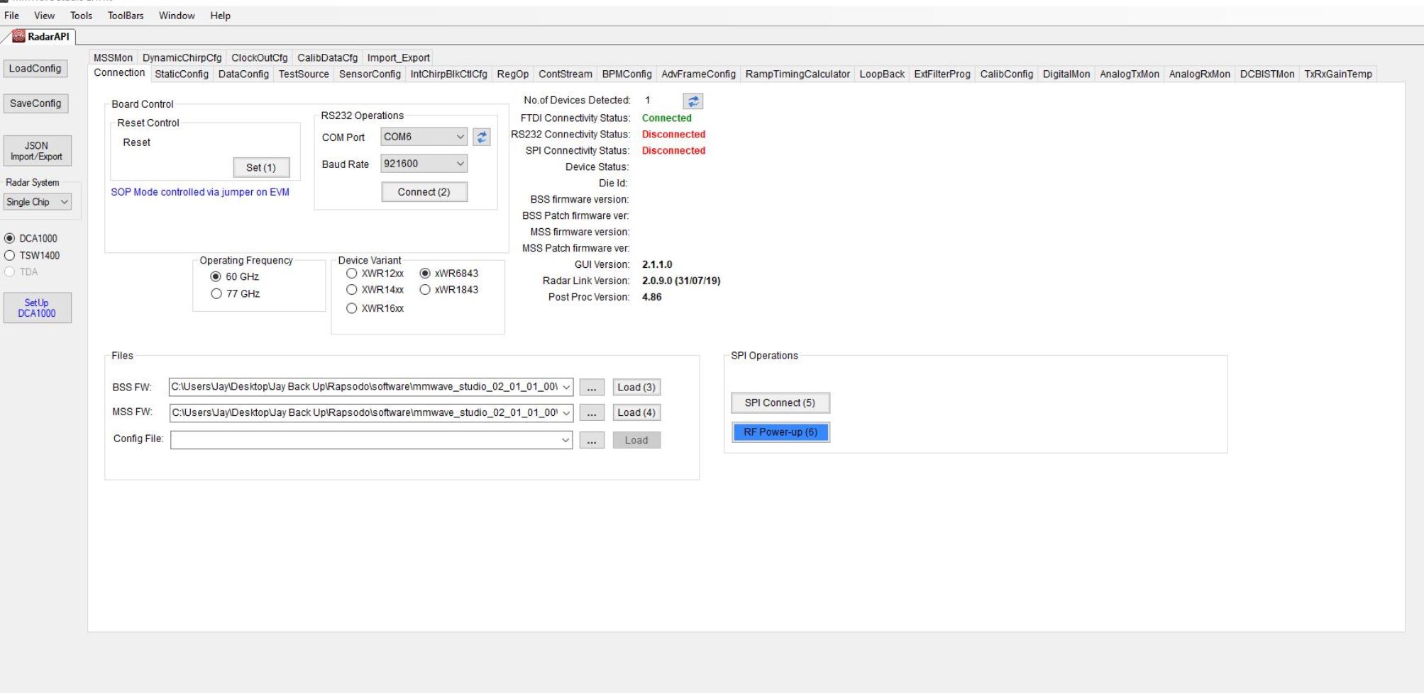

  • Here are some photo that may be useful in helping troubleshoot the issue with not being able to connect successfully via SPI in mmwave studio.
    Since we are using a Rev D IWR6843ISK board and a DCA1000EVM Rev A board, there are some problems in connecting both boards together. Does this affect anything in anyway?
    Here below is the program output in mmWave Studio.
    [14:28:02] [RadarAPI]: Status: Passed
    [14:28:04] [RadarAPI]: ar1.SelectChipVersion("IWR6843")
    [14:28:04] [RadarAPI]: Status: Passed
    [14:28:04] [RadarAPI]: ar1.deviceVariantSelection("IWR6843")
    [14:28:05] [RadarAPI]: ar1.Connect(6,921600,1000)
    [14:28:07] [RadarAPI]: Error: Connection failed: Calling_ConnectTarget returned 3
    [14:28:07] [RadarAPI]: ar1.Calling_IsConnected()
    [14:28:07] [RadarAPI]: ar1.SaveSettings('C:\Users\Jay\AppData\Roaming\RSTD\ar1gui.ini')
    [14:28:13] [RadarAPI]: ar1.DownloadBSSFw("C:\\Users\\Jay\\Desktop\\Jay Back Up\\Rapsodo\\software\\mmwave_studio_02_01_01_00\\rf_eval_firmware\\radarss\\xwr68xx_radarss.bin")
    [14:28:13] [RadarAPI]: Error: Download FW failed with error -1
    [14:28:15] [RadarAPI]: ar1.DownloadMSSFw("C:\\Users\\Jay\\Desktop\\Jay Back Up\\Rapsodo\\software\\mmwave_studio_02_01_01_00\\rf_eval_firmware\\masterss\\xwr68xx_masterss.bin")
    [14:28:15] [RadarAPI]: Error: Download FW failed with error -1
    [14:28:22] [RadarAPI]: ar1.PowerOn(0, 1000, 0, 0)
    [14:28:22] Status: Failed, Error Type: RESP TIMEOUT
    [14:28:26] MSS Power Up async event was not received!
    [14:28:27] [RadarAPI]: Single Chip Configuration
    [14:28:27] Provide Valid Capture Setup File Path
    [14:28:46] [RadarAPI]: ar1.GetCaptureCardDllVersion()
    [14:28:46] [RadarAPI]: Sending dll_version command to DCA1000
    [14:28:46] DLL Version : 1.0
    [14:28:46] [RadarAPI]: ar1.SelectCaptureDevice("DCA1000")
    [14:28:46] [RadarAPI]: Status: Passed
    [14:28:53] [RadarAPI]: ar1.CaptureCardConfig_EthInit("192.168.33.30", "192.168.33.180", "12:34:56:78:90:12", 4096, 4098)
    [14:28:53] [RadarAPI]: ar1.CaptureCardConfig_Mode(1, 2, 1, 2, 3, 30)
    [14:28:53] [RadarAPI]: ar1.CaptureCardConfig_PacketDelay(25)
    [14:28:53] [RadarAPI]: Sending fpga command to DCA1000
    [14:29:03] [RadarAPI]:
    [14:29:03] FPGA Configuration :
    [14:29:03] Timeout Error! System disconnected
    [14:29:03] [RadarAPI]: Sending record command to DCA1000
    [14:29:13] [RadarAPI]:
    [14:29:13] Configure Record :
    [14:29:13] Timeout Error! System disconnected
    [14:29:13] [RadarAPI]: ar1.GetCaptureCardFPGAVersion()
    [14:29:13] [RadarAPI]: Sending fpga_version command to DCA1000
    [14:29:13]
    [14:29:13] FPGA Version : 2.7 [Record]
    [14:29:13]
    [14:29:26] [RadarAPI]: ar1.DownloadBSSFw("C:\\Users\\Jay\\Desktop\\Jay Back Up\\Rapsodo\\software\\mmwave_studio_02_01_01_00\\rf_eval_firmware\\radarss\\xwr68xx_radarss.bin")
    [14:29:26] [RadarAPI]: Error: Download FW failed with error -1
    [14:29:28] [RadarAPI]: ar1.DownloadBSSFw("C:\\Users\\Jay\\Desktop\\Jay Back Up\\Rapsodo\\software\\mmwave_studio_02_01_01_00\\rf_eval_firmware\\radarss\\xwr68xx_radarss.bin")
    [14:29:28] [RadarAPI]: Error: Download FW failed with error -1
    [14:29:33] [RadarAPI]: ar1.PowerOn(0, 1000, 0, 0)
    [14:29:33] Status: Failed, Error Type: RESP TIMEOUT
    [14:29:38] MSS Power Up async event was not received!
    [14:30:08] [RadarAPI]: ar1.DownloadBSSFw("C:\\Users\\Jay\\Desktop\\Jay Back Up\\Rapsodo\\software\\mmwave_studio_02_01_01_00\\rf_eval_firmware\\radarss\\xwr68xx_radarss.bin")
    [14:30:08] [RadarAPI]: Error: Download FW failed with error -1
    [14:30:11] [RadarAPI]: ar1.DownloadBSSFw("C:\\Users\\Jay\\Desktop\\Jay Back Up\\Rapsodo\\software\\mmwave_studio_02_01_01_00\\rf_eval_firmware\\radarss\\xwr68xx_radarss.bin")
    [14:30:11] [RadarAPI]: Error: Download FW failed with error -1
    [14:30:17] [RadarAPI]: ar1.PowerOn(0, 1000, 0, 0)
    [14:30:17] Status: Failed, Error Type: RESP TIMEOUT
    [14:30:21] MSS Power Up async event was not received!
    [14:30:25] [RadarAPI]: Error: ReadRegister failed with error -2
    [14:30:27] [RadarAPI]: Error: ReadRegister failed with error -2
    [14:30:28] [RadarAPI]: Error: ReadRegister failed with error -2
  • HI, there:
    Please pay attention to the switch setting on the 6843 revD board, this information is available at section 3.9 at www.ti.com/.../SWRU546C
    Zigang
