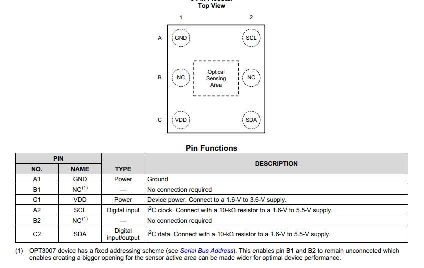

May I ask whether B1 pin of OPT3007 could connect to VDD? If B1 pin of OPT3007 connected to VDD, will the address of device change?
Hi Amelie,
OPT3007 address is fixed so cannot be changed using the NC pin.
Alex
Hi Alex,
Customer want to know whether they could connect NC to VCC?
Because customer want to use the same board between 3007 and 3006.
Just want to know whether NC could connect to VDD.
