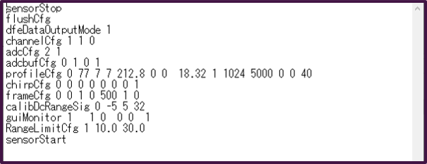

    The following is the settings in the cfg file. We only change the RangeLimitCfg and evaluate the evaluation board.
    Do you have any concern for it?

  • Hi Nomo
    I have no concern over using the RangeLimitCfg but it is used to remove data that is detected outside the range of interest.
    I would need more information about your testing setup and procedure before commenting on accuracy.

  • Hi Akash-san,
    The testing setup is following.
    Evaluation board installation: A fixing jig is attached to an aluminum table fixed to the floor and the board is fixed with screws.
    The measurement target is an aluminum plate. The aluminum plate is fixed to the bogie on the rail, making it less susceptible to vibration.
    The effect of external noise is unknown. It is not a measurement in as shield room or the like. However, the rails for the bogie and other obstacles have been protected against reflection with radio wave absorbers.

    With respect to your test setting using a flat plate you do have to ensure that the alignment is correct otherwise you risk deflecting away the return signal and affecting your SNR. This is why a corner reflector is more commonly used to avoid such concerns. However if you plate is aligned to reflect back to the EVM this should be OK.
    Can you provide more details on the accuracy you are achieving?
    Please note you should be performing range bias calibration as noted in the SDK to resolve any static range offset error.
    With regards to designing a more ideal chirp please look at this thread to understand fundamentals of range accuracy: https://e2e.ti.com/support/sensors/f/1023/p/707391/2607546#2607546
