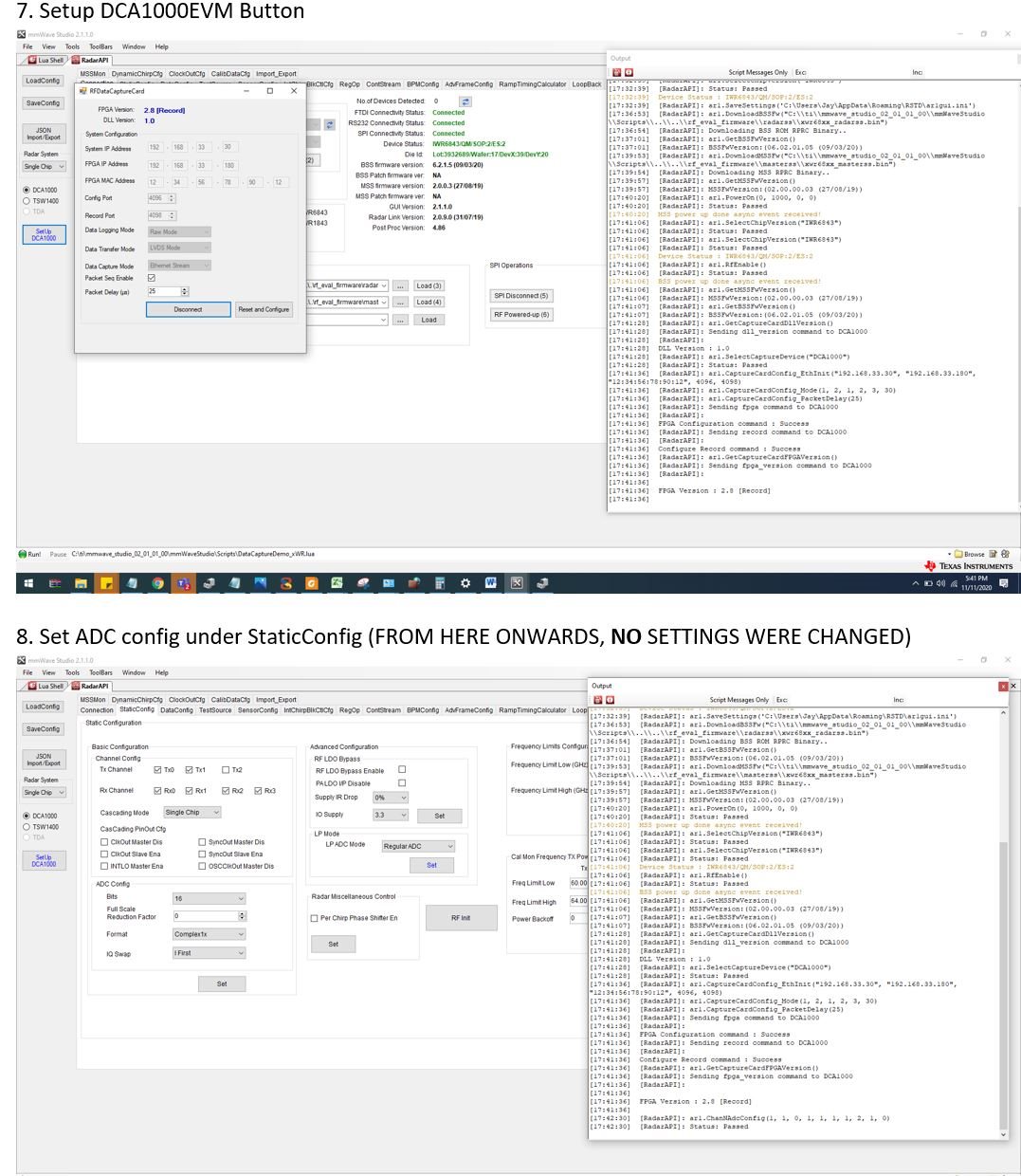

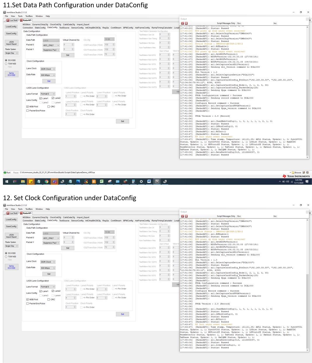

I have issues with saving the bin file and getting data from DCA1000EVM via the ethernet cable. We have followed all the steps in the user guides for mmwavestudio, checked all the switches for all boards and watched the video for getting the raw data from the board via mmwave studio.
we are wanting to get continuous wave and just get the raw data. Here are some things attached BELOW. PLEASE READ THROUGH and SEE ALL PHOTOS.
cf.json:

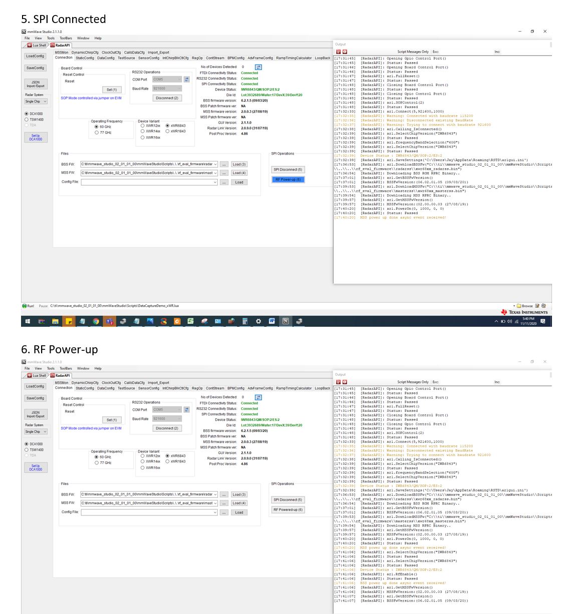

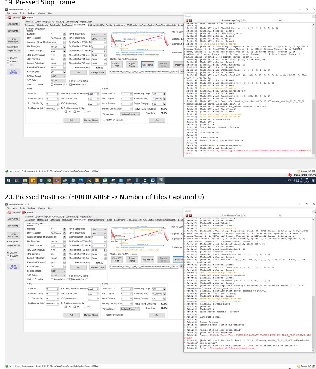

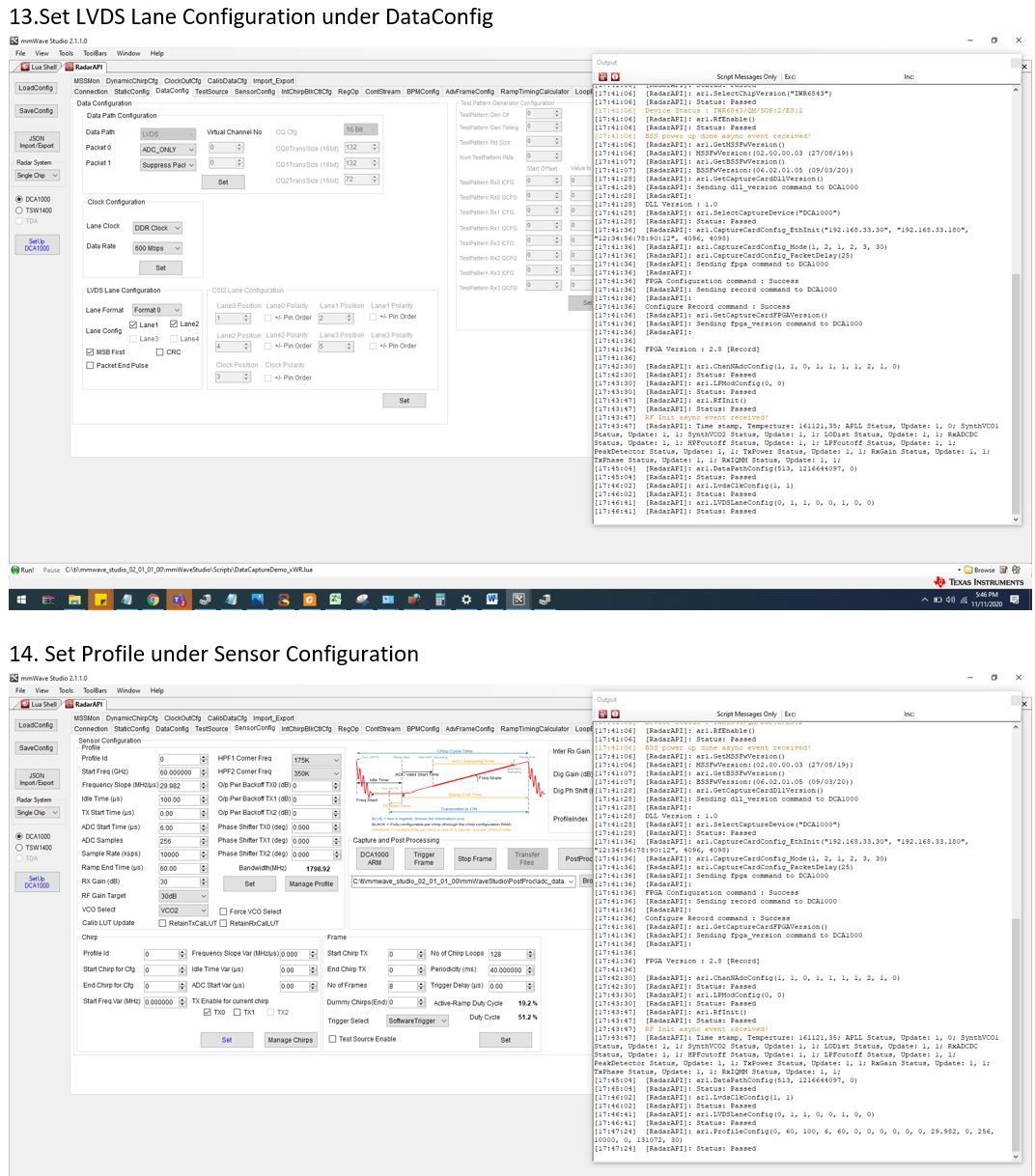

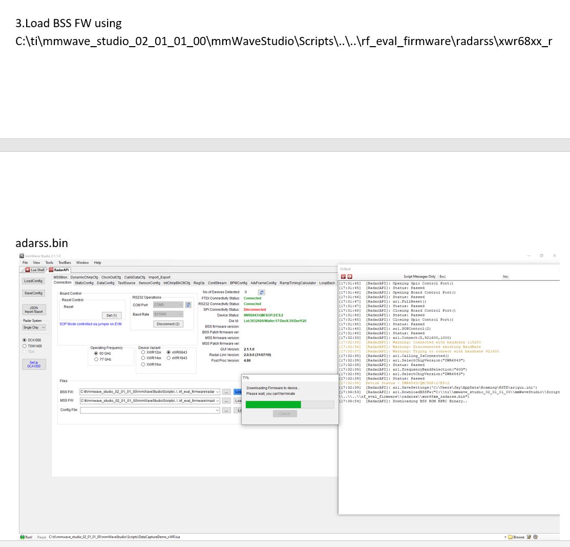

Log File:
09-Nov-2020 18:46:00: IsFPGA:,0,0,
09-Nov-2020 18:46:00: C:\Users\Jay\Desktop\software\mmwave_studio_02_01_01_00\mmWaveStudio\RunTime,0,
09-Nov-2020 18:46:03: API:select_capture_device,DCA1000,0,
09-Nov-2020 18:46:08: API:select_chip_version,IWR6843,0,
09-Nov-2020 18:46:20: API:select_chip_version,IWR6843,0,
09-Nov-2020 18:46:37: API:select_chip_version,IWR6843,0,
09-Nov-2020 18:46:45: API:select_capture_device,DCA1000,0,
09-Nov-2020 18:46:55: API:ChannelConfig,3,15,0,
09-Nov-2020 18:46:55: API:AdcOutConfig,2,1,0,
09-Nov-2020 18:46:55: API:DataFmtConfig,15,2,1,0,1,0,
09-Nov-2020 18:46:57: API:LowPowerConfig,0,0,0,
09-Nov-2020 18:47:01: API:DataPathConfig,1,1,0,2,0,
09-Nov-2020 18:47:03: API:LvdsClkConfig,1,1,0,
09-Nov-2020 18:47:03: TSW1400 Sampling rate : 600000000 7500000,0,
09-Nov-2020 18:47:03: API:SetHsiClock,9,0,
09-Nov-2020 18:47:05: API:LaneConfig,3,0,
09-Nov-2020 18:47:05: API:LvdsLaneConfig,0,1,0,
09-Nov-2020 18:47:20: API:ProfileConfig,0,1491308089,10000,600,6000,0,0,828,0,256,10000,0,0,30,0,
09-Nov-2020 18:47:23: API:ChirpConfig,0,0,0,0,0,0,0,3,0,
09-Nov-2020 18:47:25: API:EnableTestSource,0,1,0,
09-Nov-2020 18:47:25: API:FrameConfig,0,0,8,128,8000000,0,512,0,
09-Nov-2020 18:47:25: API:AdvancedFrameConfig,1,0,0,0,1,128,8000000,0,1,1,8000000,0,0,0,0,0,0,0,0,0,0,0,0,0,0,0,0,0,0,0,0,0,0,0,0,0,0,0,8,0,0,0,0,0,0,0,0,0,0,0,0,0,0,0,0,
09-Nov-2020 18:47:31: API:SensorStart,0,
mmwaveBOOST log:
GM: Constructor
GM: Mon Nov 09 18:45:55 2020
RSTD.Transmit("/Settings")
[18:45:56]
[18:45:56] ### Running Startup script: "C:\Users\Jay\Desktop\Jay Back Up\Rapsodo\software\mmwave_studio_02_01_01_00\mmWaveStudio\Scripts\Startup.lua" ###
[18:45:56] RSTD.SetAndTransmit ("/Settings/Scripter/Display DateTime" , "1")
[18:45:56] RSTD.SetAndTransmit ("/Settings/Scripter/DateTime Format" , "HH:mm:ss")
[18:45:56] Scripter ignored: Attempt to UnBuild() again or before Build.
[18:45:56] RSTD.SetVar ("/Settings/Clients/Client 0/Dll" , "C:\\Users\\Jay\\Desktop\\Jay Back Up\\Rapsodo\\software\\mmwave_studio_02_01_01_00\\mmWaveStudio\\Clients\\\\LabClient.dll")
[18:45:56] RSTD.SetVar ("/Settings/Clients/Client 0/Use" , "TRUE")
[18:45:56] RSTD.SetVar ("/Settings/Clients/Client 1/Use" , "FALSE")
[18:45:56] RSTD.SetVar ("/Settings/Clients/Client 2/Use" , "FALSE")
[18:45:56] RSTD.SetVar ("/Settings/Clients/Client 3/Use" , "FALSE")
[18:45:56] RSTD.SetVar ("/Settings/Clients/Client 4/Use" , "FALSE")
[18:45:56] RSTD.SetVar ("/Settings/AL Client/AL Dll" , "C:\\Users\\Jay\\Desktop\\Jay Back Up\\Rapsodo\\software\\mmwave_studio_02_01_01_00\\mmWaveStudio\\RunTime\\SAL.dll")
[18:45:56] RSTD.SetVar ("/Settings/Clients/Client 0/GuiDll" , "")
[18:45:56] RSTD.SetVar ("/Settings/AutoUpdate/Enabled" , "TRUE")
[18:45:56] RSTD.SetVar ("/Settings/AutoUpdate/Interval" , "1")
[18:45:56] RSTD.SetVar ("/Settings/Monitors/UpdateDisplay" , "TRUE")
[18:45:56] RSTD.SetVar ("/Settings/Monitors/OneClickStart" , "TRUE")
[18:45:56] RSTD.SetVar ("/Settings/Automation/Automation Mode" , "false")
[18:45:56] RSTD.Transmit("/")
[18:45:56] RSTD.SaveSettings(): Settings saved to "C:\Users\Jay\AppData\Roaming\RSTD\config.xml"
[18:45:56] RSTD.Build()
[18:45:56] RSTD.AL_Build()
[18:45:56] RSTD.AL_LoadXml()
[18:45:56] RSTD.AL_Init()
[18:45:56] RSTD.Clients_Build()
[18:45:56] GM: Init
[18:45:56] GM: Loaded 'C:\Users\Jay\Desktop\Jay Back Up\Rapsodo\software\mmwave_studio_02_01_01_00\mmWaveStudio\Clients\\LabClient.dll'
[18:45:56] GM: 1 Guest (s) init
[18:45:56] GM: 1 Module(s) init
[18:45:56] GM: 2 Tab (s) init
[18:45:56] RSTD.Client_LoadXml()
[18:45:56] [RadarAPI]: ar1.selectRadarMode(0)
[18:45:56] [RadarAPI]: Status: Passed
[18:45:56] Matlab Runtime Engine is installed
[18:45:56] [RadarAPI]: Starting Matlab Engine..
[18:46:00] [RadarAPI]: Matlab Engine Started!
[18:46:03] [RadarAPI]: ar1.selectCascadeMode(0)
[18:46:03] [RadarAPI]: Status: Passed
[18:46:03] [RadarAPI]: ar1.LoadSettings('C:\Users\Jay\AppData\Roaming\RSTD\ar1gui.ini')
[18:46:04] TESTING = false
[18:46:04] RstdNet: Port 2777: Listening..
[18:46:04]
[18:46:04] ***Script completed successfully.***
[18:46:06] [RadarAPI]: ar1.frequencyBandSelection("60G")
[18:46:08] [RadarAPI]: ar1.SelectChipVersion("IWR6843")
[18:46:08] [RadarAPI]: Status: Passed
[18:46:08] [RadarAPI]: ar1.deviceVariantSelection("IWR6843")
[18:46:10] [RadarAPI]: Opening Gpio Control Port()
[18:46:10] [RadarAPI]: Status: Passed
[18:46:11] [RadarAPI]: Opening Board Control Port()
[18:46:11] [RadarAPI]: Status: Passed
[18:46:12] [RadarAPI]: ar1.FullReset()
[18:46:12] [RadarAPI]: Status: Passed
[18:46:12] [RadarAPI]: Closing Board Control Port()
[18:46:12] [RadarAPI]: Closing Gpio Control Port()
[18:46:12] [RadarAPI]: ar1.SOPControl(2)
[18:46:14] [RadarAPI]: ar1.Connect(5,921600,1000)
[18:46:16] [RadarAPI]: Warning: Connected with baudrate 115200
[18:46:18] [RadarAPI]: Warning: Disconnected existing BaudRate
[18:46:18] [RadarAPI]: Warning: Trying to connect with baudrate 921600
[18:46:19] [RadarAPI]: ar1.Calling_IsConnected()
[18:46:20] [RadarAPI]: ar1.SelectChipVersion("IWR6843")
[18:46:20] [RadarAPI]: Status: Passed
[18:46:21] Device Status : IWR6843/QM/SOP:2/ES:2
[18:46:21] [RadarAPI]: ar1.SaveSettings('C:\Users\Jay\AppData\Roaming\RSTD\ar1gui.ini')
[18:46:22] [RadarAPI]: ar1.DownloadBSSFw("C:\\Users\\Jay\\Desktop\\Jay Back Up\\Rapsodo\\software\\mmwave_studio_02_01_01_00\\rf_eval_firmware\\radarss\\xwr68xx_radarss.bin")
[18:46:22] [RadarAPI]: Downloading BSS ROM RPRC Binary..
[18:46:29] [RadarAPI]: ar1.GetBSSFwVersion()
[18:46:29] [RadarAPI]: BSSFwVersion:(06.02.01.05 (09/03/20))
[18:46:30] [RadarAPI]: ar1.DownloadMSSFw("C:\\Users\\Jay\\Desktop\\Jay Back Up\\Rapsodo\\software\\mmwave_studio_02_01_01_00\\rf_eval_firmware\\masterss\\xwr68xx_masterss.bin")
[18:46:30] [RadarAPI]: Downloading MSS RPRC Binary..
[18:46:33] [RadarAPI]: ar1.GetMSSFwVersion()
[18:46:33] [RadarAPI]: MSSFwVersion:(02.00.00.03 (27/08/19))
[18:46:35] [RadarAPI]: ar1.PowerOn(0, 1000, 0, 0)
[18:46:35] [RadarAPI]: Status: Passed
[18:46:35] MSS power up done async event received!
[18:46:37] [RadarAPI]: ar1.SelectChipVersion("IWR6843")
[18:46:37] [RadarAPI]: Status: Passed
[18:46:37] Device Status : IWR6843/QM/SOP:2/ES:2
[18:46:37] [RadarAPI]: ar1.RfEnable()
[18:46:37] BSS power up done async event received!
[18:46:37] [RadarAPI]: ar1.GetMSSFwVersion()
[18:46:37] [RadarAPI]: MSSFwVersion:(02.00.00.03 (27/08/19))
[18:46:38] [RadarAPI]: ar1.GetBSSFwVersion()
[18:46:38] [RadarAPI]: BSSFwVersion:(06.02.01.05 (09/03/20))
[18:46:45] [RadarAPI]: ar1.GetCaptureCardDllVersion()
[18:46:45] [RadarAPI]: Sending dll_version command to DCA1000
[18:46:45] DLL Version : 1.0
[18:46:45] [RadarAPI]: ar1.SelectCaptureDevice("DCA1000")
[18:46:45] [RadarAPI]: Status: Passed
[18:46:47] [RadarAPI]: ar1.CaptureCardConfig_EthInit("192.168.33.30", "192.168.33.180", "12:34:56:78:90:12", 4096, 4098)
[18:46:47] [RadarAPI]: ar1.CaptureCardConfig_Mode(1, 2, 1, 2, 3, 30)
[18:46:47] [RadarAPI]: ar1.CaptureCardConfig_PacketDelay(25)
[18:46:47] [RadarAPI]: Sending fpga command to DCA1000
[18:46:47] FPGA Configuration command : Success
[18:46:47] [RadarAPI]: Sending record command to DCA1000
[18:46:47] Configure Record command : Success
[18:46:47] [RadarAPI]: ar1.GetCaptureCardFPGAVersion()
[18:46:47] [RadarAPI]: Sending fpga_version command to DCA1000
[18:46:48] [RadarAPI]:
[18:46:48]
[18:46:48] FPGA Version : 2.8 [Record]
[18:46:48]
[18:46:55] [RadarAPI]: ar1.ChanNAdcConfig(1, 1, 0, 1, 1, 1, 1, 2, 1, 0)
[18:46:55] [RadarAPI]: Status: Passed
[18:46:57] [RadarAPI]: ar1.LPModConfig(0, 0)
[18:46:57] [RadarAPI]: Status: Passed
[18:46:58] [RadarAPI]: ar1.RfInit()
[18:46:58] [RadarAPI]: Status: Passed
[18:46:58] RF Init async event received!
[18:46:58] [RadarAPI]: Time stamp, Temperture: 21040,35; APLL Status, Update: 1, 0; SynthVCO1 Status, Update: 1, 1; SynthVCO2 Status, Update: 1, 1; LODist Status, Update: 1, 1; RxADCDC Status, Update: 1, 1; HPFcutoff Status, Update: 1, 1; LPFcutoff Status, Update: 1, 1; PeakDetector Status, Update: 1, 1; TxPower Status, Update: 1, 1; RxGain Status, Update: 1, 1; TxPhase Status, Update: 1, 1; RxIQMM Status, Update: 1, 1;
[18:47:01] [RadarAPI]: ar1.DataPathConfig(513, 1216644097, 0)
[18:47:01] [RadarAPI]: Status: Passed
[18:47:03] [RadarAPI]: ar1.LvdsClkConfig(1, 1)
[18:47:03] [RadarAPI]: Status: Passed
[18:47:05] [RadarAPI]: ar1.LVDSLaneConfig(0, 1, 1, 0, 0, 1, 0, 0)
[18:47:05] [RadarAPI]: Status: Passed
[18:47:20] [RadarAPI]: ar1.ProfileConfig(0, 60, 100, 6, 60, 0, 0, 0, 0, 0, 0, 29.982, 0, 256, 10000, 0, 131072, 30)
[18:47:20] [RadarAPI]: Status: Passed
[18:47:23] [RadarAPI]: ar1.ChirpConfig(0, 0, 0, 0, 0, 0, 0, 1, 1, 0)
[18:47:23] [RadarAPI]: Status: Passed
[18:47:25] Test Source Already Disabled...!!!
[18:47:25] [RadarAPI]: ar1.DisableTestSource(0)
[18:47:25] [RadarAPI]: Status: Passed
[18:47:25] [RadarAPI]: ar1.FrameConfig(0, 0, 8, 128, 40, 0, 0, 1)
[18:47:27] [RadarAPI]: ar1.CaptureCardConfig_StartRecord("C:\\Users\\Jay\\Desktop\\Jay Back Up\\Rapsodo\\software\\mmwave_studio_02_01_01_00\\mmWaveStudio\\PostProc\\adc_data.bin", 1)
[18:47:27] [RadarAPI]: Sending start_record command to DCA1000
[18:47:31] [RadarAPI]: ar1.StartFrame()
[18:47:31] [RadarAPI]: Status: Passed
[18:47:31] Frame start async event received!
[18:47:31] Frame End async event received!
[18:47:31] [RadarAPI]: Frame Ended
[18:48:47] [RadarAPI]:
[18:48:47] Start Record command : Success
[18:48:47]
[18:48:47] LVDS buffer full
[18:48:47]
[18:48:47] Record Process :
[18:48:47] Timeout Error! System disconnected
[18:48:47]
[18:48:47] Record stop is done successfully

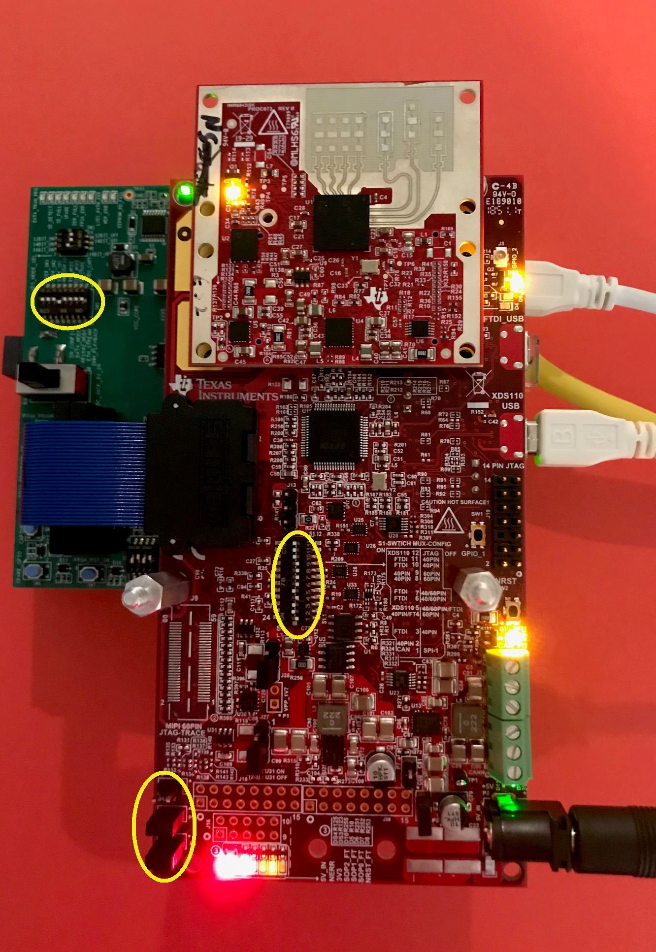

PHOTO OF BOARDS:
THE LED FOR FPGA_ERR is glowing RED.

    However, right now i have another issue at hand. I followed the guide in the DCA1000EVM quick guide and ran the lua script file for DataCaptureDemo and am stuck at or rather stays at 0% for the second downloading of the firmware for a very long time. If i were to close this window, i wouldnt be able to onnect to the board for a period of time. After trying for about 1 hour i was able to re-establish connection to the board. Is there a way to solve this?
    here is a photo attached below.

  • Hi Zigang,
    I still have a problem of getting data or ratther saving it. Here below is the log for the actions we have done. We have followed to user guide step by step already.
    GM: Constructor

    [18:21:21] [RadarAPI]: ar1.CaptureCardConfig_Mode(1, 2, 1, 2, 3, 30)
    [18:21:21] [RadarAPI]: ar1.CaptureCardConfig_PacketDelay(25)
    [18:21:21] [RadarAPI]: Sending fpga command to DCA1000
    [18:21:21]
    [18:21:21] ConnectRFDCCard_ConfigMode(): Bind failed (Config port) : 10048
    [18:21:21] Ethernet connection failed. [error -4051]
    [18:21:21] [RadarAPI]: Sending record command to DCA1000
    [18:21:21]
    [18:21:21] [RadarAPI]: ar1.GetCaptureCardFPGAVersion()
    [18:21:21] [RadarAPI]: Sending fpga_version command to DCA1000
    [18:21:21]
    [18:21:24] [RadarAPI]:
    [18:21:24]
    [18:21:24] Unable to read FPGA Version. [error -5]
    [18:21:24]
    [18:21:27] [RadarAPI]: ar1.GetCaptureCardDllVersion()
    [18:21:27] [RadarAPI]: Sending dll_version command to DCA1000
    [18:21:27] DLL Version : 1.0
    [18:21:27] [RadarAPI]: ar1.SelectCaptureDevice("DCA1000")
    [18:21:27] [RadarAPI]: Status: Passed
    [18:21:35] [RadarAPI]: ar1.CaptureCardConfig_ResetFPGA()
    [18:21:35] [RadarAPI]: ar1.CaptureCardConfig_Mode(1, 2, 1, 2, 3, 30)
    [18:21:36] [RadarAPI]: ar1.CaptureCardConfig_PacketDelay(25)
    [18:21:36] [RadarAPI]: Sending reset_fpga command to DCA1000
    [18:21:39] [RadarAPI]: ar1.CaptureCardConfig_ResetFPGA()
    [18:21:39] [RadarAPI]: ar1.CaptureCardConfig_Mode(1, 2, 1, 2, 3, 30)
    [18:21:39] [RadarAPI]: ar1.CaptureCardConfig_PacketDelay(25)
    [18:21:39] [RadarAPI]: Sending reset_fpga command to DCA1000
    [18:21:39]
    [18:21:39] ConnectRFDCCard_ConfigMode(): Bind failed (Config port) : 10048
    [18:21:39] Ethernet connection failed. [error -4051]
    [18:21:39] [RadarAPI]: Sending fpga command to DCA1000
    [18:21:39]
    [18:21:39] [RadarAPI]: Sending record command to DCA1000
    [18:21:39]
    [18:21:39] [RadarAPI]: Sending fpga_version command to DCA1000
    [18:21:40] [RadarAPI]:
    [18:21:40]
    [18:21:40] ConnectRFDCCard_ConfigMode(): Bind failed (Config port) : 10048
    [18:21:40] Ethernet connection failed. [error -4051]
    [18:21:45] [RadarAPI]: ar1.CaptureCardConfig_StartRecord("C:\\ti\\mmwave_studio_02_01_01_00\\mmWaveStudio\\PostProc\\adc_data.bin", 1)
    [18:21:45] [RadarAPI]: Sending start_record command to DCA1000
    [18:21:45]
    [18:21:45] ConnectRFDCCard_RecordMode(): Bind failed (Config port) : 10048
    [18:21:45] Ethernet connection failed. [error -4051]
    [18:21:46] [RadarAPI]:
    [18:21:46] Reset FPGA :
    [18:21:46] Timeout Error! System disconnected
    [18:21:46] [RadarAPI]: Sending fpga command to DCA1000
    [18:21:56] [RadarAPI]:
    [18:21:56] FPGA Configuration :
    [18:21:56] Timeout Error! System disconnected
    [18:21:56] [RadarAPI]: Sending record command to DCA1000
    [18:21:58] [RadarAPI]: ar1.StartFrame()
    [18:21:58] [RadarAPI]: Status: Passed
    [18:21:58] Frame start async event received!
    [18:21:58] Frame End async event received!
    [18:21:58] [RadarAPI]: Frame Ended
    [18:22:03] [RadarAPI]: ar1.StartMatlabPostProc("C:\\ti\\mmwave_studio_02_01_01_00\\mmWaveStudio\\PostProc\\adc_data.bin")
    [18:22:03] [RadarAPI]: No of files Captured: 0, Total no of frames for each device : 8
    [18:22:03] Error : The number of files captured is zero!
    [18:22:06] [RadarAPI]:
    [18:22:06] Configure Record :
    [18:22:06] Timeout Error! System disconnected
    [18:22:06] [RadarAPI]: Sending fpga_version command to DCA1000
    [18:22:16] [RadarAPI]:
    [18:22:16]
    [18:22:16] Unable to read FPGA Version. [error -5]
    [18:22:16]
    [18:22:57] [RadarAPI]: ar1.ChirpConfig(0, 0, 0, 0, 0, 0, 0, 1, 1, 1)
    [18:22:57] [RadarAPI]: Status: Passed
    [18:22:58] Test Source Already Disabled...!!!
    [18:22:58] [RadarAPI]: ar1.DisableTestSource(0)
    [18:22:59] [RadarAPI]: Status: Passed
    [18:22:59] [RadarAPI]: ar1.FrameConfig(0, 0, 8, 128, 40, 0, 0, 1)
    [18:23:00] [RadarAPI]: ar1.ProfileConfig(0, 60, 100, 6, 60, 0, 0, 0, 0, 0, 0, 29.982, 0, 256, 10000, 0, 131072, 30)
    [18:23:00] [RadarAPI]: Status: Passed
    [18:23:00] [RadarAPI]: ar1.ChirpConfig(0, 0, 0, 0, 0, 0, 0, 1, 1, 1)
    [18:23:01] Test Source Already Disabled...!!!
    [18:23:01] [RadarAPI]: ar1.DisableTestSource(0)
    [18:23:01] [RadarAPI]: Status: Passed
    [18:23:01] [RadarAPI]: ar1.FrameConfig(0, 0, 8, 128, 40, 0, 0, 1)
    [18:23:02] [RadarAPI]: Status: Passed
    [18:23:02] [RadarAPI]: ar1.CaptureCardConfig_StartRecord("C:\\ti\\mmwave_studio_02_01_01_00\\mmWaveStudio\\PostProc\\adc_data.bin", 1)
    [18:23:02] [RadarAPI]: Sending start_record command to DCA1000
    [18:23:07] [RadarAPI]: ar1.StartFrame()
    [18:23:07] [RadarAPI]: Status: Passed
    [18:23:07] Frame start async event received!
    [18:23:07] Frame End async event received!
    [18:23:07] [RadarAPI]: Frame Ended
    [18:23:12] [RadarAPI]:
    [18:23:12] Start Record :
    [18:23:12] Timeout Error! System disconnected
    [18:23:13] [RadarAPI]: ar1.StartMatlabPostProc("C:\\ti\\mmwave_studio_02_01_01_00\\mmWaveStudio\\PostProc\\adc_data.bin")
    [18:23:13] [RadarAPI]: No of files Captured: 0, Total no of frames for each device : 8
    [18:23:13] Error : The number of files captured is zero!
    [18:23:15] [RadarAPI]: ar1.StartMatlabPostProc("C:\\ti\\mmwave_studio_02_01_01_00\\mmWaveStudio\\PostProc\\adc_data.bin")
    [18:23:15] [RadarAPI]: No of files Captured: 0, Total no of frames for each device : 8
    [18:23:15] Error : The number of files captured is zero!
  • HI,
    It looks like that you have a problem configure the DCA1000 board.  Please check the DCA1000 debug handbook for this issue.
    e2e.ti.com/.../872161
    Zigang
  • Hi Zigang,
    Here is another log file that we got that has no ethernet issues. However, we also still have the issue of saving the bin file onto out PC.

  • Hi, Joel:
    Can you make sure the switch setting on DCA1000 matches with the following figure? and you are disable firewalls and other network like wifi.
    Zigang
  • Hi Zigang,
    We have tried the configuration you have provided above. However, we were not able to get an output. Rather the number of files captured remained 0.
    Here is the log file for the try.

    [14:08:42] [RadarAPI]:
    [14:08:42] Start Record command : Success
    [14:08:42]
    [14:08:42] LVDS buffer full
    [14:08:42]
    [14:08:42] Record Process :
    [14:08:42] Timeout Error! System disconnected
    [14:08:42]
    [14:08:42] Record stop is done successfully
    [14:08:42] [RadarAPI]: ar1.StartMatlabPostProc("C:\\ti\\mmwave_studio_02_01_01_00\\mmWaveStudio\\PostProc\\adc_data.bin")
    [14:08:42] [RadarAPI]: No of files Captured: 0, Total no of frames for each device : 8
    [14:08:42] Error : The number of files captured is zero!
    [14:08:46] [RadarAPI]: ar1.StartMatlabPostProc("C:\\ti\\mmwave_studio_02_01_01_00\\mmWaveStudio\\PostProc\\adc_data.bin")
    [14:08:46] [RadarAPI]: No of files Captured: 0, Total no of frames for each device : 8
    [14:08:46] Error : The number of files captured is zero!
    We got the same results as the previous few tries.
    Here is a picture of he board now. The LED on the DCA1000EVM says data is transferring but it stays there for a long time and doesnt save anything too.
    also, mmwave studio tells us otherwise that no files are captured. If we were to process the data post testing, mmwave studio would hang and crash.
  • Hi Zigang,
    here are photos attached for documentation of my steps i took to make the radar work. I am using IWR6843ISK REV D.
    Thank You.
    Joel
    I have noticed that the light on your DCA1000 board is not normal.   Is it like that when you power it on, the very left two green lights are green?
    Zigang
  • Hi ZIgang,
    The LED lgiht indicating 'DATA_TRANS_PROG_LED1' lights up only after we capture the data via mmwave studio. The second LED light indicating 'SD_DETECT' lights up because we have inserted a SD card in the DCA1000EVM board.
    However, the issue is that the first LED light indicating 'DATA_TRANS_PROG_LED1' stays lit for a very long period of time, but in the end we are not able to save any RAW data file (.bin) at all. The LED light for 'FPGA_ERR' lights up too indicating that our internal FPGA buffer is full.
    right now, after we removed the SD card from the board, the LED light for 'SD_DETECT' does not light up anymore upon power on.
    thank you.
    Joel
  • HI Zigang,
    We tried again without the SD card and here are some things attached below to show our connection and output received.
    Here is the output we got in mmwave studio:

    [09:49:15] [RadarAPI]: Status: Passed
    [09:49:15] [RadarAPI]: ar1.SOPControl(2)
    [09:49:23] [RadarAPI]: ar1.CaptureCardConfig_EthInit("192.168.33.30", "192.168.33.180", "12:34:56:78:90:12", 4096, 4098)
    [09:49:23] [RadarAPI]: ar1.CaptureCardConfig_Mode(1, 0, 1, 2, 3, 30)
    [09:49:23] [RadarAPI]: ar1.CaptureCardConfig_PacketDelay(50)
    [09:49:24] [RadarAPI]: Sending fpga command to DCA1000
    [09:49:24] Invalid lvdsMode value (0). [error -4016]
    [09:49:24] [RadarAPI]: Sending record command to DCA1000
    [09:49:24] Configure Record command : Success
    [09:49:24] [RadarAPI]: ar1.GetCaptureCardFPGAVersion()
    [09:49:24] [RadarAPI]: Sending fpga_version command to DCA1000

    [09:53:08] [RadarAPI]: ar1.DataPathConfig(513, 1216644097, 0)
    [09:53:08] [RadarAPI]: Status: Passed
    [09:53:11] [RadarAPI]: ar1.LvdsClkConfig(1, 1)
    [09:53:11] [RadarAPI]: Status: Passed
    [09:53:13] [RadarAPI]: ar1.LVDSLaneConfig(0, 1, 1, 0, 0, 1, 0, 0)
    [09:53:13] [RadarAPI]: Status: Passed

    [09:53:52] [RadarAPI]: ar1.CaptureCardConfig_StartRecord("C:\\ti\\mmwave_studio_02_01_01_00\\mmWaveStudio\\PostProc\\adc_data.bin", 1)
    [09:53:52] [RadarAPI]: Sending start_record command to DCA1000
    [09:54:01] [RadarAPI]: ar1.StartFrame()
    [09:54:01] [RadarAPI]: Status: Passed
    [09:54:01] Frame start async event received!
    [09:54:01] [RadarAPI]: Frame Ended
    [09:54:22] [RadarAPI]:
    [09:54:22] Start Record command : Success
    [09:54:22]
    [09:54:22] No LVDS data
    [09:54:22]
    [09:54:22] Record stop is done successfully
    [09:54:22] [RadarAPI]: ar1.StopFrame()
  • So, there is still no data being captured?
    Could you try the lua script after reset and connection?   The lua script is located at:
    C:\ti\mmwave_studio_02_01_01_00\mmWaveStudio\Scripts\DataCaptureDemo_xWR.lua
    Zigang
  • hi Zigang,
    yes, no data has been captured.
    I have tried the lua script after reseting and reconnection. Here is he connection and ouput/
    Output from mmwave studio:

    [13:34:58] GM: Loaded 'C:\ti\mmwave_studio_02_01_01_00\mmWaveStudio\Clients\\LabClient.dll'
    [13:34:58] GM: 1 Guest (s) init
    [13:34:58] GM: 1 Module(s) init
    [13:34:58] GM: 2 Tab (s) init
    [13:34:58] RSTD.Client_LoadXml()
    [13:34:58] [RadarAPI]: ar1.selectRadarMode(0)
    [13:34:58] [RadarAPI]: Status: Passed
    [13:34:58] Matlab Runtime Engine is installed
    [13:34:58] [RadarAPI]: Starting Matlab Engine..
    [13:35:02] [RadarAPI]: Matlab Engine Started!
    [13:35:04] [RadarAPI]: ar1.selectCascadeMode(0)
    [13:35:04] [RadarAPI]: Status: Passed
    [13:35:04] [RadarAPI]: ar1.LoadSettings('C:\Users\JoshuaYoong\AppData\Roaming\RSTD\ar1gui.ini')
    [13:35:04] TESTING = false
    [13:35:04] RstdNet: Port 2777: Listening..
    [13:35:04]
    [13:35:04] ***Script completed successfully.***
    [13:35:10] [RadarAPI]: Opening Gpio Control Port()
    [13:35:10] [RadarAPI]: Status: Passed
    [13:35:11] [RadarAPI]: Opening Board Control Port()
    [13:35:11] [RadarAPI]: Status: Passed
    [13:35:12] [RadarAPI]: ar1.FullReset()
    [13:35:12] [RadarAPI]: Status: Passed
    [13:35:12] [RadarAPI]: Closing Board Control Port()
    [13:35:12] [RadarAPI]: Closing Gpio Control Port()
    [13:35:12] [RadarAPI]: ar1.SOPControl(2)
    [13:35:15] [RadarAPI]: ar1.frequencyBandSelection("60G")
    [13:35:16] [RadarAPI]: ar1.SelectChipVersion("IWR6843")
    [13:35:16] [RadarAPI]: Status: Passed
    [13:35:16] [RadarAPI]: ar1.deviceVariantSelection("IWR6843")
    [13:35:25] [RadarAPI]: ar1.Connect(5,921600,1000)
    [13:35:28] [RadarAPI]: Warning: Connected with baudrate 115200
    [13:35:29] [RadarAPI]: Warning: Disconnected existing BaudRate
    [13:35:29] [RadarAPI]: Warning: Trying to connect with baudrate 921600
    [13:35:30] [RadarAPI]: ar1.Calling_IsConnected()
    [13:35:32] [RadarAPI]: ar1.SelectChipVersion("IWR6843")
    [13:35:32] [RadarAPI]: Status: Passed
    [13:35:32] Device Status : IWR6843/QM/SOP:2/ES:2
    [13:35:32] [RadarAPI]: ar1.SaveSettings('C:\Users\JoshuaYoong\AppData\Roaming\RSTD\ar1gui.ini')
    [13:36:09] [RadarAPI]: ar1.ReadRegister(0xffffe214, 0, 31)
    [13:36:09] [RadarAPI]: ar1.ReadRegister(0xffffe210, 0, 31)
    [13:36:09] [RadarAPI]: ar1.frequencyBandSelection("60G")
    [13:36:09] [RadarAPI]: ar1.ReadRegister(0xffffe218, 0, 31)
    [13:36:09] [RadarAPI]: ar1.DownloadBSSFw("C:\\ti\\mmwave_studio_02_01_01_00\\mmWaveStudio\\Scripts\\..\\..\\rf_eval_firmware\\radarss\\xwr68xx_radarss.bin")
    [13:36:10] [RadarAPI]: Downloading BSS ROM RPRC Binary..
    [13:36:17] [RadarAPI]: ar1.GetBSSFwVersion()
    [13:36:17] [RadarAPI]: BSSFwVersion:(06.02.01.05 (09/03/20))
    [13:36:17] BSS FW Download Success
    [13:36:17] [RadarAPI]: ar1.DownloadMSSFw("C:\\ti\\mmwave_studio_02_01_01_00\\mmWaveStudio\\Scripts\\..\\..\\rf_eval_firmware\\masterss\\xwr68xx_masterss.bin")
    [13:36:17] [RadarAPI]: Downloading MSS RPRC Binary..
    [13:36:20] [RadarAPI]: ar1.GetMSSFwVersion()
    [13:36:20] [RadarAPI]: MSSFwVersion:(02.00.00.03 (27/08/19))
    [13:36:20] MSS FW Download Success
    [13:36:21] [RadarAPI]: ar1.PowerOn(0, 1000, 0, 0)
    [13:36:21] [RadarAPI]: Status: Passed
    [13:36:21] MSS power up done async event received!
    [13:36:21] Power On Success
    [13:36:22] [RadarAPI]: ar1.SelectChipVersion("IWR6843")
    [13:36:22] [RadarAPI]: Status: Passed
    [13:36:22] Device Status : IWR6843/QM/SOP:2/ES:2
    [13:36:22] [RadarAPI]: ar1.RfEnable()
    [13:36:22] BSS power up done async event received!
    [13:36:22] [RadarAPI]: ar1.GetMSSFwVersion()
    [13:36:22] [RadarAPI]: MSSFwVersion:(02.00.00.03 (27/08/19))
    [13:36:23] [RadarAPI]: ar1.GetBSSFwVersion()
    [13:36:23] [RadarAPI]: BSSFwVersion:(06.02.01.05 (09/03/20))
    [13:36:23] RF Enable Success
    [13:36:23] [RadarAPI]: ar1.ChanNAdcConfig(1, 1, 0, 1, 1, 1, 1, 2, 1, 0)
    [13:36:23] [RadarAPI]: Status: Passed
    [13:36:23] ChanNAdcConfig Success
    [13:36:23] [RadarAPI]: ar1.LPModConfig(0, 0)
    [13:36:24] Regualar mode Cfg Success
    [13:36:24] [RadarAPI]: ar1.RfInit()
    [13:36:24] RF Init async event received!
    [13:36:24] [RadarAPI]: Time stamp, Temperture: 1590,33; APLL Status, Update: 1, 0; SynthVCO1 Status, Update: 1, 1; SynthVCO2 Status, Update: 1, 1; LODist Status, Update: 1, 1; RxADCDC Status, Update: 1, 1; HPFcutoff Status, Update: 1, 1; LPFcutoff Status, Update: 1, 1; PeakDetector Status, Update: 1, 1; TxPower Status, Update: 1, 1; RxGain Status, Update: 1, 1; TxPhase Status, Update: 1, 1; RxIQMM Status, Update: 1, 1;
    [13:36:24] [RadarAPI]: Status: Passed
    [13:36:24] RfInit Success
    [13:36:25] [RadarAPI]: ar1.DataPathConfig(1, 1, 0)
    [13:36:25] [RadarAPI]: Status: Passed
    [13:36:25] DataPathConfig Success
    [13:36:25] [RadarAPI]: ar1.LvdsClkConfig(1, 1)
    [13:36:25] LvdsClkConfig Success
    [13:36:25] [RadarAPI]: ar1.LVDSLaneConfig(0, 1, 1, 0, 0, 1, 0, 0)
    [13:36:25] LVDSLaneConfig Success
    [13:36:25] [RadarAPI]: ar1.SetTestSource(4, 3, 0, 0, 0, 0, -327, 0, -327, 327, 327, 327, -2.5, 327, 327, 0, 0, 0, 0, -327, 0, -327, 327, 327, 327, -95, 0, 0, 0.5, 0, 1, 0, 1.5, 0, 0, 0, 0, 0, 0, 0)
    [13:36:25] Test Source Configuration Success
    [13:36:25] [RadarAPI]: ar1.ProfileConfig(0, 60.25, 100, 6, 60, 0, 0, 0, 0, 0, 0, 29.982, 0, 256, 10000, 0, 131072, 30)
    [13:36:26] ProfileConfig Success
    [13:36:26] [RadarAPI]: ar1.ChirpConfig(0, 0, 0, 0, 0, 0, 0, 1, 1, 0)
    [13:36:26] [RadarAPI]: Status: Passed
    [13:36:26] ChirpConfig Success
    [13:36:26] [RadarAPI]: ar1.EnableTestSource(1)
    [13:36:26] Enabling Test Source Success
    [13:36:26] Test Source Already Enabled...!!!
    [13:36:26] [RadarAPI]: ar1.FrameConfig(0, 0, 8, 128, 40, 0, 0, 1)
    [13:36:26] FrameConfig Success
    [13:36:26] [RadarAPI]: ar1.SelectCaptureDevice("DCA1000")
    [13:36:26] SelectCaptureDevice Success
    [13:36:26] [RadarAPI]: ar1.CaptureCardConfig_EthInit("192.168.33.30", "192.168.33.180", "c:22:38:4e:5a:c", 4096, 4098)
    [13:36:26] [RadarAPI]: Sending fpga command to DCA1000
    [13:36:26] FPGA Configuration command : Success
    [13:36:26] [RadarAPI]: Sending fpga_version command to DCA1000
    [13:36:27] [RadarAPI]:
    [13:36:27]
    [13:36:27] FPGA Version : 2.8 [Record]
    [13:36:27]
    [13:36:27] CaptureCardConfig_EthInit Success
    [13:36:27] [RadarAPI]: ar1.CaptureCardConfig_Mode(1, 2, 1, 2, 3, 0)
    [13:36:27] [RadarAPI]: Sending fpga command to DCA1000
    [13:36:27] FPGA Configuration command : Success
    [13:36:27] CaptureCardConfig_Mode Success
    [13:36:27] [RadarAPI]: ar1.CaptureCardConfig_PacketDelay(25)
    [13:36:27] [RadarAPI]: Sending record command to DCA1000
    [13:36:27] Configure Record command : Success
    [13:36:27] CaptureCardConfig_PacketDelay Success
    [13:36:27] [RadarAPI]: ar1.CaptureCardConfig_StartRecord("C:\\ti\\mmwave_studio_02_01_01_00\\mmWaveStudio\\Scripts\\..\\PostProc\\adc_data.bin", 1)
    [13:36:27] [RadarAPI]: Sending start_record command to DCA1000
    [13:36:27] [RadarAPI]: Status: Passed
    [13:36:28] [RadarAPI]: ar1.StartFrame()
    [13:36:28] [RadarAPI]: Status: Passed
    [13:36:28] Frame start async event received!
    [13:36:28] [RadarAPI]: Frame Ended
    [13:36:28] Frame End async event received!
    [13:36:33] Please wait for a few seconds for matlab post processing .....!!!!
    [13:36:33] [RadarAPI]: ar1.StartMatlabPostProc("C:\\ti\\mmwave_studio_02_01_01_00\\mmWaveStudio\\Scripts\\..\\PostProc\\adc_data.bin")
    [13:36:33] [RadarAPI]: No of files Captured: 0, Total no of frames for each device : 8
    [13:36:33] Error : The number of files captured is zero!
    in the end, no data has been captured too. This time LVDS buffer is not full as LED did not light up.

    Please look through the capture issue at DCA1000 debug handbook.
    In addition, please correct the switch setting on the DCA1000 board as the one below.
    Zigang
  • Hi Zigang,
    We have been continuously tesing and still have no output on saving the raw data file onto our PC. We have configured many different configurations on the DCA1000EVM but still to no avail.
    However, we realized that the board DCA1000EVM is heating up abnormally at around 85 degree celsius. We are guessing that the board DCA1000EVM might not be functioning properly.
    Could you please send us another evaluation DCA1000EVM board for us to continue testing?
