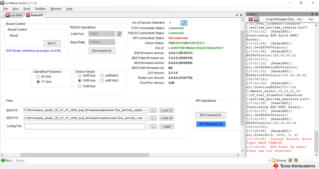

DCA1000EVM: Cannot load proper BSS, MSS.
Part Number: DCA1000EVM
The following error occurs.

[14:58:40]  [RadarAPI]: ar1.selectRadarMode(0)
[14:58:40]  [RadarAPI]: Status: Passed
[14:58:40]  Matlab Runtime Engine is installed
[14:58:40]  [RadarAPI]: Starting Matlab Engine..
[14:58:52]  [RadarAPI]: Matlab Engine Started!
[14:58:54]  [RadarAPI]: ar1.selectCascadeMode(0)
[14:58:54]  [RadarAPI]: Status: Passed
[14:58:54]  [RadarAPI]: ar1.LoadSettings('C:\Users\User\AppData\Roaming\RSTD\ar1gui.ini')
[14:58:54]  TESTING = false
[14:58:54]  RstdNet: Port 2777: Listening..
[14:58:54]
[14:58:54]  ***Script completed successfully.***
[14:59:12]  [RadarAPI]: Opening Gpio Control Port()
[14:59:12]  [RadarAPI]: Status: Passed
[14:59:12]  [RadarAPI]: Opening Board Control Port()
[14:59:13]  [RadarAPI]: ar1.FullReset()
[14:59:13]  [RadarAPI]: Status: Passed
[14:59:14]  [RadarAPI]: Closing Board Control Port()
[14:59:14]  [RadarAPI]: Status: Passed
[14:59:14]  [RadarAPI]: Closing Gpio Control Port()

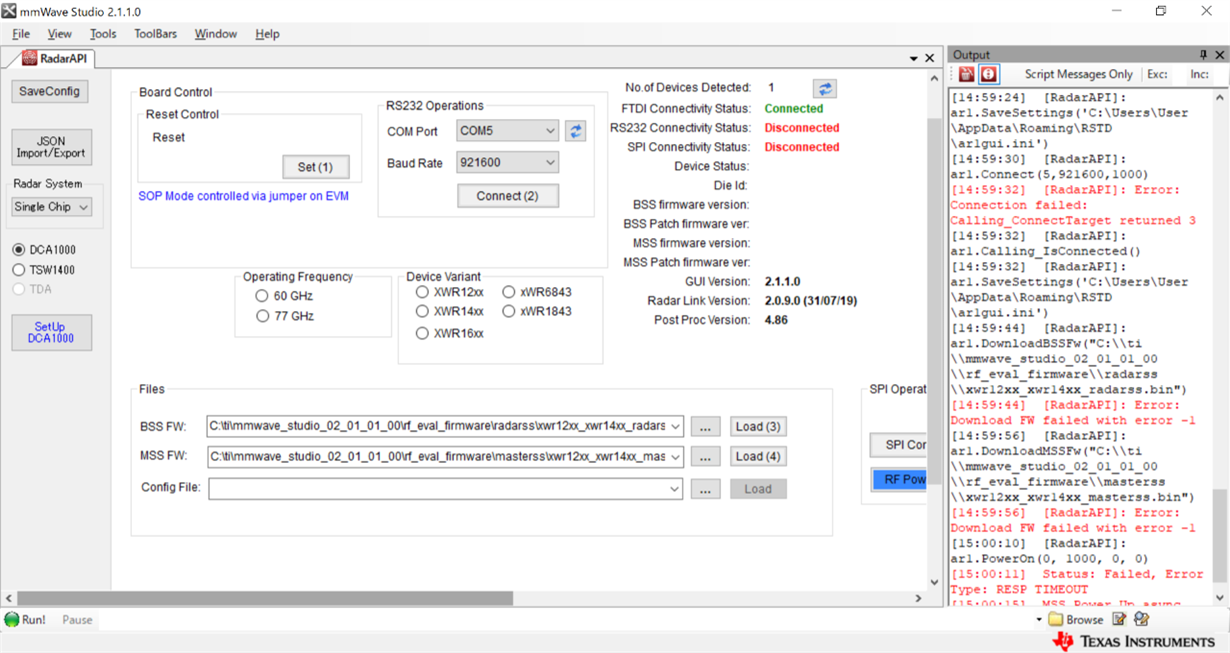

[14:59:14]  [RadarAPI]: ar1.SOPControl(2)
[14:59:22]  [RadarAPI]: ar1.Connect(5,115200,1000)
[14:59:24]  [RadarAPI]: Error: Connection failed: Calling_ConnectTarget returned 3
[14:59:24]  [RadarAPI]: ar1.Calling_IsConnected()
[14:59:24]  [RadarAPI]: ar1.SaveSettings('C:\Users\User\AppData\Roaming\RSTD\ar1gui.ini')
[14:59:30]  [RadarAPI]: ar1.Connect(5,921600,1000)
[14:59:32]  [RadarAPI]: Error: Connection failed: Calling_ConnectTarget returned 3
[14:59:32]  [RadarAPI]: ar1.Calling_IsConnected()
[14:59:32]  [RadarAPI]: ar1.SaveSettings('C:\Users\User\AppData\Roaming\RSTD\ar1gui.ini')
[14:59:44]  [RadarAPI]: ar1.DownloadBSSFw("C:\\ti\\mmwave_studio_02_01_01_00\\rf_eval_firmware\\radarss\\xwr12xx_xwr14xx_radarss.bin")
[14:59:44]  [RadarAPI]: Error: Download FW failed with error -1
[14:59:56]  [RadarAPI]: ar1.DownloadMSSFw("C:\\ti\\mmwave_studio_02_01_01_00\\rf_eval_firmware\\masterss\\xwr12xx_xwr14xx_masterss.bin")
[14:59:56]  [RadarAPI]: Error: Download FW failed with error -1
[15:00:10]  [RadarAPI]: ar1.PowerOn(0, 1000, 0, 0)
[15:00:11]  Status: Failed, Error Type: RESP TIMEOUT
[15:00:15]  MSS Power Up async event was not received!
I am experimenting with this as a reference.
Software used:
mmwave_sdk_03_04_00_03
