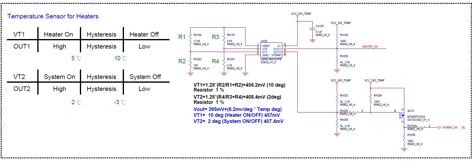

Hi Sir,
may we learn from you,is this IC high active at low temperature? whether the voltage resistance in the below circuit meet the require -40~ -3 deg and OUT-1 output is high?
and -3 deg or more to start the power supply(OUT-2 output), turn off OUT-1 at 10 deg.
  • Hi Tommy,
    LM56 can only sink 50uA to ground on its OUT pins. See Digital Outputs section, IOUT = 50uA under conditions. RH203 must be at least 66kohm when used with a 3.3V supply.
    LM56's VREF output is only specified to source 50uA. See VREF Output section, Load Regulation Sourcing. Your resistor network draws 169uA. Your resistors need to be increased 3-4 times to reduce the current load on VREF.
