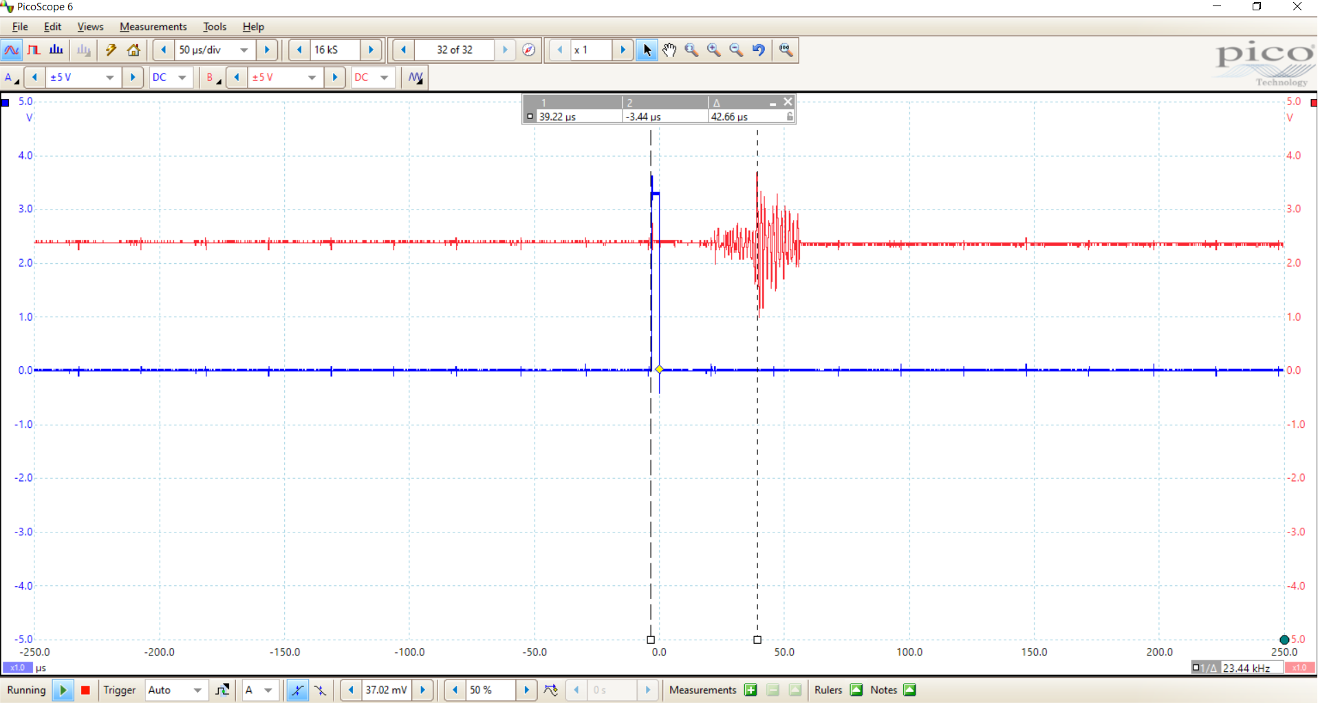

However, when the transducer is in air, there was a reading of ~42us on the graph when it was expected to be 0? The oscilloscope shows the same:

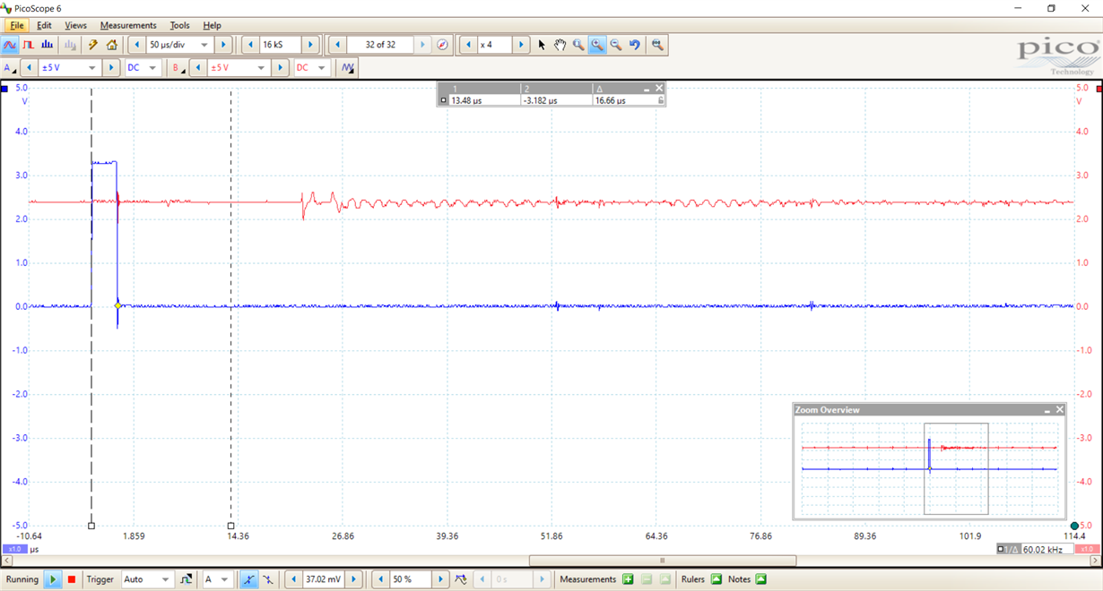

However, when placed in container of water, there was no signal and the graph stops updating values until the transducer was removed from the water. The oscilloscope reflected the same:
I was expecting a ~33us signal across the 5cm container but the only signal I saw was the ringing(?) at ~20us. What could be the cause of this issue?

    I am using a 2-channel PicoScope so the scope shots will only indicate the START and COMPIN signals. The only settings changed in the GUI from default was TX_FREQ_DIV = "Divide by 8" , NUM_TX = "8 Pulses" and PGA_GAIN = "21dB".
    For the shot in air, the graph in the GUI updates at a value of ~42us which I've also marked with a dotted line in the scope.
    For the shots in water, the transducer placed on the tank wall (expected 33us) and in the middle of the tank (expected 15us) but both scopes showed the same reading.

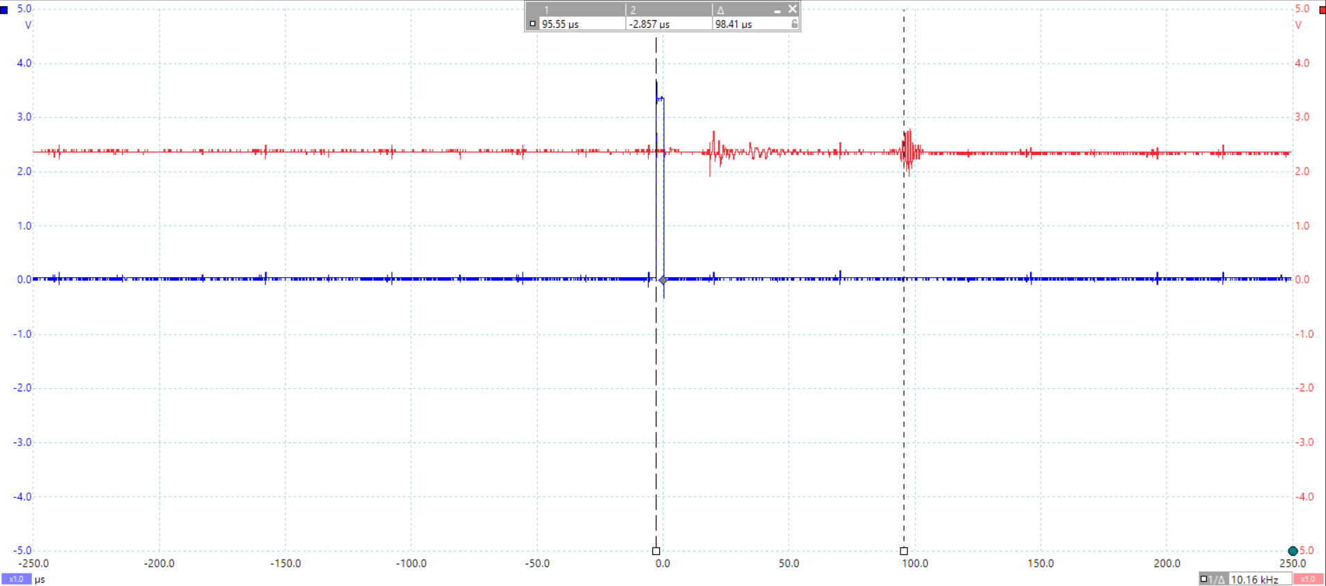

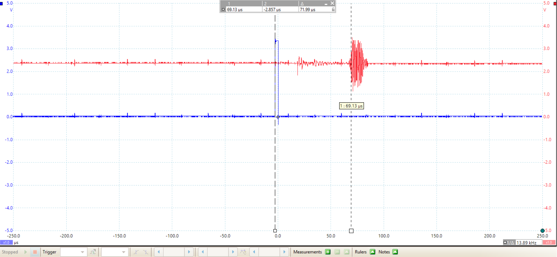

    Using a 1MHz Steminc transducer I replicated your results for the test in air with and without silicone, and your test in water with silicone. Similarly, I could not get a clean signal from the COMPIN pin in these scenarios, but I saw normal operation and a clean signal after gluing the transducer to my acrylic water tank as done in snaa266a.
    Transducer held in water:
    Transducer glued to the outer tank wall:

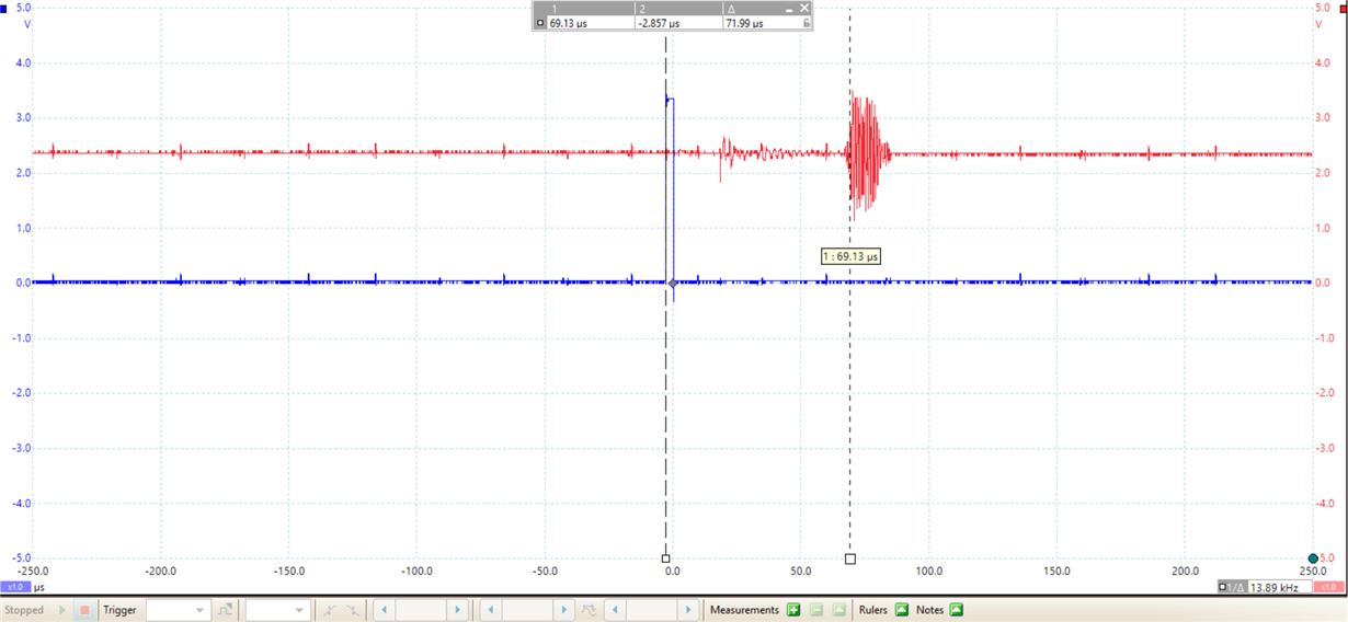

    I have tried of several other silicone sealed transducers (2.2MHz, 1.2 MHz, 665kHz, 480kHz) as well as adjusting the settings in the TDC1000-C2000 GUI to try and obtain a signal without gluing it onto the container.
    I was able to obtain correct oscilloscope images using the 480kHz piezo and with an update frequency of 100ms in water:
    5cm
    8cm
    Could you provide some insight as to why this particular setup worked? I have listed some observations about this below
    1) Trigger update frequency varied from 100ms-1.0sec. Only 100ms gave proper oscilloscope image.
    2) 2.2 MHz, 1.2 MHz, 1 MHz, 665 kHz piezos were not affected by adjusting update frequency
    3) TX_Freq_Div at 2/4/8 gave good signals (best at 8) but signal disappeared at 16/32. Theoretically, I would've expected best signal at 16 since freq = 8mhz/16 = 500khz to be closer to resonance
