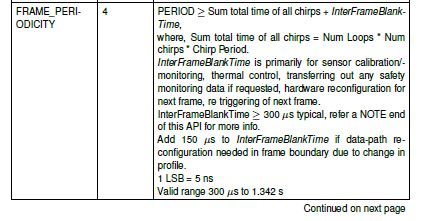

    The maximum number of chirps is not determined by the number of chirps but by the Frame Duration (FRAME_PERIODICITY) which is
    Following is a snapshot from the Radar Interface Control Document provided in
    C:\ti\mmwave_dfp_02_01_05_03\docs\mmWave-Radar-Interface-Control.pdf

  • Hi
    Here it is
  • Hi Cesar-san,
    Thanks. I understood the period can control within 300us ~ 1.342s
