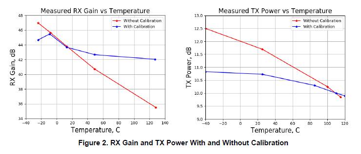

I have few questions for the calibration function of IWR1443.
Q1. The RX gain
RX Gain control for temperature variation described at section 5.5.13 Sub block 0x010C – AWR_RX_GAIN_TEMPLUT_SET_SB In the attached document AWR1xxx Radar Interface Control Document
Based on the description,
Is it OK to recognize that there is a variation of min-14dB(=-6-8) to max28dB(= 28-0)?
Q2. The TX gain
TX Gain control for temperature variation described at section 5.5.14 Sub block 0x010D – AWR_TX_GAIN_TEMPLUT_SET_SB In the attached document AWR1xxx Radar Interface Control Document
STG_CODE is defined Higher values for higher gain.
What are the values for min and max for TX gain?
As shown in Figure 2 of the attached document "Self-Calibration in TI’s mmWave Radar Devices"
Q3. RX Gain and TX Power With Calibration
Do you have the actual values that can be suppressed (RX +/- 1.9 dB, TX +/- 1.0 dB in Figure 2) when adjusting the temperature compensation for RX gain and TX and power as shown in Figure 2 of the attached Self-Calibration in TI’s mmWave Radar Devices?
Or is there a guaranteed value for the amount of change that can be suppressed?
    The RX gain steps has a total dynamic range of ~43dB. It is uncalibrated and the Set Rx gain temp lut API is not supported
    There is a typical dynamic range of 37.8dB. This is also uncalibrated and Set Tx gain temp lut API is not supported.
    • Rx gain: -2.5dB to 4dB wrt the value at room temperature
    • Tx output power: -2 to +2dB wrt the value at room temperature

  • Kuerbis said:
    Q1, The API is currently not supported on IWR1443. Does it means that IWR1443 has a feature and it could be configured, but not guaranteed to work? Or doesn't have the capability itself?
    it means modifying the value is not recommended and will nullify the self calibration, the LUT is uncalibrated and don't have fixed steps
    Kuerbis said:
    Q2. Do you have any device which the API is supported?
    No, this is not supported across devices
    Kuerbis said:
    Q3. Regarding to Self-Calibration, We want to know whether the value provided below could be considered as the guarantee value (that is, it falls within this value) for IWR1443 and other..
    No it is not. The error numbers are based on lab characterization on few parts across temperature and split corners. also the +/-2dB Tx power accuracy is true only for 0dB BO case. For non-0 BO cases, it is +/- 3dB.
    Charles O
