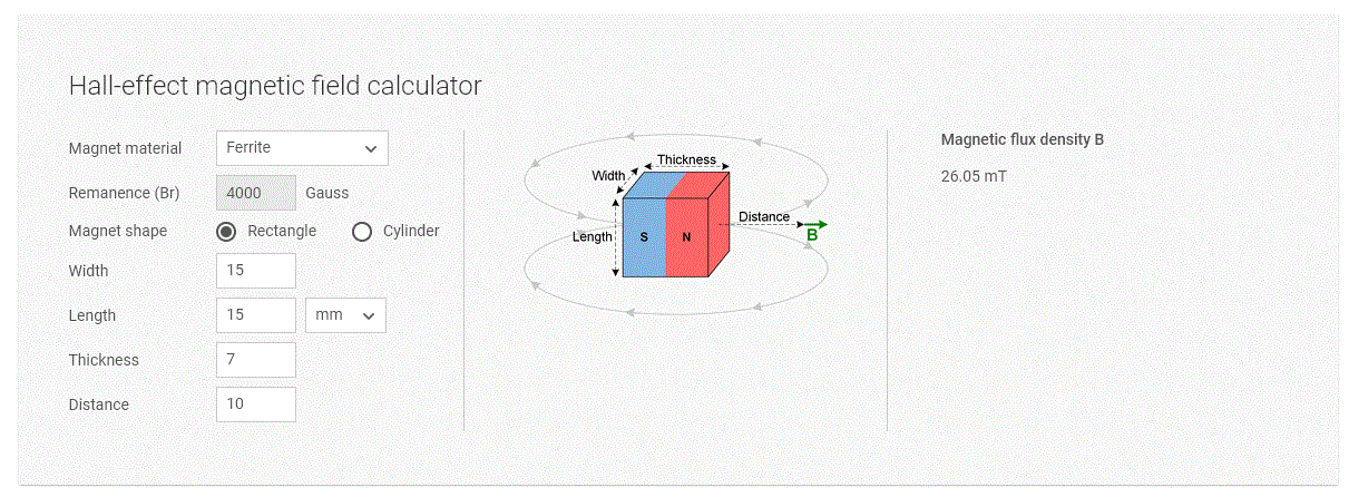

Would you have a calculation formula we could use to get magnet distance change vs back cover opening measured at the bottom of the product? (Hall + magnet, for outdoor use), Thank you!
Best Regards!
N45 D8*4 magnetism: 4020-4170GS;
N45 D8*3 magnetism: 3390-3520GS;
N50 D8*3 magnetism: 3420-3540GS
Note: Delta V= abs(open-close)
Hall sensor:DRV5053RAQDBZR -45mV/mT Output voltage: 0.2~1.8V; B=0mT , OUT =1 V
Magnet : N45 NdFeB ;D8 x 3 mm R200-02162 PCB board New mockup back cover
closed
open 1mm
open 4mm
open 10mm
open oo
unit

Hi Eric,
closed
open 1mm
open 4mm
open 10mm
open oo
unit
