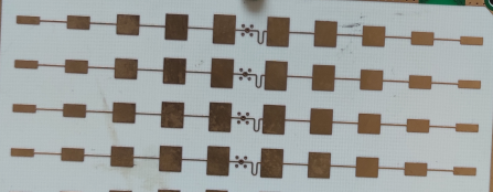

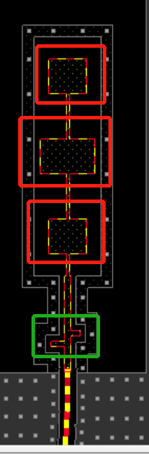

We want to decrease FOV of elevation.
1.But I do not kown should we redesign the branches in green block as below.
What is the function of the branches?
2.We want to decrease  FOV of elevation through add patches form three to five or seven?
   We want to control FOV of elevation from 50 degree to 25 degree,
But we do not konw how to design the patch size of we added.
Can you answer our questions?
