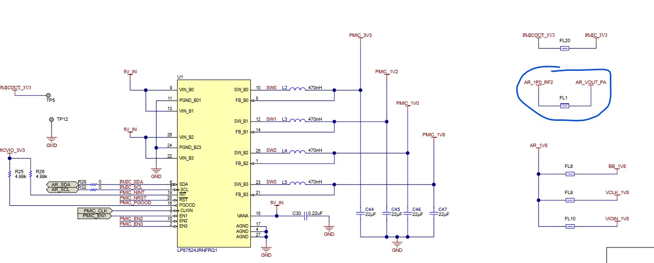

On the IWR6843AOPEVM the VIN_RFx is 1.0V and the Vout_PA voltage is shorted to the VIN_RF2 via ferrite bead.
So according to documentation and also in my opinion, the LDO bypass option should be enabled and the PA LDO input should be disabled, i.e. rlRfLdoBypassCfg_t.ldoBypassEnable set to 3. That is bit 0 set to 1 such that the RF LDO bypass is enabled (to be set when 1.0V RF supply is provided) and bit 1 set to 1 (PA LDO input disabled, to be used when VIN_RF is shorted to VOUT_PA) - (see definition and comments of rlRfLdoBypassCfg in mmwave_sdk_xx\packages\ti\control\mmwavelink\include\rl_sensor.h) defined here:

Now, in all code examples provided, including the out of box demo to be used with the IWR6843AOPEVM (mmwave_sdk_xxx\packages\ti\demo\xwr68xx\mmw\ and mmwave_industrial_toolbox_yyy\labs) usually in the mss_main.c file there is a section:
rlRfLdoBypassCfg_t gRFLdoBypassCfg =
    .ldoBypassEnable   = 0, /* 1.0V RF supply 1 and 1.0V RF supply 2 */
    .supplyMonIrDrop   = 0, /* IR drop of 3% */
    .ioSupplyIndicator = 0, /* 3.3 V IO supply */
Now the comments on this seem to be wrong:
- supplyMonIrDrop = 0 would mean monitor is allowing 0% of IR drop, contrary to the comment which states 3%
- ldoBypassEnable = 0 would mean rf ldo is not bypassed and pa ldo is enabled, contrary to the code comment and contrary to the hardware schematic of the board to run the code on (IWR6843AOPEVM)

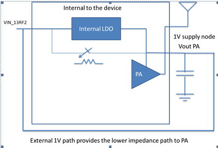

     Below is the scheme for the internal LDO.
    On the EVM hardware we AR_1P0_RF2 shorted to AR_VOUT_PA, Hence PA power is supplied through external supply irrespective of LDO is bypassed or not in 1V mode. Hence it's working on all the demo codes.
    If the design is such that 1.3V is fed then this below short should be removed and internal LDO must be enabled to get 1V supply on the PA.

    The Eval boards have a 1.0V output and not 1.3V

    I confirmed with our device team and your values for ldoBypass and supplyMonIrdrop are correct for the xWR6843AOP EVM.
        .ldoBypassEnable   = 3, /* 1.0V RF supply 1 and 1.0V RF supply 2 */
        .supplyMonIrDrop   = 1, /* IR drop of 3% */
    The SDK code has kept it at default with the bypass disabled and PA LDO enabled and the documentation mentions to refer to the EVM user guide in case any changes are needed. However, there is scope for improvement in that the SDK example should select appropriate configuration for the underlying TI EVM that it is running on. Thanks for bringing this to our notice. We will take this feedback to improve the SDK examples.
