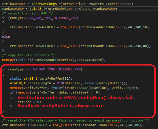

We are working on immigrating RX antenna DBF algorithm onto AWR1843's HWA, which simply performs an element-wise complex multiplication over DFFT output and DBF twiddle factor vector (corresponding to RX antenna spacing).
I wrote a test function which generates test pattern on L3 and then copy it to HWA memory using EDMA, and then fill the HWA internal memory using HWA_configRam(), and finally start HWA and wait until complete.
Config code:
Process code:
But the HWA output is always zero if HWA complexMultiply.mode is set to HWA_COMPLEX_MULTIPLY_MODE_VECTOR_MULT,
while if complexMultiply.mode is set to HWA_COMPLEX_MULTIPLY_MODE_MAG_SQUARED, the output meets my expectation.
The main difference is that Magnitude squared mode does not use the HWA internal memory.
So I checked the configRam and added the code below to make sure that writing to the HWA internal RAM is successful, but the memcmp always fails as the verifyBuffer is always zero, it seems I simply failed to write my twiddle factor vector into the HWA internal memory even though I toggled the 24th bit of HWACCREG7.
My question is:
0. What is the correct programming sequence to start a FFT HWA param with CMULT pre-processing? A demo would be very nice.
1. What is the data width of HWA internal memory which holds CMULT complex vectors? I am assuming a 32*2bit complex vector with lower 21bit valid for both image and real part.
2. Is there a way to validate successful writing to the HWA internal memory? (over JTAG debug? or CPU readback?)

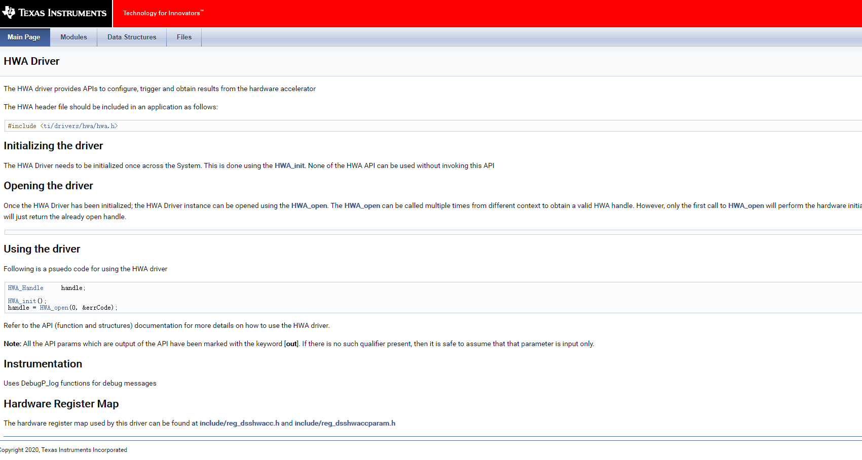

  • Hello Chen,
    Please refer to the existing document from mmwave sdk
    file:///C:/ti/mmwave_sdk_03_05_00_01/packages/ti/drivers/hwa/docs/doxygen/html/index.html

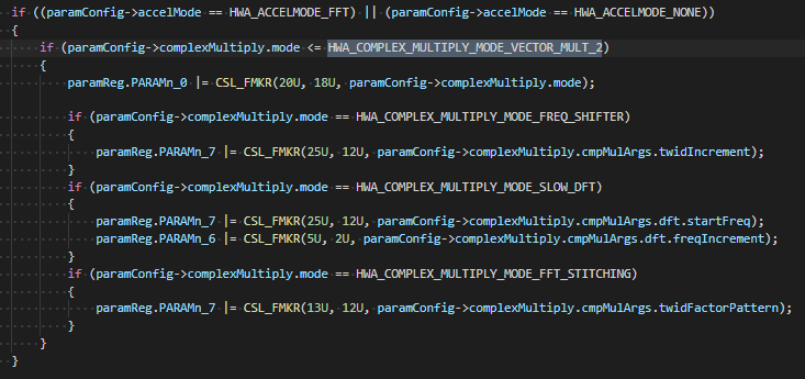

    And I see reference within hwa.c for HWA_COMPLEX_MULTIPLY_MODE_VECTOR_MULT_2
    https://training.ti.com/sites/default/files/docs/HWA_in_mmWave_sensor_1443.pdf
    Jitendra
  • Hi Jitendra,
    I have SDK 03.05.00.04 installed on my computer.
    My ti/drivers/hwa/docs/doxygen/html/index.html looks like a API documentation and does not explain how CMULT works:
    My hwa.c does contains reference to HWA_COMPLEX_MULTIPLY_MODE_VECTOR_MULT_2, but it's simply used as a boundary checking criteria ...
    Looking forward to more pratical advices, or could you kindly help me analyze what conditions are possbile of I've got all-zeros only in VECTOR_MULT mode (while SQUARE mode is fine).

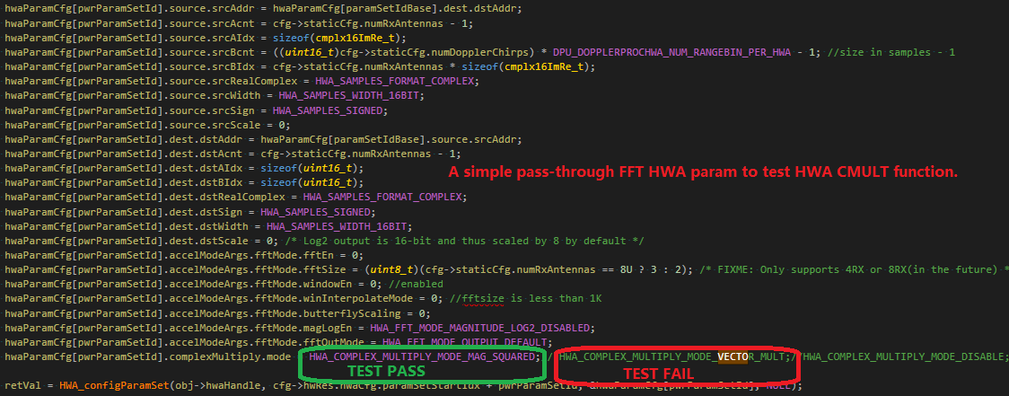

    Direct answers:
    Q1. What is input?
    A1:  Manually generated test pattern on L3:
    00010000 00010000 00010000 00010000
    00030002 00030002 00030002 00030002
    00050004 00050004 00050004 00050004
    (See picture 3  in my original post)
    Q2: what is the functionality trying to achieve
    A2: DBF using 4 RX bins, that is, output = MAGNITUDE(RX1*weight1 + RX2*weight2 + RX3*weight3 + RX4*weight4)
    Q3: what are HWA programming parameters
    A3: A very simple pass-through HWA param which enables HWA_COMPLEX_MULTIPLY_MODE_VECTOR_MULT as pre-processing unit, and use FFT as a simple complex adder (only output the 0th bin), and then outputs magnitude of the FFT bin0 result.
    (See picture 1  in my original post)
    Q4:  what are the observations?
    A4: ALL ZERO
    Please let me know if more information is required but not given in my original post (with 4 pictures showing the supported data and result).

    I have tried HWA AWR1843 test application with these changes to reproduce your issue
    gHWATestParamConfig[paramsetIdx].complexMultiply.mode = HWA_COMPLEX_MULTIPLY_MODE_VECTOR_MULT//HWA_COMPLEX_MULTIPLY_MODE_DISABLE;
    errCode = HWA_configRam(handle, HWA_RAM_TYPE_INTERNAL_RAM/* HWA_RAM_TYPE_WINDOW_RAM*/, (uint8_t *)win_data225, sizeof(win_data225), HWA_TEST_1DFFT_WINDOW_START);
    WIth These two changes, I can see data copied to HWA RAM location (0x50081000). Here are the steps I have followed
    1. Flash ccsdebug.bin to AWR1843BOOST.
    2. Change the test application code (main.c) as mentioned above then recompiled it.
    3. Load the test application to device (MSS core) via ccs
    4. Put a breakpoint in 'HWA_configRam' function and do the step by step debug and check HWA RAM location in CCS memory browser window.
    hwa.c --->>>
    /* copy the RAM contents */
    memcpy((void *)&ramBaseAddr[startIdx], data, dataSize);  /* this code execution will update the HWA RAM location */
    At this point I can see the data content updated on ramBaseAddr place in CCS memory browser.
    BUT next line of this function will reset the HWA RAM location selection, so RAM content will be reset to different content. Effectively HWACCREG7 [24] =0 register will change the RAM type.

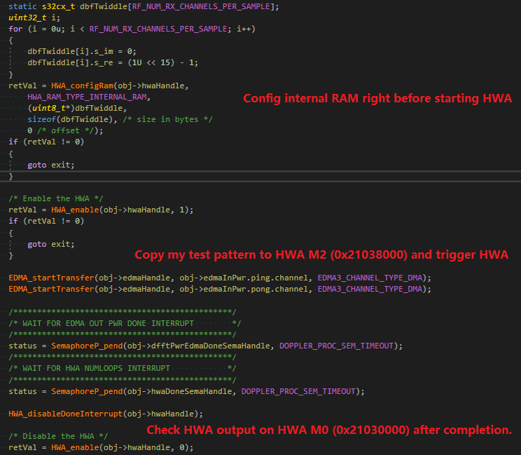

    And in
  • Hi Jitendra,
    Thanks a lot for the clue and hint.
    I tried your test steps and now know why I cannot write INTERNAL MEM in my project, and I can reproduce this issue in SDK hwa_test project as well.
    The internal mem will be inaccessible (non-readable and non-writable) ever since HWA is triggered:
        errCode = HWA_setDMA2ACCManualTrig(handle,HWA_TEST_SRC_TRIGGER_DMACH1);
    And it will be accessible again after HWA is closed:
        /* Close the driver: */
        errCode = HWA_close(handle);
    To be more accurate, the internal mem will be accessible (readable and writable) only after HWA is reset (the code below is called in HWA_close()):
    static inline void HWA_doReset(DSSHWACCRegs  *ctrlBaseAddr)
        ctrlBaseAddr->HWACCREG1 = CSL_FINSR (ctrlBaseAddr->HWACCREG1, 6U, 4U, 0x7U);
        ctrlBaseAddr->HWACCREG1 = CSL_FINSR (ctrlBaseAddr->HWACCREG1, 6U, 4U, 0x0U);
        return;
    While a typical beam steering DBF use case would require multiple different DBF calls per frame, each of which would need a different set of twiddle factors in the internal RAM. I believe it's usually not a good practice to RESET HWA during normal operation, is there any solution for us to be able to update internal window ( with new DBF twiddle factors ) without reseting the HWA engine?
  • Hello HH Chen,
    Which Internal HWA RAM you are trying to RD/WR? As per HWA test application, I was able to write to HWA RAM from test code. Is it not the same thing you are seeking??
    Jitendra
  • Hi Jitendra,
    We are refering to the same INTERNAL HWA RAM.
    You are able to write the HWA RAM because you set breakpoint before triggering HWA , I could read/write before trigger as well.
    The internal mem will be inaccessible (non-readable and non-writable) ever since HWA is triggered, please set  breakpoint at the line below and then try to read/write internal mem using CCS debug:
    The internal mem will be all zero, and all writes to the internal memory will be ignored (until HWA is reset and get ready again).
