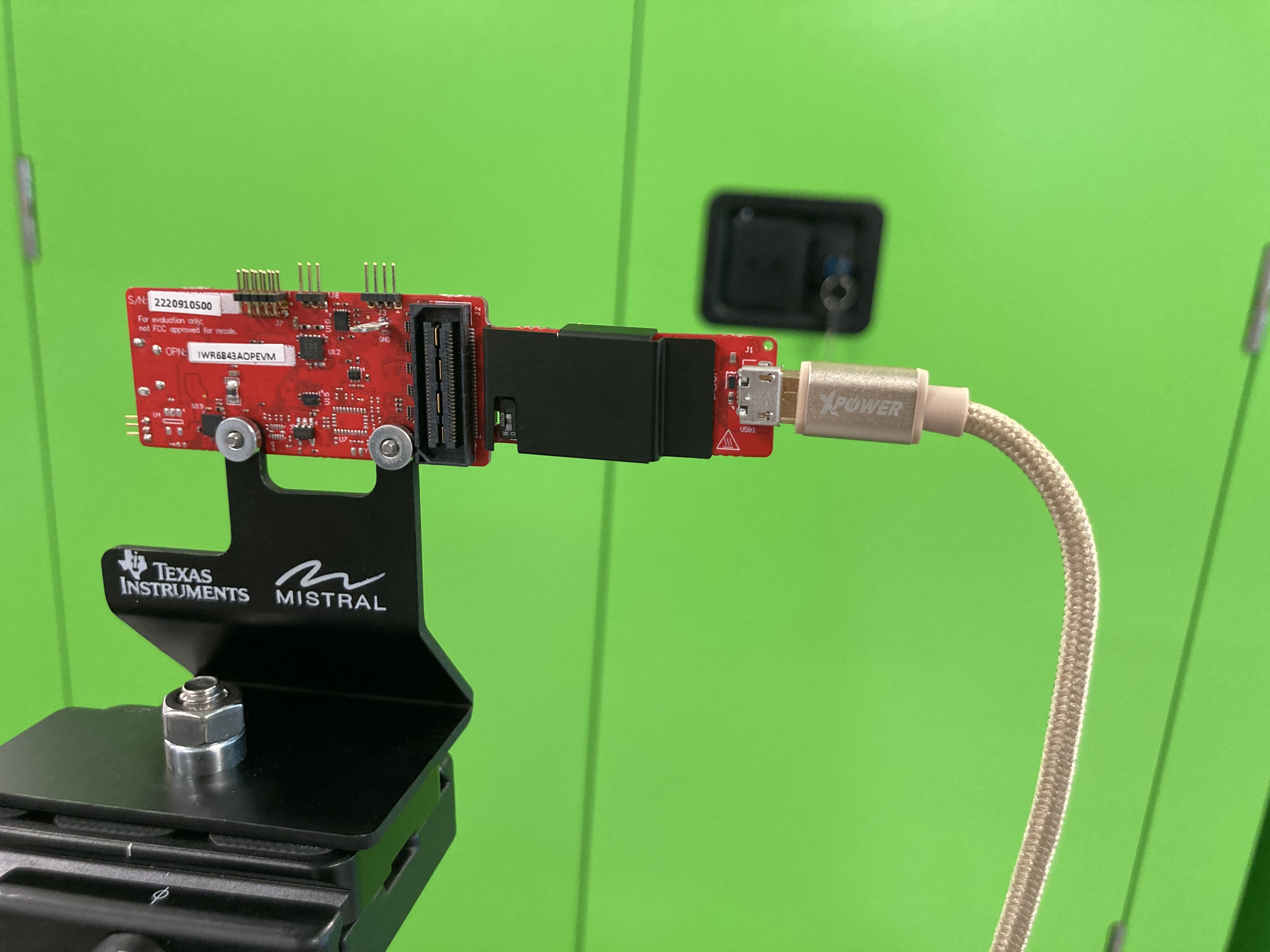

here is my setup:
using IWR6843AOPEVM, with the out-of-box demo. with the corresponding config loaded(copy from the autonomous robotics lab)
the experiment setup: pointing the radar towards a 2m x 1m metal surface. however, the detection result is not as good as expected. it only shows a few points (at least cannot tell it is a surface purely by looking at the points)
the hand-draw rectangle is the imaginary metal surface. and only a few points were inside the surface.
What can I do so that the detection points can be like a surface?

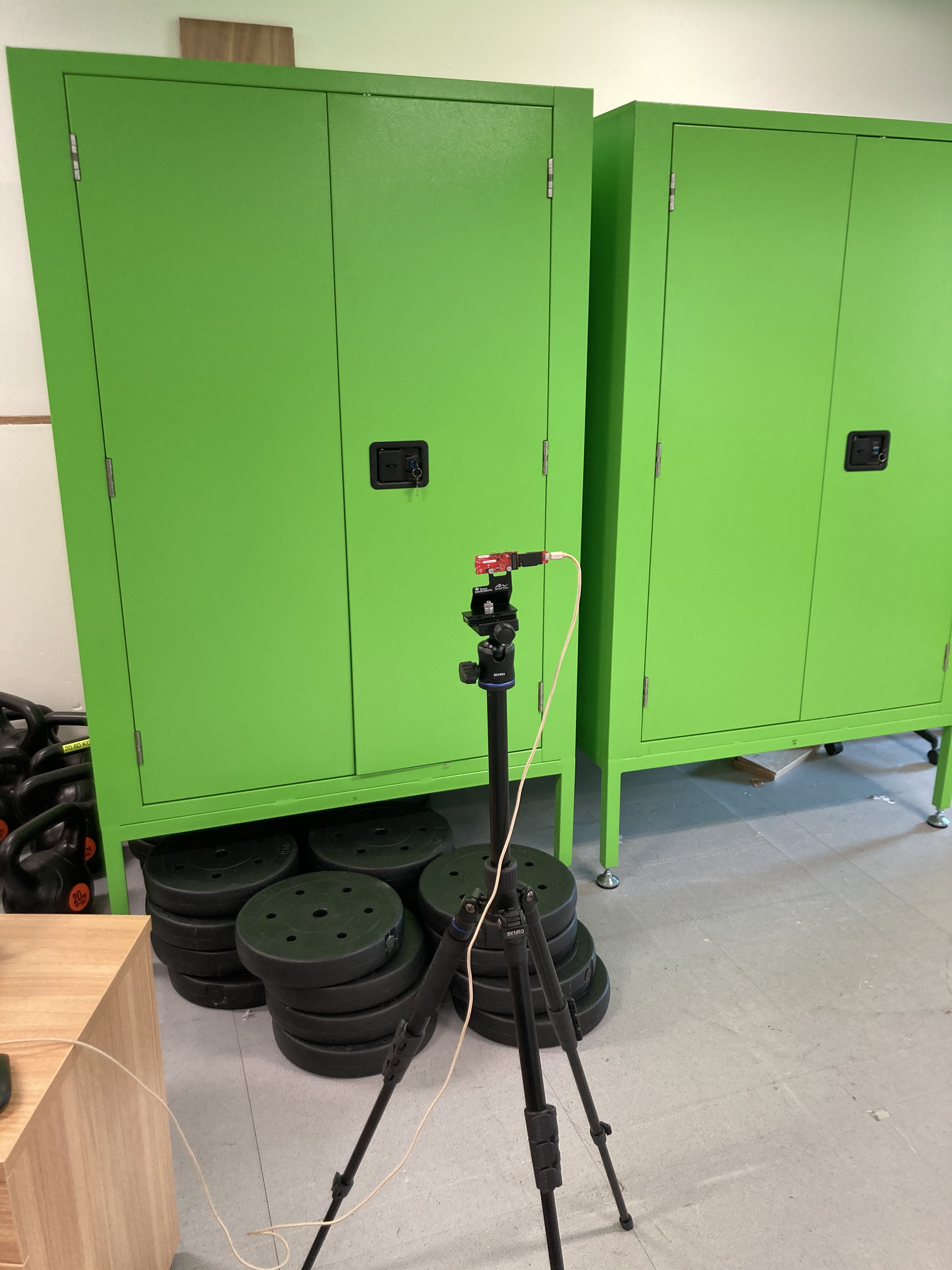

    My setup:
    dimension of the reflector (the front-side of green block): height: 1.65m, width: 1.2m
    distance from radar to reflector: 1.2m (experiment #1), 0.84m (experiment #2)
    and the reflector is in front of the radar.

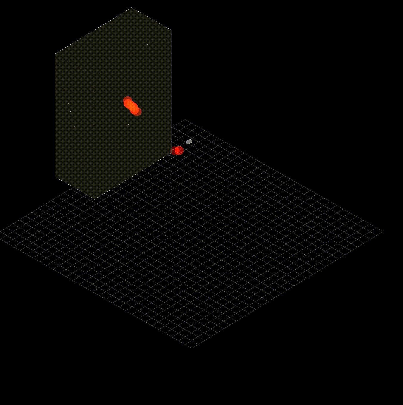

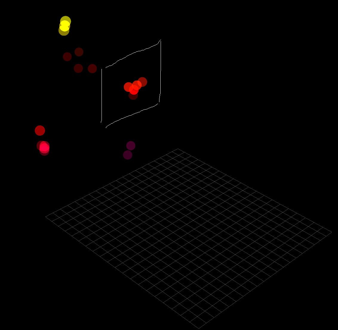

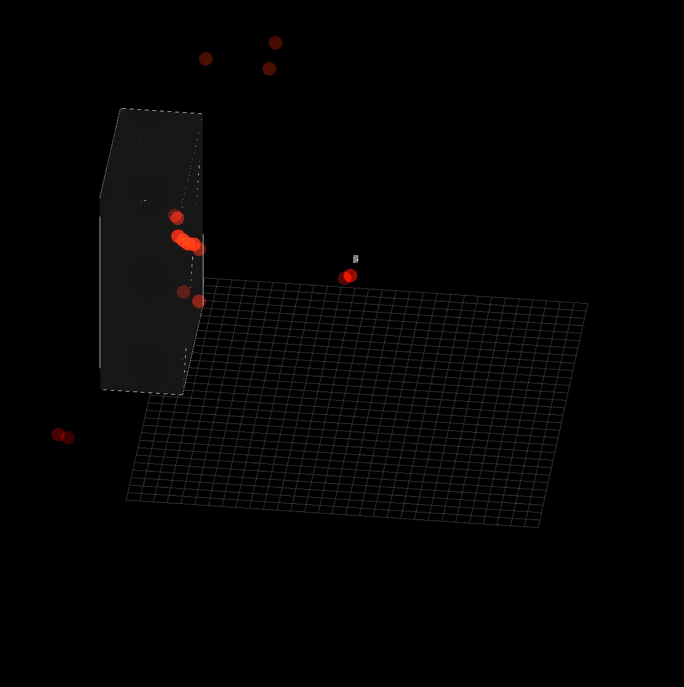

    My result:
    see two gif below (big grey box: the reflector, the small grey box: the radar, the red point with various transparency: point cloud returned from radar)
    experiment #1
    experiment #2
    Observation from the two experiment:
    the returned point cloud mainly located in front of radar, but does not spread over the reflector (CANNOT even form a 20cm*20cm plane), which is not what I expected.

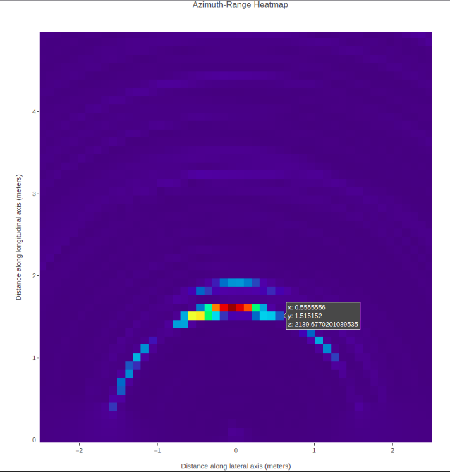

  • this is the azimuth-range heatmap. and it can somehow show the reflector (y=1.5, width = around 1.1m).
    Therefore, the problem of this post very likely is related to the filtering / detection algorithm, such as:
    1. peak grouping
    2. CFAR parameters
    3. multiObjBeamForming
    Please let me know if my thought is incorrect or anything missing...
