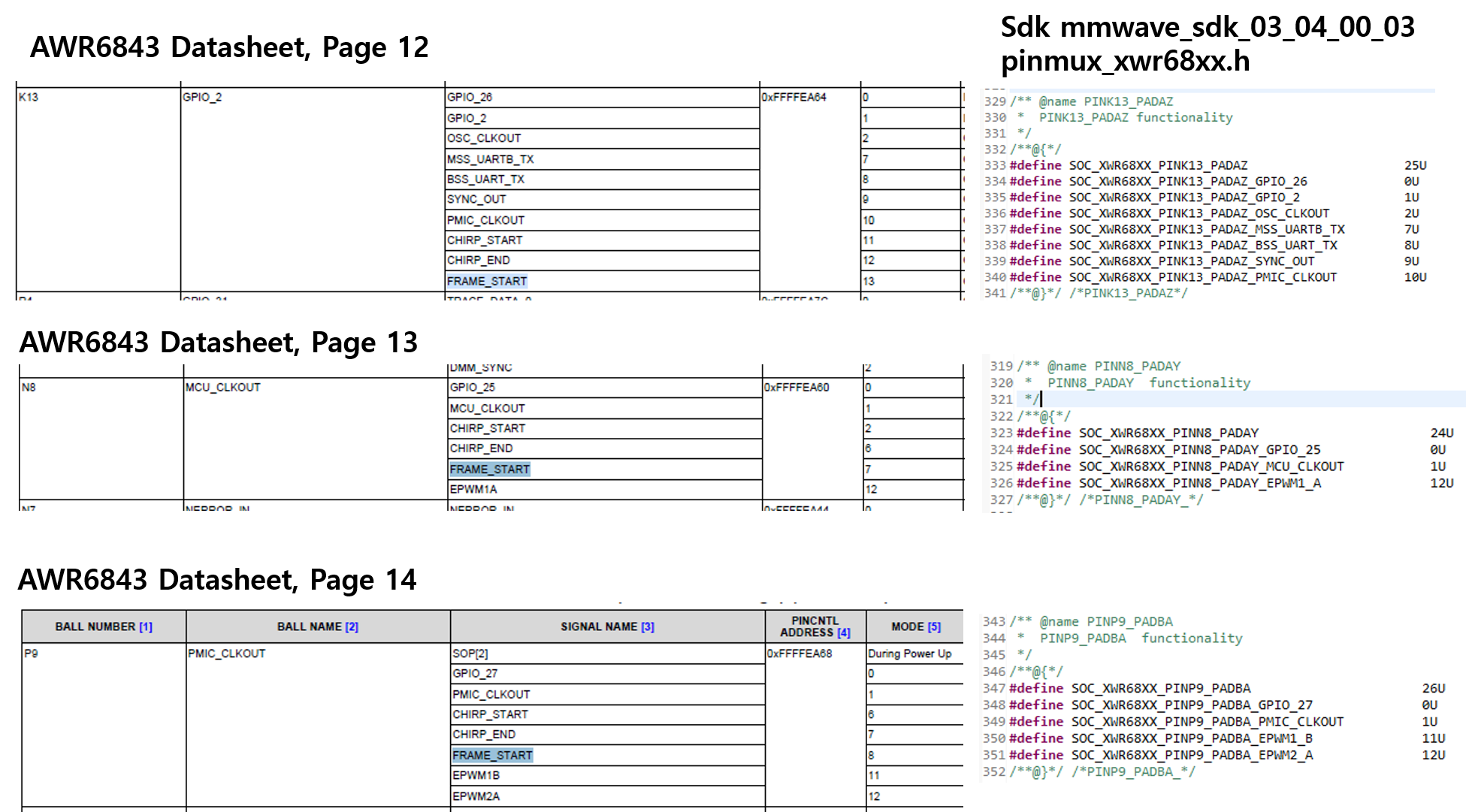

    And I have another question.
    In datasheet, there are the analog pins that can be applied for frame_start, chirp_start, and chirp_end signal.
    However, those registers are not in "the pinmux_xwr68xx.h".
    I would like to get the method for monitoring of frame_start signal through oscilloscope in demo project "mmwave_sdk_68xx_hwa.
    Please assist.
    Best regards.
    I do not think we release source code for the xwr68xx_radarss.bin / xwr68xx_masterss.bin.  So it will be hard to make any change.
    Regarding monitoring frame_start, you can find some information in the document attached.  3731.frameSync.pdf
    But frame_start is when device sending signal, it is not the same as the frame start of LVDS signal.
    Zigang

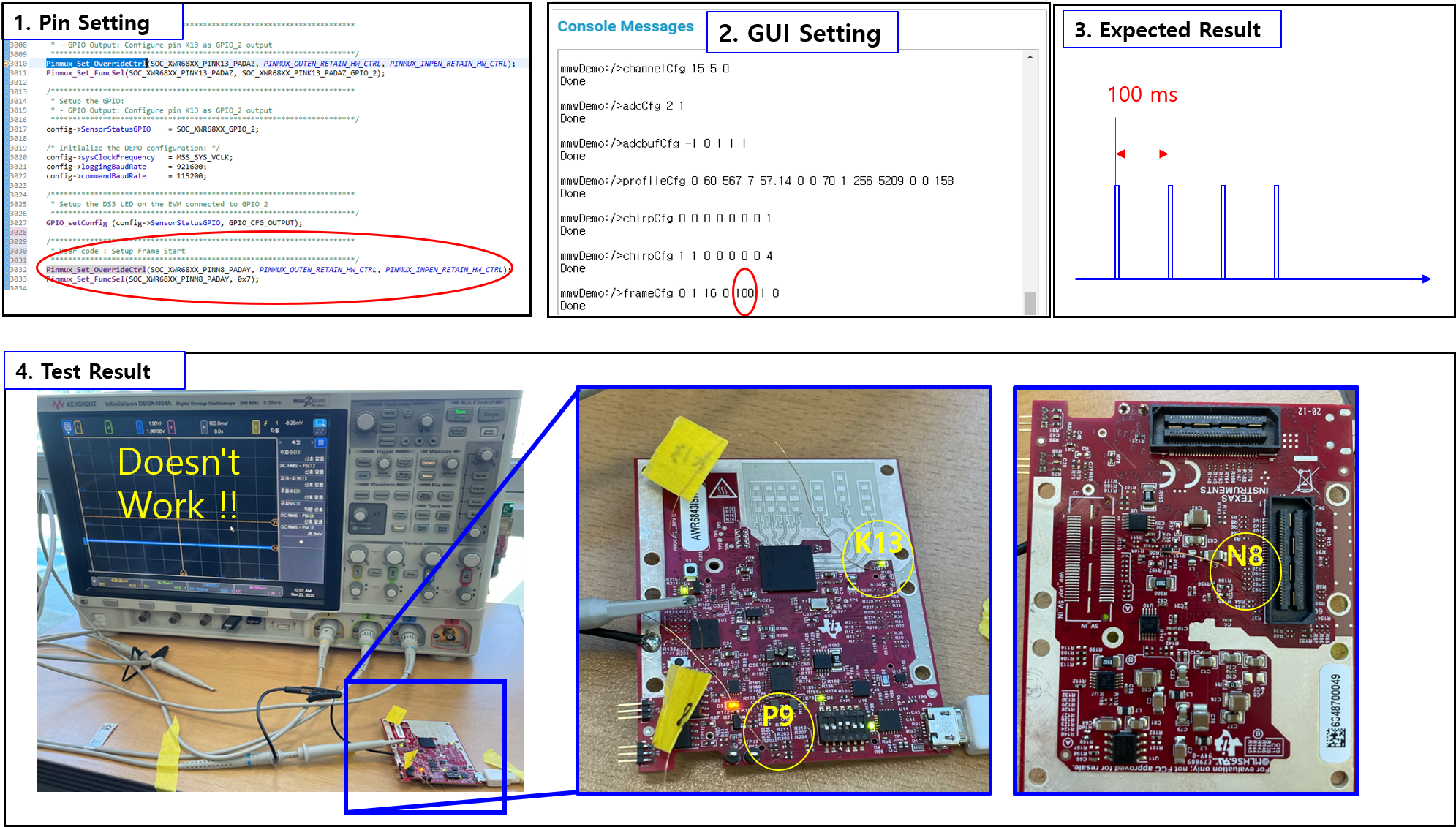

  • Dear Zigang ,
    I followed your guide, but I didn't get the expected result.
    My environment is below:
    EVK : IWR6843ISK
    Demo project : mmwave_sdk_68xx_hwa
    Test procedure :
    Am I doing the test wrong in your opinion?
    How can I get the frame_start signal from AWR6843.
    Please assist.
    Best regard.
