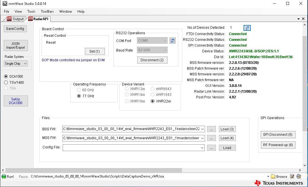

I am able to capture data with mmWaveStudio and to visualize the data with PostProc

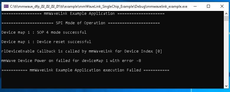

However I would like to capture data without mmWaveStudio. I try to use mmwave_dfp  but unfortunately, I'm stuck with this error when I execute mmwavelink_example.exe
"mmWave Device Power on failed for deviceMap 1 with error -8"
I have try the NRST button on the AWR2243BOOST and the RST button on the DCA1000EVM.

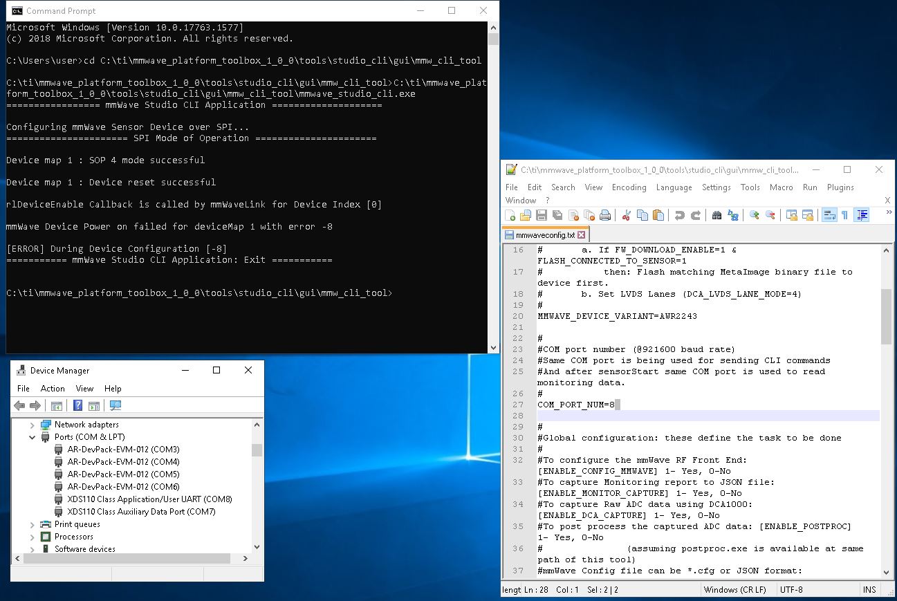

  • Hi Cesar,
    I have the same error with studio_cli
    Thank you,
    Stéphane

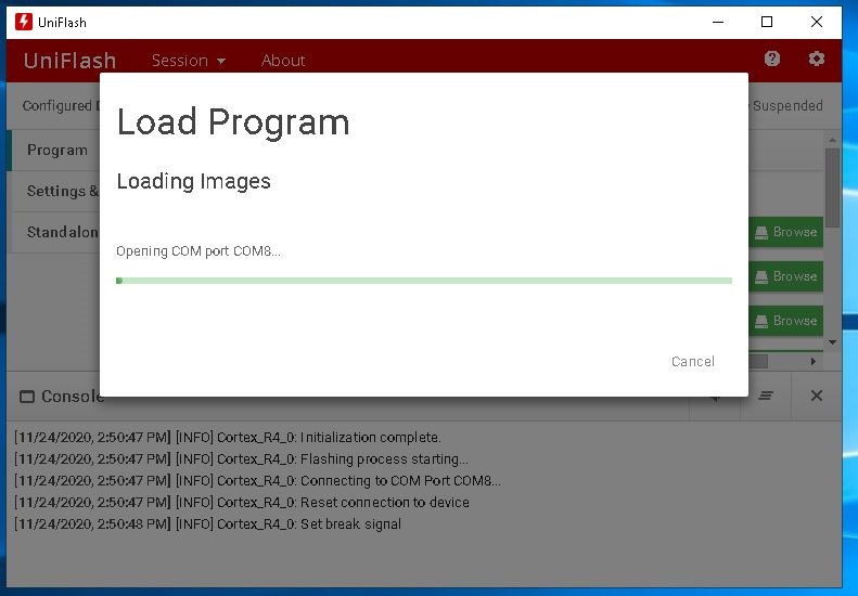

    Maybe the problem is related with the port.  When I try to run a format with UniFlash, the progress bar is not moving.
    What confuses me is that mmWave Studio is working well.
    Stéphane
  • Stéphane,
    In Windows, only one application can access the COM port for the radar device at a time. So when you are attempting to run the demo, you may have another Windows application that already has control of the COM port. Please close all other applications before attempting to erase the flash using the Uniflash tool.

    My goal is still to be able to capture data without mmWaveStudio. Unfortunately,  I still stuck with the "mmWave Device Power on failed for deviceMap 1 with error -8" error with studio_cli.
    I have also debug mmwave_studio_cli with Visual Studio,  the error code "-8" come from the timeout.

    You should not be using Uniflash for the mmWave Link example on AWR2243. The firmware metaimage is downloaded over SPI and then the application is launched. You should make sure your EVM is set to SOP4 mode where jumpers are placed on SOP0 and SOP1.
    You should see the following screenshots when running the mmWave Link example program:
    Please also make sure the S1 switch on the AWR2243BOOST EVM is set to the SPI position and not in the CAN position is set at the midway point.
    Kyle

    If the AWR2243BOOST and the DCA1000EVM were incorrectly connected/configured, the data captured with "mmWave Studio GUI" would not work. But as I said in my first post, I am able to capture data with mmWaveStudio and to visualize the data with PostProc.
