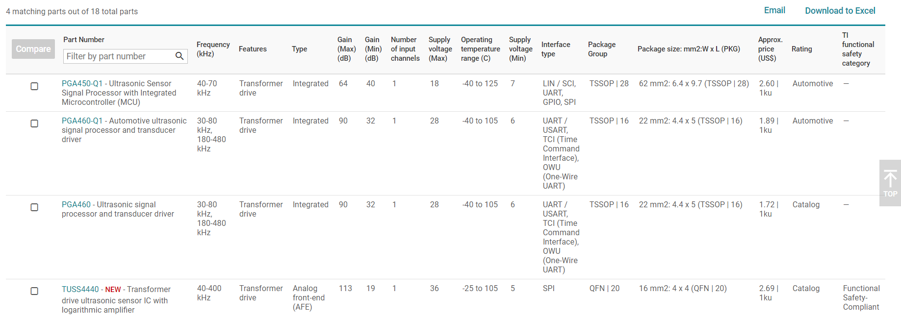

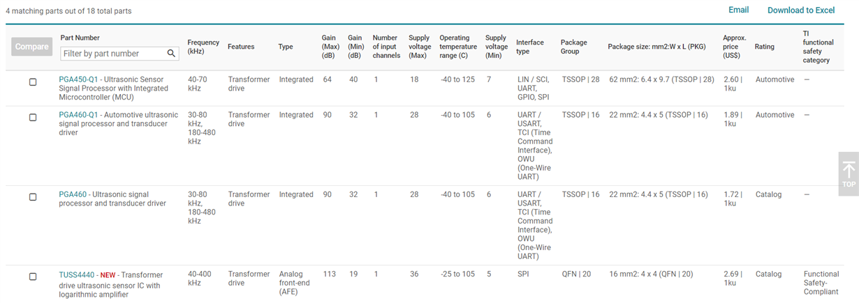

Hi Ganapathy,
The following link provides a comparison of our different ultrasonic devices:
One thing to keep in mind is that the minimum transducer frequency supported is 30 kHz, which is specifically supported by the PGA460.
You can find a list of example transducer and transformer part numbers for the PGA460 specifically here:
