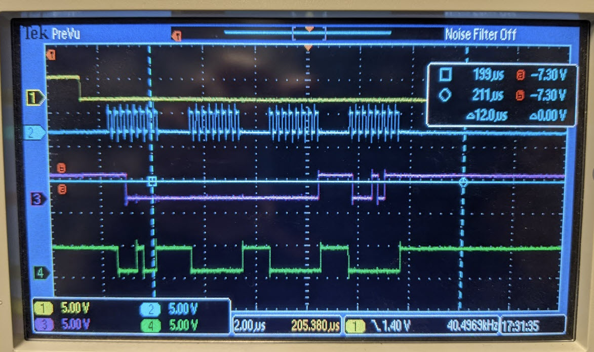

    Unfortunately I am still not getting any readings in the data phase. I scoped my setup in the attachment you can see CS, SCLK, MISO, and MOSI in descending order. I am getting nothing in the dataphase and a 0b1000 in status 0-3 and 0b1011 in CRC. I get this regardless of what I send on MOSI.
    I double checked my wiring +bypass cap which look fine, although I am not pulling up Alert which seemed fine from the datasheet?
  • Alert should be okay without the pull up, assuming you will not be using it as an output.
    From this scope capture I see the CRC Status and Error status bits are high.  These should be low on the very first transaction.
    Also, it looks like your MOSI command is x8980 0000.  The data bits shouldn't matter, but I do notice that this does not match your input command. It may be worth checking your write commands to see that they match the expected values.

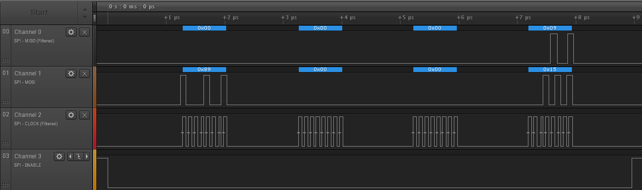

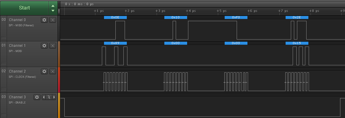

    As a reference, here is what I capture on my EVM for the same transactions you are attempting.
    Output Disabled
    Output Enabled
