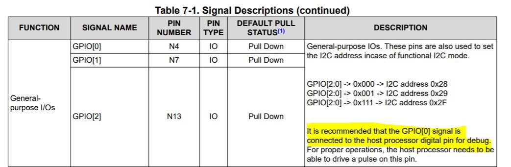

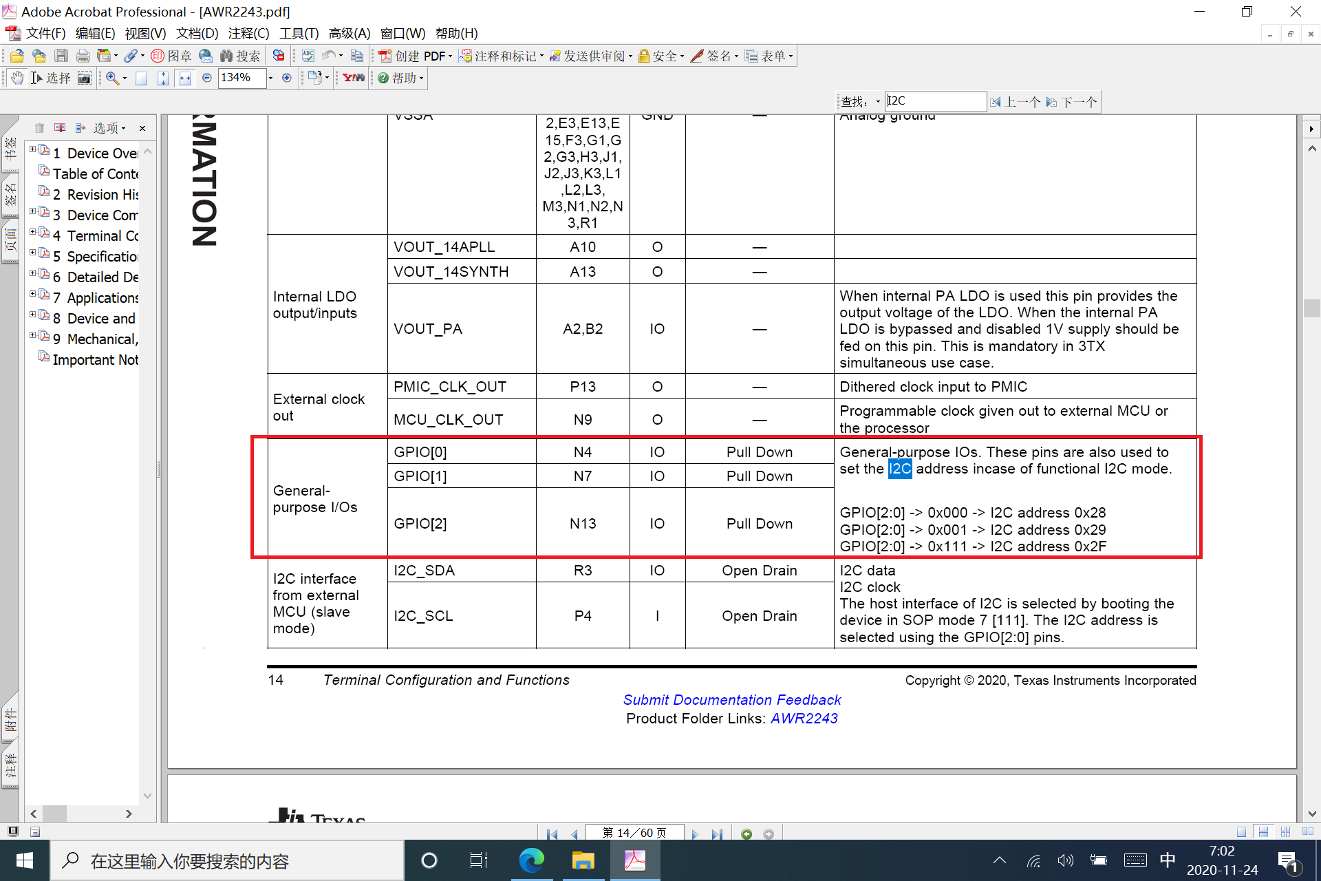

       because GPIO have 3 pin, so I think I2C device address can be set to 8 different address. you mean I2C device address only have three: 0x000 0x001  0x111, is it right?(lists below).
    the function of GPIO has only set I2C address, is it right? I don't need to connect GPIO to FPGA(MCU)?thanks!
  • Hello ,
    You are right, we can support 8 I2C addresses with the 3 GPIO configurations, I double checked that now.
    In I2C mode the function of the GPIO is only to set the address. But in SPI mode the GPIO0 is used for debug purpose to send failure logs incase the SPI interface has issues.
    Vivek
  • Dear Vivek,

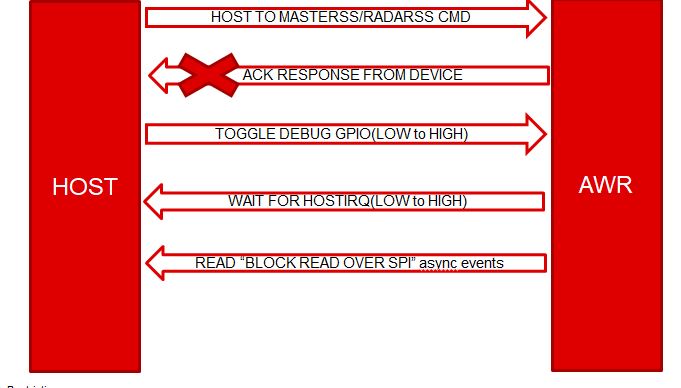

       thank so great for your suggestions, could you give more information about GPIO0? when it will give failure log? what's the meaning of the host needs to be able to drive a pulse on this pin? why host give one pulse to GPIO0, how long time this pulse needs if FPGA gives this pulse?
  • Hello Simon,
    Incase the  host does not get the ack over the SPI interface the host can get stuck waiting for the ack. In this state the host can toggle the GPIO0 to get debug information sent out. Below is the flow diagram.
