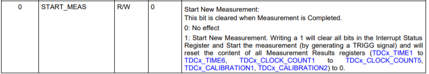

1. At the time, the response was answered that the time could not be adjusted between the last STOP signal and INTB. Then, is there a need to wait for about 2us?
2. I'm using single stop data, can I only use the time1, cal1, and cal2 values for the job?
3. When starting a new measurement, only the start_meas bit in config1 reg is initialized and used. Should I initialize INT_STATUS and INT_MASK separately?

    1. Yes, 1-2 us delay after the stop signal is needed. See post 2846001
    2. Yes, as seen on page 15 of the TDC7201 datasheet
    3. see below
    TDCx_CLOCK_CNTR_STOP_MASK_H and TDCx_CLOCK_CNTR_STOP_MASK_L are used to configure the stop mask, either one time after device power on, or they can be changed in between measurements as needed.
