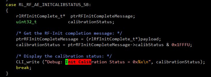

Hello everyone.
I tried to hard code cli.c just like in https://e2e.ti.com/cfs-file/__key/communityserver-discussions-components-files/1023/hard_5F00_coded_5F00_sensor_5F00_config_5F00_14xx_5F00_sdk12.zip from my original cli.c, and compile (using gmake) cli and the demo, and everything seems fine. But when i run the mmWave_Demo_Visualizer, although I got no error message, and when it hit "sensorStart",it emits
mmwDemo:/>Command
Debug: Init Calibration Status = 0x1ffe
Done
and produce no plot. It definitely send something through uart, which I can saw on Tera Term. My question are:

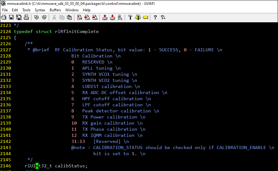

1. What does Init Calibration Status = 0x1ffe mean?
2. Why it doesn't plot? It was plot nicely if i send the cfg through the demo visualizer, but it is not what i want when i hardcoded the cli.
