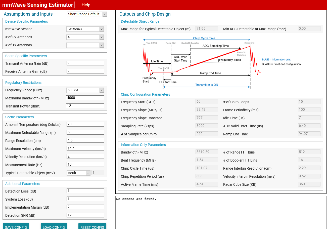

    I tried to use the online "mmWave Sensing Estimator" tool ( https://dev.ti.com/gallery/view/1792614/mmWaveSensingEstimator/ver/1.3.0/ ).
    Following you can find the screenshot with the parameters set
    and following the file IWR6843.estimator.mmwave.json exported:

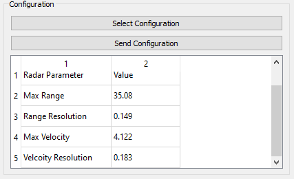

    Trying to load this new custom configuration in the " visualizer " tool, I get the following values for ranges and resolutions:
    As you can see, the values are not the expected.
    What is it wrong?

    2.  You have extracted values from estimator tool  and used them in the profile config:
    TI:  Estimator config json you have provided  vs the profile config you have provided do not seem to match.
    When in Estimator tool please check the value shown by your browsers debug console
    3.  Values  from profile cfg  when loaded in the visualizer tool do not show the right max range:
    TI: Please check fmcw equation    as per our computation
    profile: profileCfg 0 60 7 6.4 94.0666666667 0 0 38.4789705276 1 260 10000 0 0 30
    should give max range of ~35m as expected.

    I also noted that if I specify the Frequency range 60 - 64 GHz in the online tool, in the exported json file, the fields "frequencyRangeBegin_GHz" and "frequencyRangeEnd_GHz" always are set to 77 and 81 GHz respectively. Can be this a mismatch cause? Consider I used the values reported in the exported json file.

  • Former Member
    0 Former Member in reply to Lorenzo Morri
    The sensing estimator is being updated to correct the issues you've identified.
    Refer to the programming chirp parameters application note for the equations on max range.
    The issue is you need to use IF
    % Max Range
    IFmax = 0.8 * calc_P(i).adcSamplingRate_ksps; %assuming complex 1x (only output mode supported in SDK OOB)
    % If complex2x or real mode IFmax = 0.8 * adc_sampling_frequency/2;
    calc_P(i).rangeMax_m = (IFmax*KHz2Hz)*c_speed_of_light/(2*(P.profileCfg.freqSlopeConst(i)*MHz2Hz*sec2usec));
    Also note that there are two equations for max range in the app note - max range as determined by chirp limitations and max range as determined by SNR/RCS limitations. The minimum of the two would apply.
    Amanda

    For #2:  We were referring to debug console of the browser   :( How to : https://balsamiq.com/support/faqs/browserconsole/)
    For estimator tool in  Firefox
    Can  you please confirm you able to
    use the estimator tool,  set the required distance and  create a chipr
    use that chirp in config file for demo (see debug console step)
    When you use the above config in the visualizer it shows the same
    If if you  can confirm above then the original query can be considered resolved.

  • Hi Vaibhav,
    Unfortunately, I cannot tell you that all is working fine. I continue to have problems in chirp configuration using the online estimator.
    Do you have a .cfg file for the visualizer tool working fine according to the parameters I showed in the estimator screenshot of my post of 11-26-2020 ?
    If yes, can you share it, please?
    Comparing your file with mine ( reported on my post of 11-26-2020 ) I will better understand where the errors are.
    Lorenzo
  • Former Member
    Lorrenzo,
    The sensing estimator exported the wrong frame period. Thanks for finding this bug. The GUI shows a frame period of 100ms (which corresponds to the 10Hz update rate your set as the input). The exported file has a frame period of 4.5ms.
    I've made a few changes to the manually converted cfg you posted earlier:
    Change frame period to 100ms, sampling rate from 10000 to 3000 to get the range resolution you of 4.5 cm you were aiming for. The chirp below gives max range of 9.4m, range resolution of 4.5cm, max vel of 14.8km/hr, vel resolution of 1.98 km/hr. This appears to be close to what you were aiming for.
    Note - there's no guarantee that this chirp will work with the 3D ppl count demo you will need to test and optimize.
