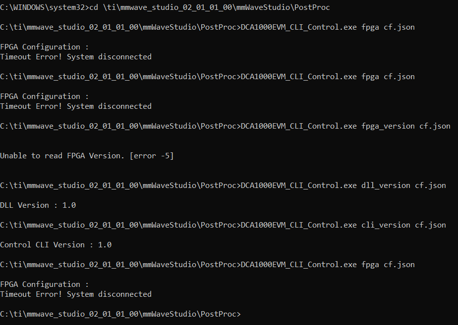

Hi, I have the DCA1000 board, a mmwave-icboost and a iwr6843isk-ods evm (rev A).
Being the first time i will be laying my hands on the DCA1000 board, i have very tough assessing it over ethernet using the ip 192.168.33.180
I was certain my host pc was set at 192.168.33.30, but all efforts to reach the DCA1000 proved abortive. i used both wireshark and angry-ip scanner to try detect any response from the device to no avail.
i ensured that the mmwave-icboost was set to DCA mode and also made sure that the sensor evm sit correctly. the 60-pin samtec cable was also connected, and power provided over the 60-pin cable to the DCA board from the boost board.
i interchanged both sw2 between 6 and 11 and made sure to do a power un/plug every time. still connection over ethernet was not possible.
what am i missing?

  • Thanks for the response Zigang.
    This is me writing out of frustration. I've spent the whole weekend troubleshooting one thing or the other. Spent the whole of toward reading/poring over links, data sheets, slides, manuals, even seeing youtube videos. All to just make a simple data acquisition board to work. And still with all this, no success.
    I changed firmware, 'teardown' firewall, did everything doable. Yet this device will not work! This is the most frustrating board i have ever used, and it is so so annoying!
    My time resource that should be spent on useful development is used to setup a board, yet without any success. Quite bad!
    -Tosin
  • Hi, Tosin:
    Please follow my first link (the step-by-step procedure) on radar studio GUI setting, and let me know how far did you go?  Did you stuck at DCA1000 setup?  Did you disable WIFI? Usually you can not have other network connected during data capture.
    Zigang

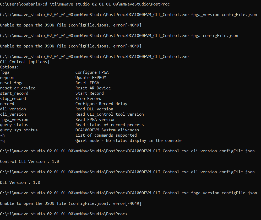

  • hi Zigang,
    I made sure to follow all the instructions from the links you sent. My board is IWR6843-ODS Rev A, and that means I was using it on the IC BOOST card. ON the boost card, I ensured to follow the settings for the SOPs and switches on both dca and boost cards.
    I disabled all other networks, enabled ports 4096 and 4098 on both inbound and outbound on the firewall. Yet, mmwave studio cant read the firmware number of the DCA board. Hence, i cant get this whole thing successfully setup.
    See the log file in attachment.
    -Tosin

    [10:55:51]  [RadarAPI]: ar1.CaptureCardConfig_EthInit("192.168.33.30", "192.168.33.180", "12:34:56:78:90:12", 4096, 4098)
    [10:55:51]  [RadarAPI]: ar1.CaptureCardConfig_Mode(1, 2, 1, 2, 3, 30)
    [10:55:51]  [RadarAPI]: ar1.CaptureCardConfig_PacketDelay(25)
    [10:55:52]  [RadarAPI]: Sending fpga command to DCA1000
    [10:56:02]  [RadarAPI]:
    [10:56:02]  FPGA Configuration :
    [10:56:02]  Timeout Error! System disconnected
    [10:56:02]  [RadarAPI]: Sending record command to DCA1000
    [10:56:13]  [RadarAPI]:
    [10:56:13]  Configure Record :
    [10:56:13]  Timeout Error! System disconnected
    [10:56:13]  [RadarAPI]: ar1.GetCaptureCardFPGAVersion()
    [10:56:13]  [RadarAPI]: Sending fpga_version command to DCA1000
    [10:56:23]  [RadarAPI]:
    [10:56:23]
    [10:56:23]  Unable to read FPGA Version. [error -5]

    [10:56:36]  [RadarAPI]: ar1.CaptureCardConfig_StartRecord("C:\\ti\\mmwave_studio_02_01_01_00\\mmWaveStudio\\PostProc\\adc_data.bin", 1)
    [10:56:36]  [RadarAPI]: Sending start_record command to DCA1000
    [10:56:46]  [RadarAPI]: ar1.StartFrame()
    [10:56:46]  [RadarAPI]: Status: Passed
    [10:56:46]  Frame start async event received!
    [10:56:46]  [RadarAPI]: Frame Ended
    [10:56:47]  [RadarAPI]:
    [10:56:47]  Start Record :
    [10:56:47]  Timeout Error! System disconnected

  • HI, Tosin:
    You may also use the CLI mode to check.  And let me know the error message.
    • Please do till the frame configuration from radar studio.
    • Open the cmd window, go to C:\ti\mmwave_studio_02_01_01_00\mmWaveStudio\PostProc directory
    >> cd C:\ti\mmwave_studio_02_01_01_00\mmWaveStudio\PostProc
    • issue the CLI commands for configuring DCA1000 (refer the CLI user guide for the commands).
    >>DCA1000EVM_CLI_Control.exe fpga configFile.json
    Zigang
  • Somehow, the system does not allow to attach the configFile.json file, so I am copy the content below

  • Thanks for further guidance Zigang.
    I have taken the following actions again and no success in getting the DCA board to be functional:
    1. I reprogrammed the FPGA of the DCA, and that was successful- dcaLog1.txt and dcaLog2.txt are the log files from the Lattice Diamond program
    2. After the reflashing, and on the mmwaveStudio program, I followed the steps up to SensorConfig tab as advised. Please see the dcaLog3.txt for the logs in mmwave_studio
    3. I then proceeded to follow your instructions and the extra details given in the DCA1000EVM CLI Software User Guide- a screenshot is attached cliDCA.png
    All these steps were followed with no success. But as your can see from the screenshot, i could read the versions of the DLL and the CLI but not that of the FPGA.
    When doing this, i ensured that Wifi was disabled (pc on planemode), ports 4096 and 4098 were unblocked, right IP set on my pc Ethernet (192.168.33.30), and all USB cables connected correctly.
    Please do let me know what other tips I can get to try.
    -Tosin

  • hi Zigang,
    I might have been using the wrong .json file. So, i corrected myself and used cf.json which is available in my PostProc directory. But this didnt still make my DCAboard to work.
  • HI, Tosin:
    The attachment on your last reply did not go through.  Can you attach it again?  Usually copy/paste does not work.
    Zigang
