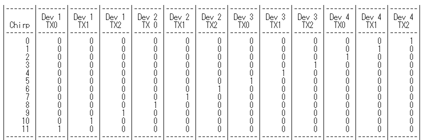

Function to configure the chirps specific to a device
12 chirps are configured below, individually for each AWR device
-- Note: The syntax for this API is:
-- ar1.ChirpConfig_mult(RadarDeviceId, chirpStartIdx, chirpEndIdx, profileId, startFreqVar,
-- freqSlopeVar, idleTimeVar, adcStartTimeVar, tx0Enable, tx1Enable, tx2Enable)
I understood the number of chirp per frame, number of frames for master and number of frames for slave, however, I did not understand the order of chirp (active antenna).
Could you please tell me the frame structure?
Kawaguchi
  • I inserted the picture in previous post but the picture cannot be shown (I don't know why). so I repost the picture in this post.

    In MIMO mode of operation, Multiple TX antennas transmit independently to form a virtual array of antennas. As you can see from the figure you attached above, each chirp is transmitted by a different device [i.e The Master (Dev 1 here) or either of the slaves (Dev2, 3 or 4)] and a different transmitter as well (this is highlighted at the start of every column as TX 0, 1 or 2).
    MIMO functionality helps to improve the angle resolution by creating a virtual antenna array using the same number of antennas and hence that is what is implemented in the script. You might want to refer to the below app note as well which explains the MIMO operation in detail :
