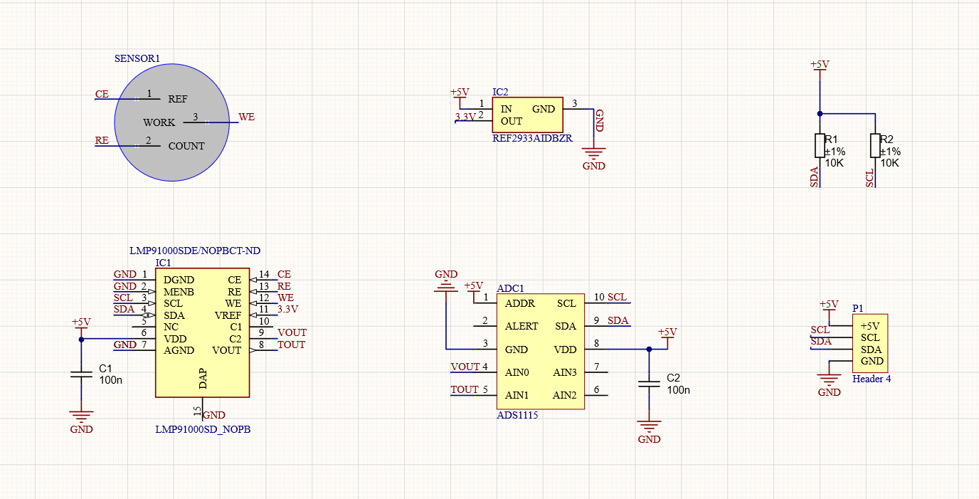

  • Asier -
    How do you have this wired up? Can you share your connection diagram/schematic?
  • Hi Josh,
    Here it is.
  • Asier -
    thanks!
    I see you have CE and RE swapped on the names of the nets of the sensor and also, assuming you mean to use this sensor in potentiostat config, you need to short those same two pins together. See figure 26 on page 19    https://www.ti.com/lit/ds/symlink/lmp91000.pdf

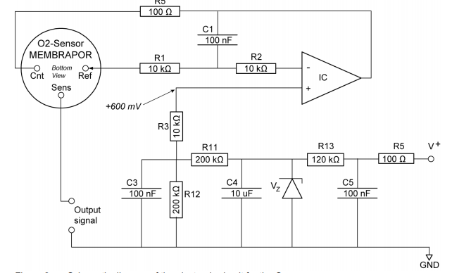

    The names are swapped but they are well connected in my circuit so that is not the problem. On the other hand, my sensor needs a 3 lead configuration since it is an electrochemical oxygen sensor (not galvanic). Info about my sensor: http://file.yizimg.com/3381/2019225-144213788.pdf
  • Asier -
    Please see here, where they describe using this sensor in potentiostat mode. I think you do need to connect RE and CE together and you can check with the sensor mfg. to make sure.
    http://www.membrapor.ch/sheet/Application_Note_MEM2_Oxygen_Sensor.pdf
    In our database of 13 O2 sensors (located in the LMP91000 GUI), every one of them is connected in the manner I pointed you to in the datasheet (on page 19), not page 18 (which shows the galvanic connection)
  • Hi Josh,
    I have read the PDF you attached. They explain pretty well how the circuit works but I don't see the RE connected to the CE, they are using a 3 lead mode.
    However, if you recommend connecting them I will try it.
    Asier.

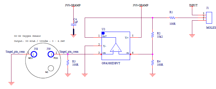

  • In our design we needed a sensor that could be decoupled completely from any power source and then be ready to run, once the amp was powered up.
    That is why we selected the Alphasense O2-G2 low profile sensor. It is self biasing when a resistor is connected. And the connector need to be continously connected otherwise the time needed to reach stability are hours.
    R3 is the biasing resistor.
  • If you don't mind attach the picture correctly so I can see it please.

  • Asier,
      Looking at this schematic, What does not make sense to me is that R3 is pulling to ground. You don't have a bias voltage applied to the sensor. Unless you have more for this circuit that is not shown, it is not possible.
    I will review your post and see if I can help you with this issue. More coming soon.

  • Hi Gordon,
    I think you are talking about the schematic Niels sent. In my schematic, there is not any R3 resistor connected to GND. My sensor is perfectly biased until the standby mode turns on.

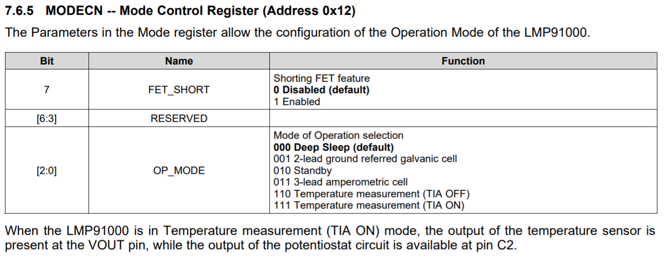

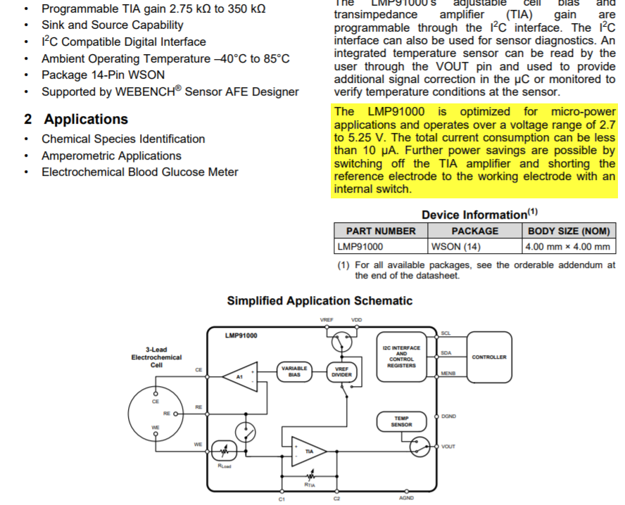

  • Asier,
      That makes total sense. When A1 amp is on your are providing a bias voltage, However when TIA is off, WE will float up and WE = CE. Are you turning on the Shorting FET when you enter Standby mode? This will connect WE to RE and keep the sensor biased while TIA is turned off.
    On the first page of the data sheet there is a brief explanation.
  • Hi Gordon,
    Enabling de FET during the standby mode did not have any positive consequences. The bias needs more time to get to the -600mV since during the standby mode it turns to 0. Shorting those 2 pins could make sense when no power is applied to hold them at the same potential when not in use.
    Apart from that, I have still doubt about why the bias voltage falls during the standby instead of holding the value.
    Asier.
