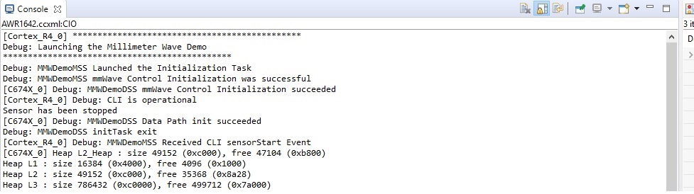

  • Just a bit more info, i have now found out that the ARM processor portion of the Radar system is not crashing, it is the either the digital signal processor or the Radar Subsystem not sending any data to be sent out Via CAN.
    When i press the button for switching the radar on and off , on the demo board. The status LED changes state which means the ARM processor is still operating.
    I am using the  mmWave Automotive toolbox Lab 0005 software if anybody can replicate this problem and help me solve this it would be appreciated thanks.

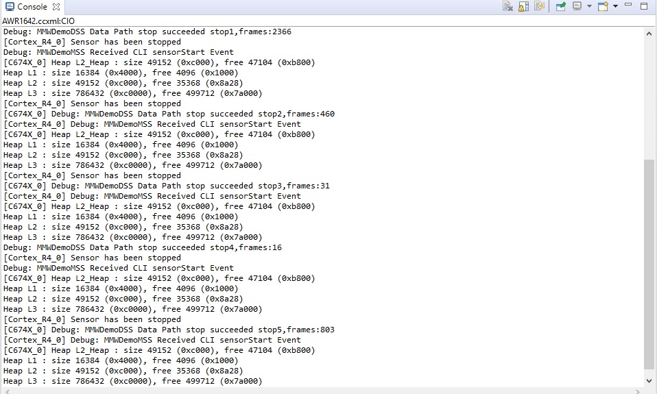

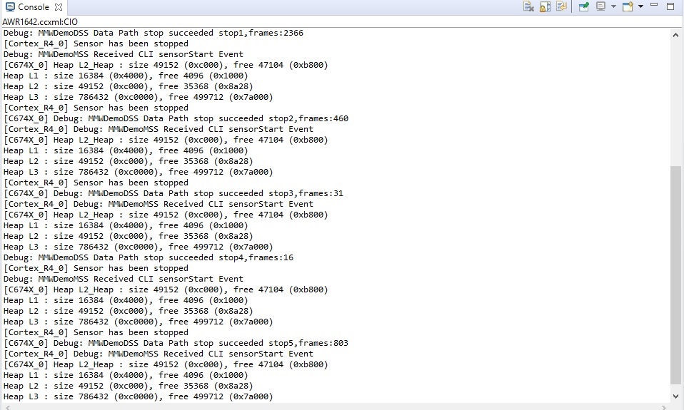

  • Hi Jitendra,
    The mmWAVE demo in the SDK works without any issues, no matter how hot i make it.
    i have managed to get the debugger setup and have the CAN software running in CCS with the console on and i'm getting all of the start up information in the console.
    The CAN software will still stop when i warm the board up but it doesn't throw any errors in the console when it does. So investigated a little further, when i manually switch the sensor on and off using the button,
    the console will display that the sensor is switching and off  successfully and gives a frame count from the sensor.
    The CAN messages never restart though.

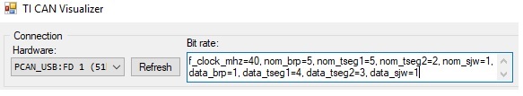

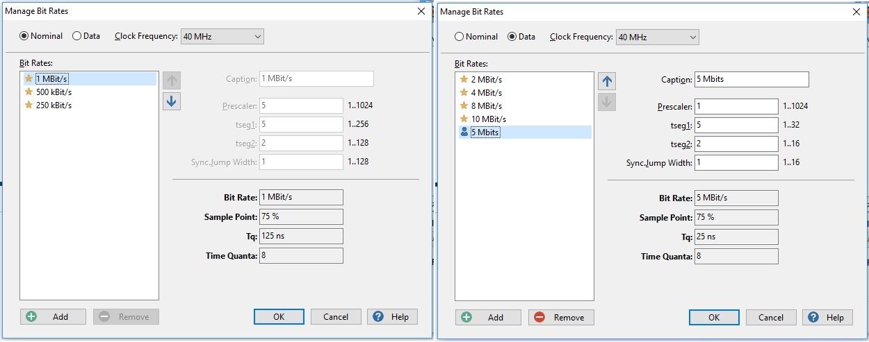

  • Hello Dave,
    Could you provide setting in the PCAN-view?
    Please confirm if you are using mmWaveCANVisualizer.exe from odoc-host\gui\gui_exe directory.
    If the sample point in your PCAN-view setting is less 75% then device generates those CANFD errors. So make sure that you set sample point more than 75 in PCAN view (if you are using PCAN-view not mmwaveCanVisualizer.exe)
    CAN is handshake based protocol, if device CAN interface doesn't get ACK from external CAN host then it polls for sometimes and then stop sending data. So your error may depends on external PCAN dongle as well.
    Jitendra
  • Hi Jitendra,
    All my setting are ok and I'm using the visualiser that from odoc-host, i made my software was up to date as well.
    though the default CAN settings in the visualiser seem to set the data bit sample point to 62.5%
    I have tried playing around with different sample points to see if anything changes and they all seems to end in the same result or do not work at all.
    The other bit of equipment that i have designed to go with this gets the same results as the dongle so i think the dongle is fine.
    Kind Regards,
    Dave Bennett.

  • Hello Dave,
    As per your last reply, it was working fine when you use fixed data instead of object data to send over the CAN.
    As object data generated can be of different size at every frame and it can be big size as well.
    Could you try to generate same size of fixed data which you need to send at every frame similar to object data streaming over the CAN?
    This way we can prove that when data is of huge size and are back to back many chunk then over the time/temperature CAN interface get stuck.
    And could you change bit timing values so that the sample point is higher than 75% at the PEAK GUI or visualizer setting?
    Jitendra
  • Hi Jitendra,
    i have had some success, a combination of setting the sample point in the Visualiser to 85% and adding some code into the error handler to reset the CAN peripheral seems have gotten me something i can work with on the demonstration board, i still get the an error once in a blue moon but it now can not lock the system up and it recovers.
    Hopefully i will be able to get it working on the prototype PCB's that are now ready,
