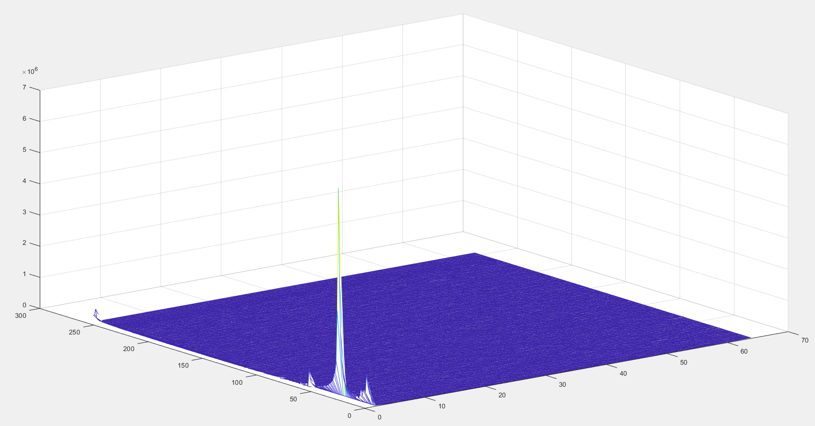

1. When I configure idleTimeVar variable in chirp profile. I am not getting proper output in the cascade radar and below I have attached the Matlab plot for reference.
Below is the configuration which I used for my experiment:
profileCfg 0    77  5   6   40   0   0   79 1   256  8000   0   0   30
chirpCfg 0 0 0 0 0 1 0 1
frameCfg 0 0 64 0 100 1 0
2. I have also tried a similar experiment in IWR6843 ODS and its works fine even after configuring idleTimeVar variable in chirp profile. Facing issue only with cascade radar.  May I know why?
3. Can you please help me in resolving this issue?

  • Hi
    1.What type of SW are you using to configure the cascade radar?
    I have used Sensing Estimator to generate the configuration for the cascade radar.
    2. Have you modified the Matlab scripts provided?
    Yes, I have written a Matlab script to analyze the raw ADC data output of cascade radar. I have used the same piece of Matlab code to analyze the data with idleTimeVar = 0  in the chirp profile is giving proper output as below.
    when I configure idleTimeVar variable in the chirp profile. I am facing an issue Only In the cascade radar.
    Please help me in resolving this issue.

    1. We have not used  mmwave_studio for my experiment. I have used only PROCESSOR_SDK_RADAR_03_08_00_00 to build & run my use-case.
    2. We have set all my necessary parameters in chains_common_cascade_ar12xx_config_mimo.c file and I have configured the cascade setup by running object detection use-case.
    3. We have used CCS and JTAG to dump the raw ADC data for post-analysis.
    4. We have created our own Matlab scripts based on the provided ones. We have modified them to adapt to our data and plot 2d FFT. "we do not suspect the Matlab because we are getting the correct plot even in cascade board when idleTimeVar is not set".

  • Hi
    We have found the bug in our configuration and fixed it. Now it is working fine.
    The bug was we missed setting the ideal time var properly in the chirp cfg for one of the sensors.
    Thanks for your support
