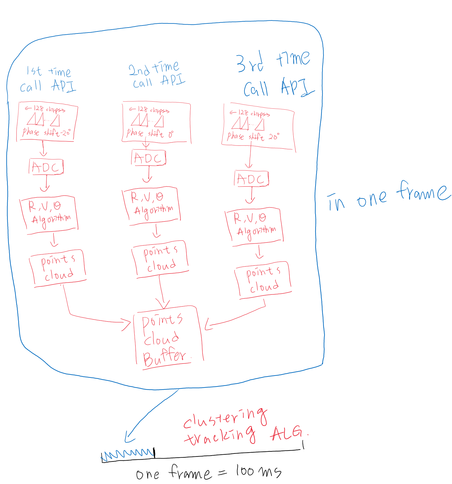

  • Hi Zigang,
    Sorry for late reply.
    What we need is call the phase shifter API "rlRfSetPhaseShiftConfig" three times in one frame.(Show as below)
    If this API must to wait for the next frame for a new phase setting.
    How should we control the period of frame time dynamically?
    Maybe the first few frames we can set short frame time just for data collection and the last frame set the long frame time for algorithm.

  • HI, BR:
    you can define 3 subframes, and each with different frame period, and each with different TX phase shifter.  But the current SDK out of box demo does not allocate different radar cube memory for each subframe, so you will have to process the radar cube after each subframe, and maybe create some global variable to save the end results and then jointly process them together after the last subframe.
    Let me know if it makes sense to you.
    Zigang

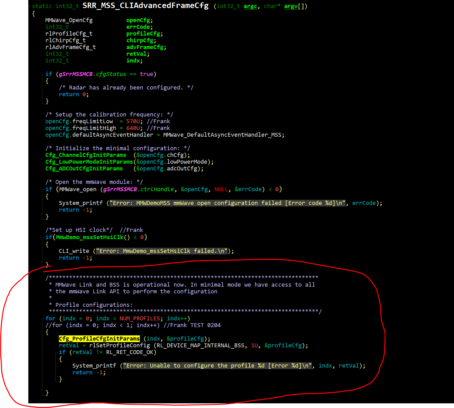

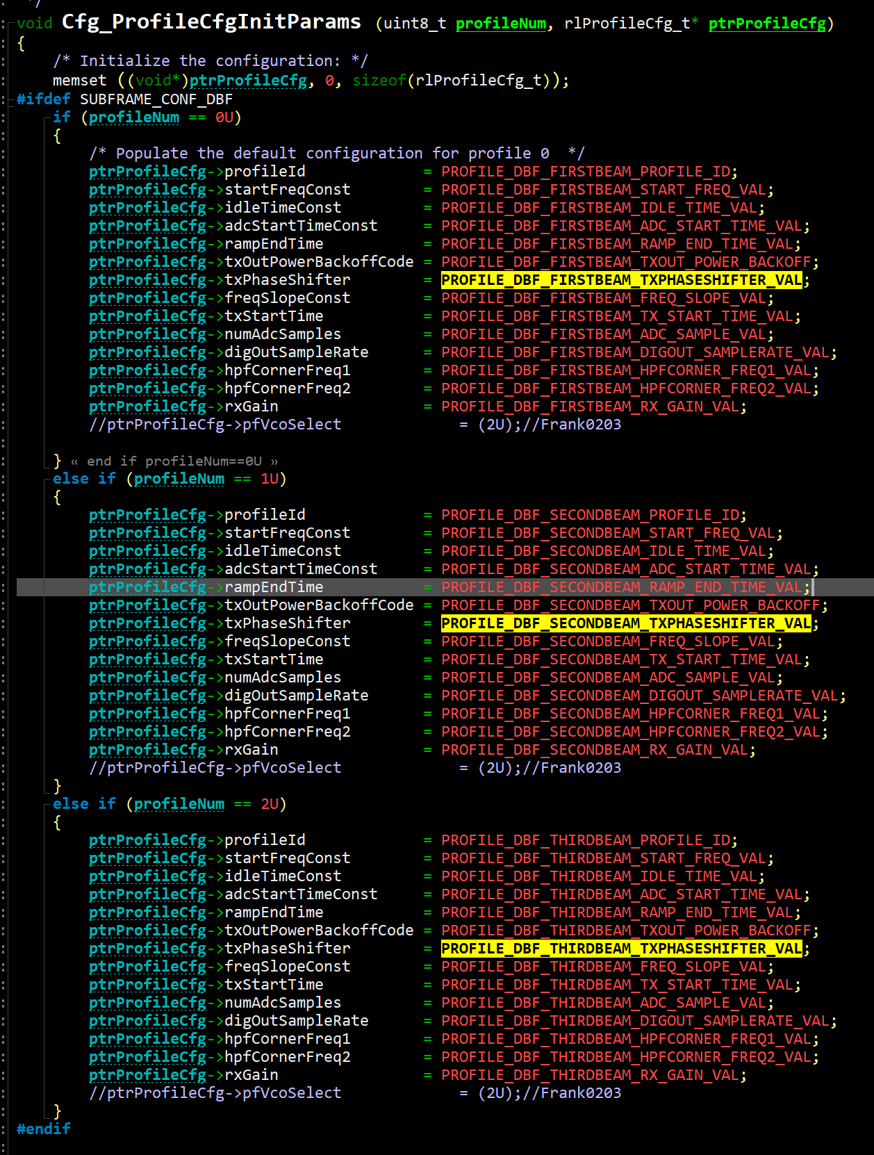

  • Hi Zigang,
    I tried what you suggest to build up the multi sub-frame to satisfy the dynamic frame time.
    It worked about the frame time problem but still has some problem on Tx phase shift.
    I set three initial tx phase to each sub-frame by "Cfg_ProfileCfgInitParams" (NUM_PROFILES = 3)
    but in the last, it only provide one tx phase what we first set in "Cfg_ProfileCfgInitParams" (PROFILE_DBF_FIRSTBEAM_TXPHASESHIFTER_VAL"), we observed it by RF pattern measure.
    Why can not to set initial Tx phase to each sub-frame by setting "Cfg_ProfileCfgInitParams"?
    Is it must to use this API "rlRfSetPhaseShiftConfig " what you suggest before to change tx phase dynamically  for each sub-frame?
    BR
    Frank

  • HI, Frank:
    It sounds like although three profile are defined here, but only one profile configuration is used.  Is it from the out-of-box demo code?
    Zigang
