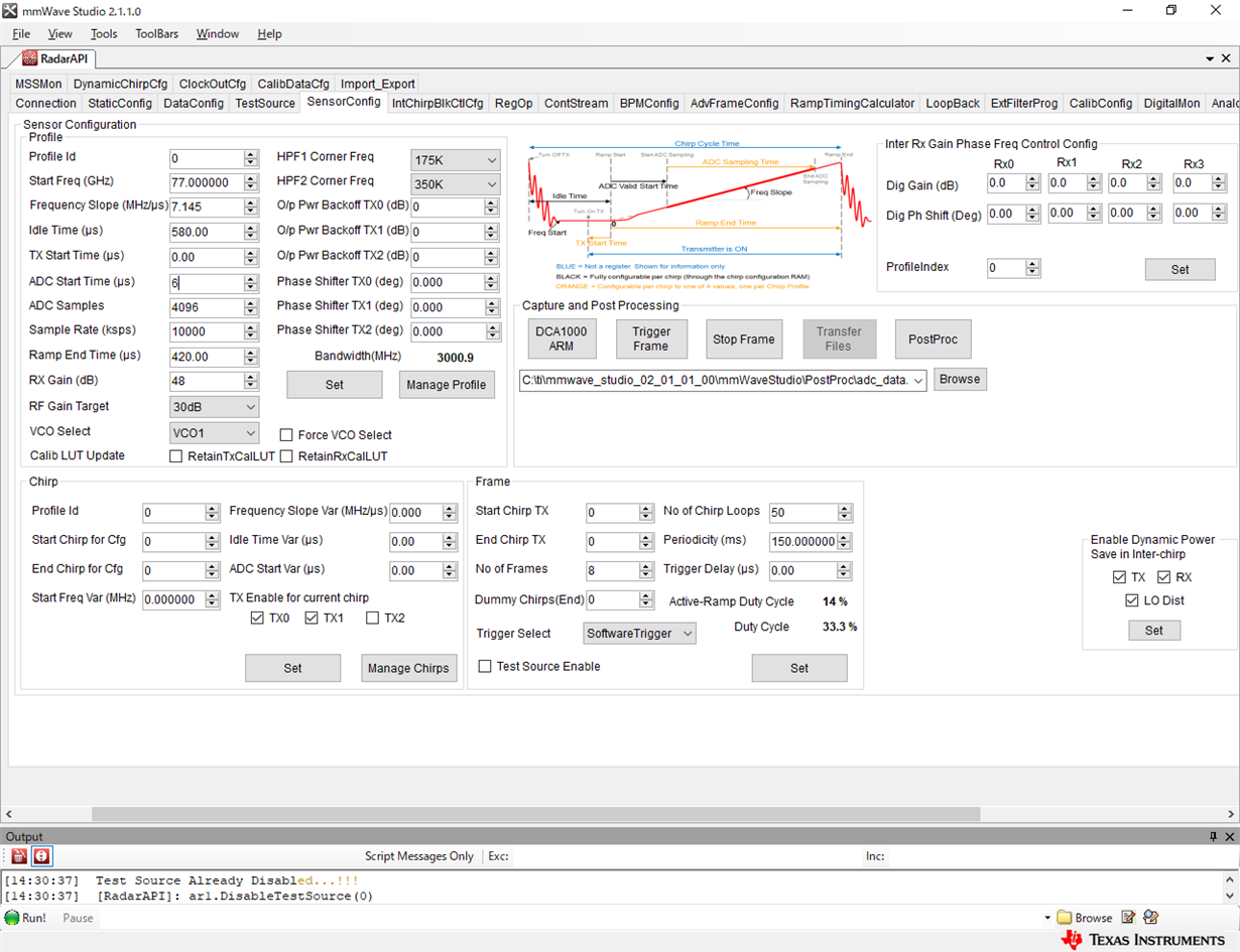

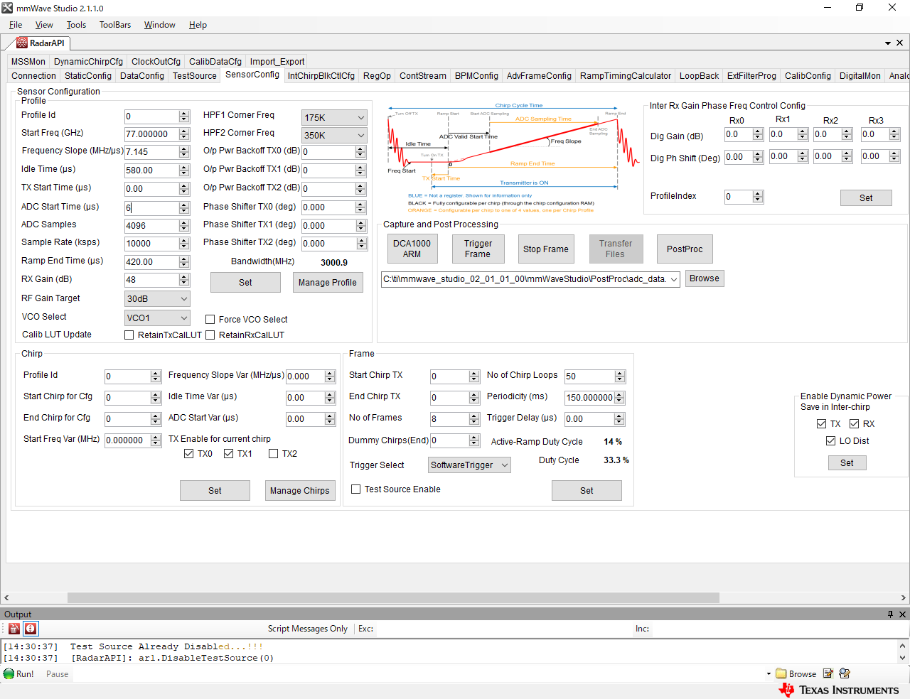

The sensor configuration is as follows.
When you press DCA1000ARM, the following statement is displayed.
[14:32:23] [RadarAPI]:
[14:32:23] Start Record command : Success
[14:32:23]
[14:32:23] No LVDS data
[14:32:23]
[14:32:23] No Header
[14:32:23]
[14:32:23] Record stop is done successfully
[14:32:30] [RadarAPI]: ar1.StartFrame()
[14:32:30] [RadarAPI]: Status: Passed
[14:32:30] Frame start async event received!
[14:32:31] Frame End async event received!
[14:32:31] [RadarAPI]: Frame Ended
[14:32:40] [RadarAPI]: ar1.StartMatlabPostProc("C:\\ti\\mmwave_studio_02_01_01_00\\mmWaveStudio\\PostProc\\adc_data.bin")
[14:32:40] [RadarAPI]: No of files Captured: 1, Total no of frames for each device : 8
Raw data cannot be saved as a binary file because there is no LVDS data.
what should I do?
Also, I don't know the numerical value of the Frame part.

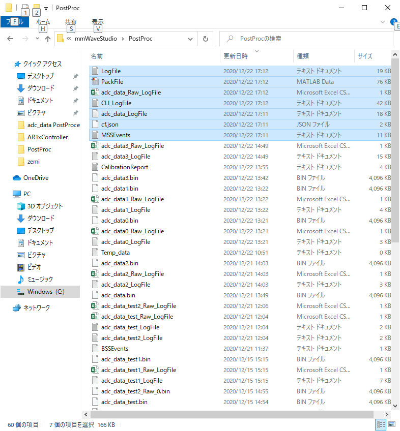

  • I'm sorry, the waveform was output.
    However, the raw data is not saved as a binary file.
    Why?
    The save destination is set as adc_data.bin in the following folder.
    The one in the blue line was saved when the raw data was acquired.

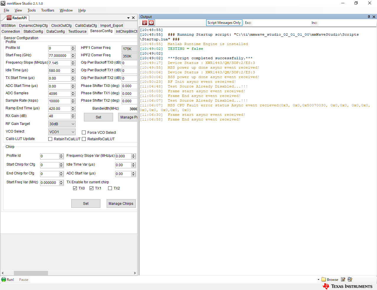

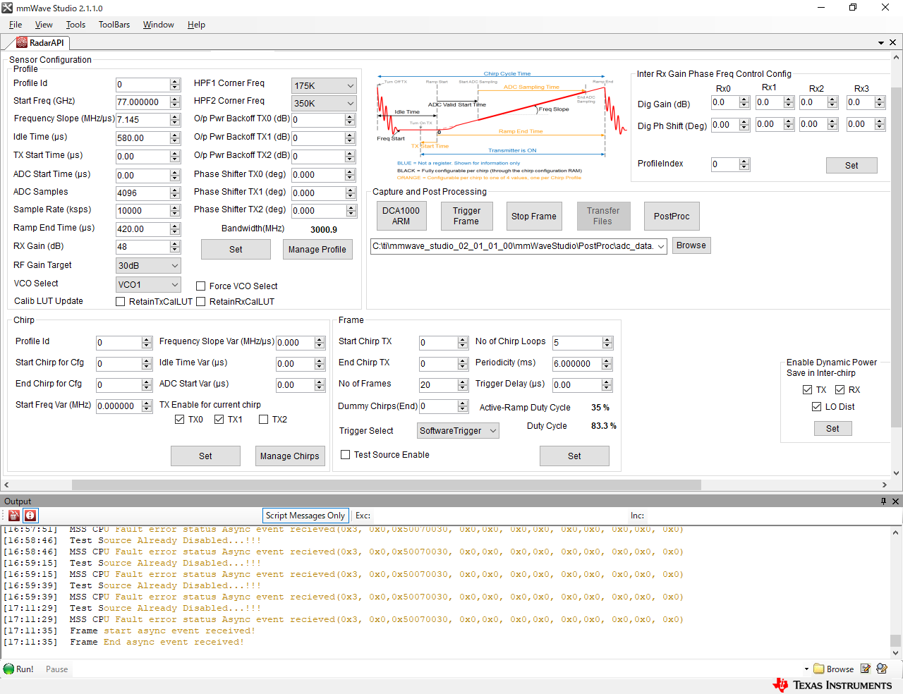

  • The studio log is here.
  • Hello User,
    What is the firmware version you're using? I see you're using SOP 2 here, but there is no log of firmware download. Also, there is no profile, chirp or data path configuration in your log.
    Could you please outline the exact sequence you're following to capture data here? Have you followed mmWave_studio_user_guide closely?
