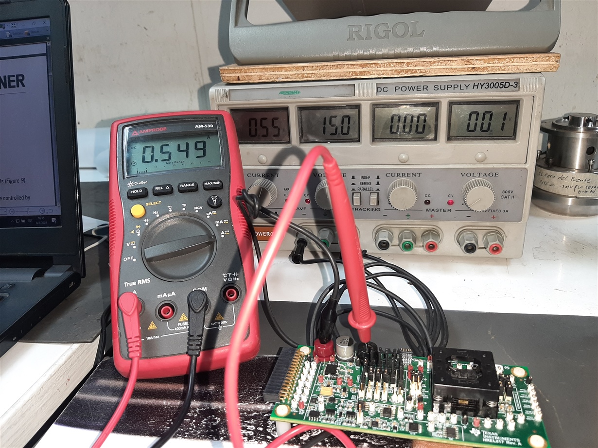

  • Hello Scott, thank you very much for answering, I only have the multimeter and the power supply connected, I do not have external elements that can consume current.
    I have this doubt regarding the failure in the EVM, because the consumption was always high, from the first time I turned it on.

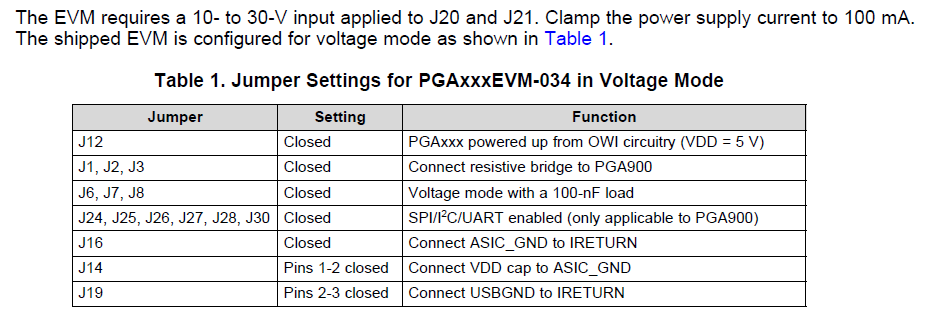

  • Hi Juan,
    As a sanity check, I suggest setting the jumpers to the default configuration described in the user's guide (shown below), disconnecting the USB2ANY, and removing the PGA900 from the EVM socket. Apply 15V to the inputs and see what the current draw is. If it is still in the range of 600mA there is something shorted to ground on the board-- possibly a faulty decoupling capacitor.
    If the current draw is high when the board is in the state described above, it certainly has a faulty component, and I would recommend requesting a replacement from the distributor that you bought the EVM from.
  • Hi Scott, sorry for the delay, do the test you indicated, I exceed 100mA, almost 600mA, U12 had temperature
  • Hi Juan,
    It does seem like your board is damaged in some way. I recommend requesting a replacement from the distributor that sold you the EVM. Please let me know if you have any issues with this.
