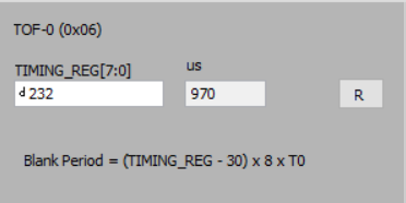

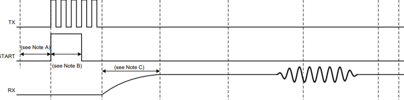

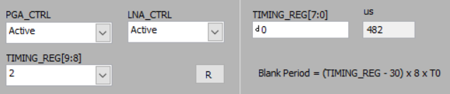

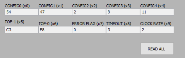

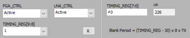

TDC1000: if TIMING_REG[bit9] could be configured 1 during blanking mode
Part Number: TDC1000
If the TIMING_REG[bit9] could be configured 1 during blanking mode?
Our customer configured the TIMING_REG[9:8]=01 or 11, the waiting time is same, for example, when configured  54 47 02 0b 11 c3 e8 03 03 02, bit 9 has no effect, so  if the TIMING_REG[bit9] could be configured 1?
