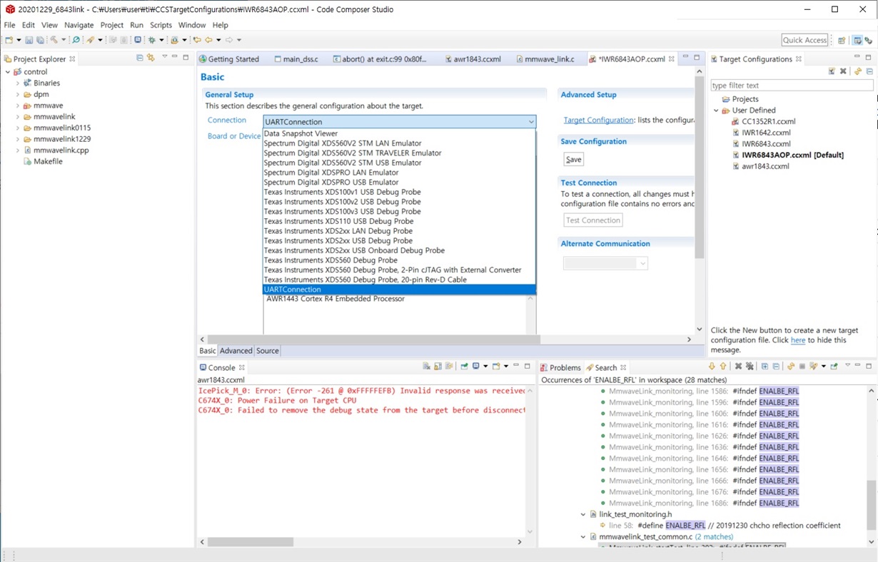

  • This is the setting I had here.
    I had connect PC with AOP demo board and I can see virtual USB connection in the following .
    Still I had same error in the following
    in Test Connection, I am not sure what I am doing wrong set.

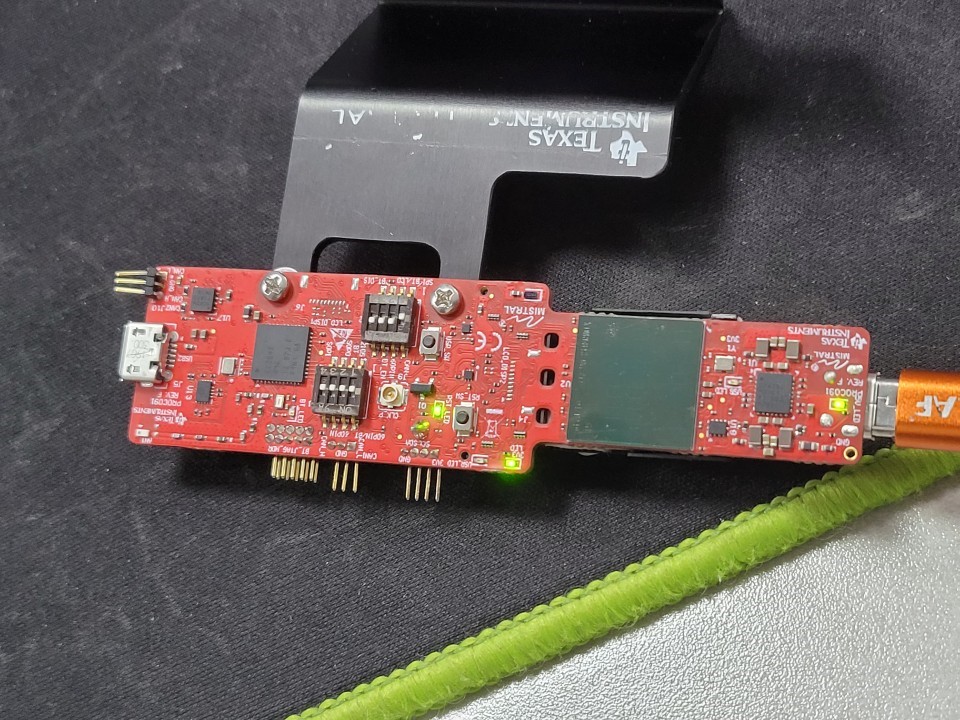

  • Hi Kisub
    Thank you for posting the picture. The IWR6843AOPEVM will need to be paired with mmWaveICBOOST mode and the on-board switches for both boards set appropriately. This is because IWR6843AOPEVM does not possess the on-board XDS110 Debugger.
