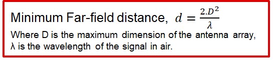

     Typically calibrations are done at zero angle azimuth & elevation.
    Zero-angle calibration refers to the correction applied on each receiver of the chip so that an object at bore-sight is interpreted as at zero-angle.
    It corrects (or estimates) the relative delay between the Rx paths. Depending on the placement and orientation of the antennas, the applied correction could be correcting either azimuth or elevation angle.
    The distance should be such that the corner reflector can be placed well in far-field zone. The formula given below can be used to calculate the far-field zone.
    If the reflector is very far then reflected signal strength would be weaker compared to clutter & reflections from other objects and cause erroneous calibration results.
    Hence, somewhere 1-3 meters would be ideal distance. Care need to be taken during the calibration strongest signal should be from the known corner reflector as compared to any other reflection in the scene.

  • As long as my corner reflector is placed in far-field zone and is the strongest reflective target, it will have a well calibration result.
    The size of the corner reflector does not affect any calibration results. Is this correct?
    How about the first and third questions above?
       Yes, If the corner reflector is placed in far-field zone and is the strongest reflective target then calibration would work well.
    Size of the corner reflector proportional to Radar cross section (RCS). Larger the size higher the RCS, Very large reflection might saturate the receiver, Hence care need to be taken such that Corner reflectors should not saturate the receivers.
