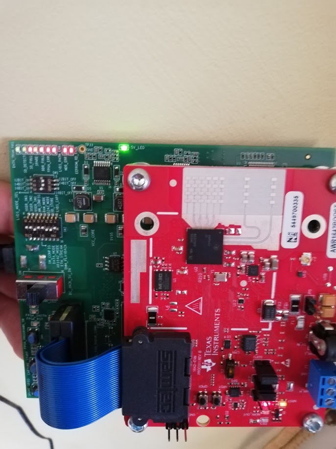

I have been trying to follow the training video for the DCA1000EVM and initially nearly got it working apart from receiving the data back to the PC at the end, but now for some reason, all of the lights along the top left-hand side of the DCA1000 card are on and it is not working at all. I can't find any information on why this would happen. I was wondering if anyone could help me.
  • Hello Charles,
    Let us start from the beginning. As you said, I'm assuming the board is being used for the first time.
    Please reset the board a couple of times and follow the procedure highlighted in the user guide step by step. Please let us know if you get stuck at some point.
    You can first start by checking the hardware connections. Make sure the power supplies are proper and of ample current rating as advised in the user guide and the USB's are properly connected to your PC (without any USB hub). Make sure you get the correct number of COM ports in the Device manager.
    You could send us a screenshot of that as well.
    Also, what is the FPGA firmware flashed in your DCA1000? Are you using the default firmware that came with the board? If not sure, it is better to upgrade it to the latest version.

  • Hello Charlie,
    Sorry for the delay. I was on leave for the second half of the previous week.
    - By resetting, I mean power cycling the board. Just turn off/on the power supply.
    - What is the Power supply you're using with the setup? If you're powering the DCA1000 board with the AWR device's 5V jack, You need a 5V power supply with atleast 4-5A current rating.
    - Also, what is the SOP mode you're using at the time of device startup?

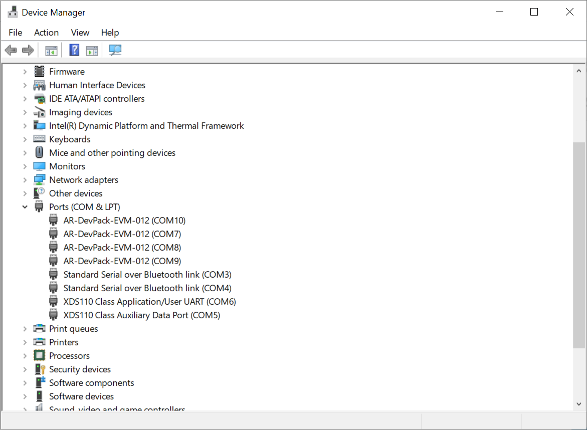

  • Hello Charlie,
    The COM ports appear correct in your screenshot. And the power supplies also seem fine.
    Are you connected to a Wi-Fi network? Sometimes that poses a problem for the ethernet connection. Please disconnect from your Wifi and try again.
    Ishita
