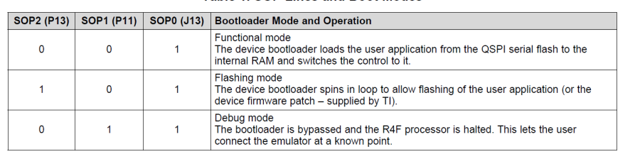

  • Hi Srikanth
    Please see the schematic for MMWAVEICBOOST on page 14 the SOP connections are listed. You'll want to connect SOP 0 and SOP 2 for flashing mode and be able to disconnect SOP 2 for device usage thereafter. Is this part clear?
    Your previous post says SOP 1 is connected to GND while SOP 1,2 are not connected, can you clarify?

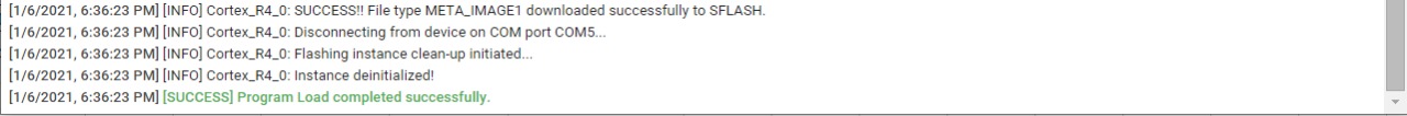

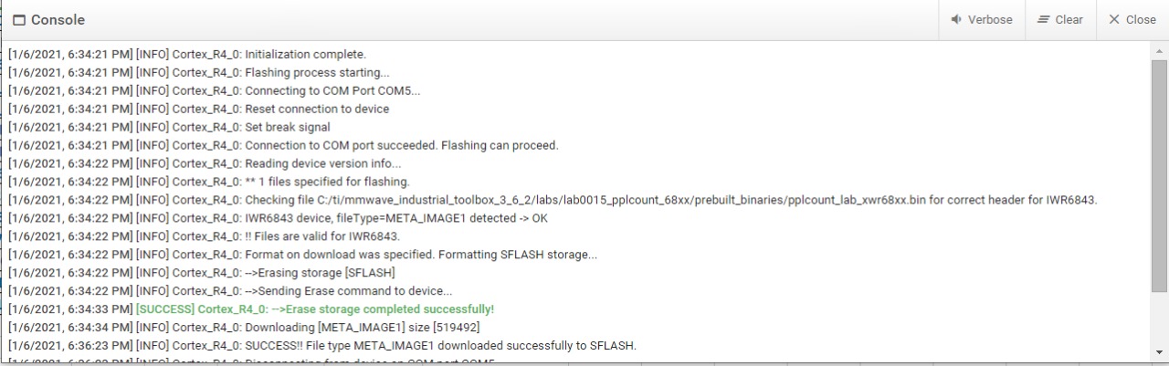

    1. Setup Board -1 (Includes Debugger with IWR6843 RF sensor)
    • I took 1 debugger board and 1 IWR6843 sensor.
    • Power on the Debugger using a 12V/1.5A power supply.
    • Plug in micro-usb and power supply to EVM using the connector
    • I have opened UniFlash tool, select the com port and bin file located in local drive.
    • In console window i have observed set break signal, i pressed the push button and release it. isthere any importent role for set break signal.
    • after release button, i am successfully able to flash the bin file into IWR6843.
    For your reference here i am attaching console window output.

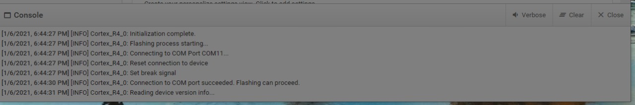

    2. Setup Board -2 (Includes Custom board and IWR6843 RF Sensor)
    • I have followed same steps above mentioned question 1. but i was not able to flash the bin file into IWR6843 sensor.
    • I have strcuked read information from device. for your reference i have attached console window output screenshot.

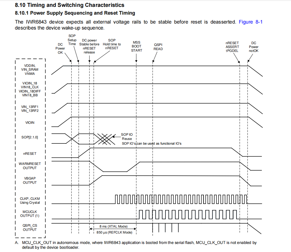

    3. Timing Diagram.
    • As per IWR6843 datasheet, i have checked timing diagram, I observed SOP[2, 1, 0] , nRESET and WARMRST is paying any role to swiched to flash mode to functional mode. or other then this 3 pins any pins requred to enter into the flash mode.
    • NERROR_IN and NRST pins are playing any import role. or any hand shaking is requred to wake up device and start the Flashing mode.
    • Here I have attached timing diagram for your reference.

  • Srikanth Katakam1 said:
    I meant to say, In flashing mode SOP[1] is connected to GND, and SOP[0,1] is No Connection(NC). it means Open. is my observation is correct or wrong?
    For flashing mode SOP[1] should connected to GND and nd SOP[0,1] should be pulled up not NC.
    Can you make this adjustment and confirm if you are able to flash now?
    Also not every USB to UART converter is supported on uniflash, if possible can you program an known working board using the USB to UART?
    Charles O
  • Yes, I was able to flash the bin file into IWR6843.
    Thanks for the update Charles.
    Srikanth
  • For Function mode, how to set the SOP pins can you elaborate as you explained in the previous message for flash mode. other than these SOP pins is there any pin is required to set the function mode. please do the needful.

  • Hello
    Would you be able to provide  the timing diagram for   SOP pins, Power supply rails, reset and clock pins of the device
    and confirm if these match the datasheet waves provided in the device Datasheet.
