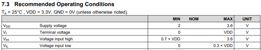

Hi,My lab want to use tdc7200evm for part of single photon detector.
Connect start with laser pulse and connect stop with avalanche pulse.
But,I can't figure out how big the avalanche pulse should I send to the tdc7200evm. I can only find the pulse width on the data sheet.
By the way,our avalanche pulse is usually at hundreds of mV. Maybe we need a amplifier.
