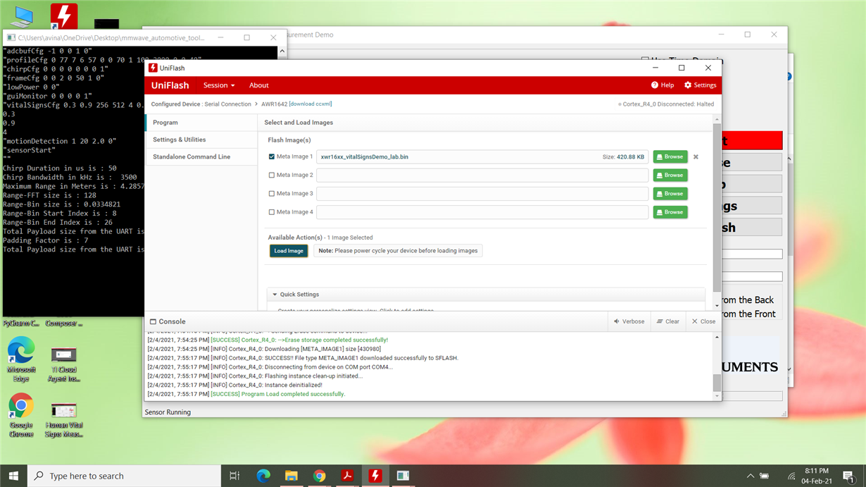

    1. flashing the xwr16xx_vitalSignsDemo_lab.bin with UniFlash succeeded. The Program Load completed successfully.
    2. The gui come up - C:\Users\danie\Desktop\Studium\Sensor auslesen\mmwave_automotive_toolbox_3_2_0\labs\incabinsensing\driver_vital_signs\vitalSigns_host\gui\gui_exe
    3. The uart port is visible at the gui.
    4. config in the DOS shows me: QMetaObject::connectSlotsByName: No matching signal for on_buttonBox_accepted()
    I`ve added some pictures of my steps below.
    If I press the start button at the gui, nothing happens.
    How can I have a look if the uart port is available for the gui?
    I tried it on a different PC. Handling with the same procedure and getting the same problem.

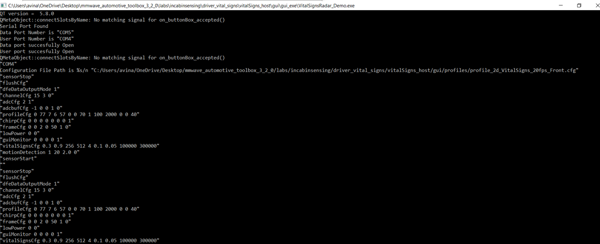

  • Hello
    Thank you for detailed steps -  essentially you are using the incabin+vital signs demo.
    Based on the last screenshot  com4 and com5 seem to be selected.  From the windows device manager what do the com4 and com5 show up as ?
    Also would you be able to confirm that on this board you have been able to run the OOB demo successfully.
    Thank you
    Vaibhav
    the ODS demo runs successfully, so I can detect some obstacles.
    The com ports at the device manager are showing in the pictuer below.
    Thank you,
    Daniel
