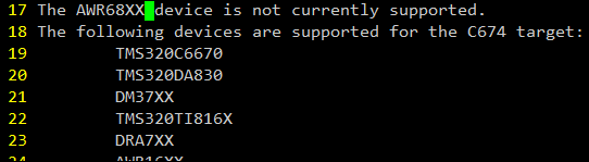

  • Hi Nitin,
       Thank you for the reply.
    With the help of migration document, i am able to port from xwr1642 to xwr6843, but when I try to build the dss, I get an error.
    Kindly find the attachment file for error log.
    Thanks and regards,
    Vijaya Krishna.

  • Hi Vijay,
    Please compare your DSS projectspec with the one given in the Occupancy and Vital Signs Detection demo referenced above and check that the device ID matches as given below.
    device="IWR6843"
    Additionally, please make sure you are using CCS 8.3.1 or above.
    -Nitin
  • Vijay,
    Confirming what I mentioned above, I notice in your error log that you are using AWR6843. Please change it to IWR6843 as mentioned above and this error should be resolved.
    -Nitin

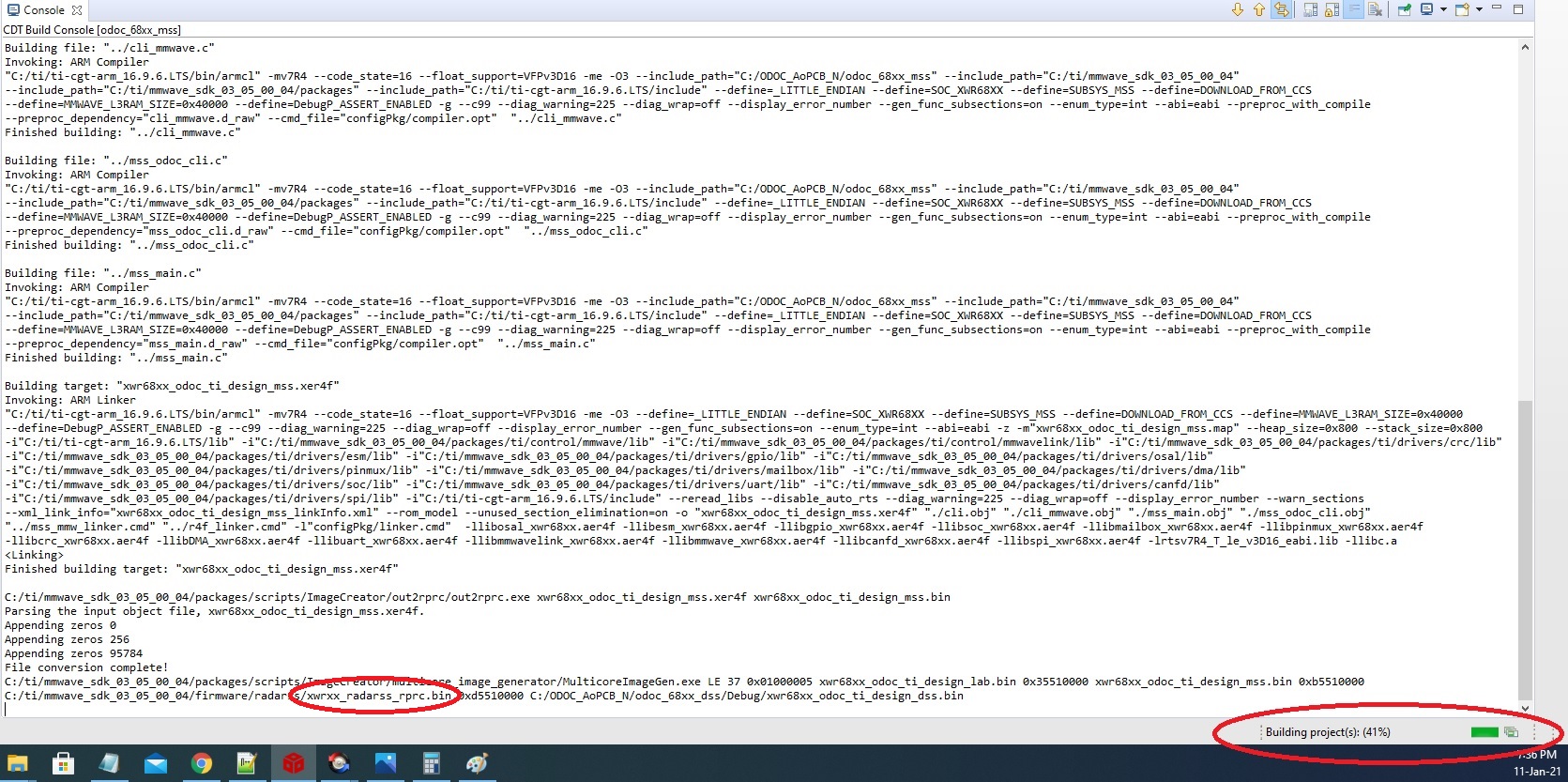

  • Nitin,
    I can able to build DSS project after changing platform from AWR6843 to IWR6843,
    but still facing build issues in MSS project. I have attached the screenshot, build hangs at 41%.
  • Hi Vijay,
    There appears to be a typo in your mss projectspec postbuild steps. The RadarSS firmware filename is incorrect as highlighted below which causes the metaimage generator to hang. This should be xwr6xxx_radarss_rprc.bin. Please double check the rest of the post build step commands to make sure there are no errors in those.
    -Nitin

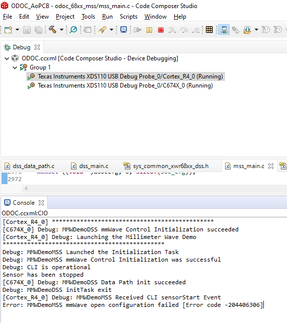

  • Nitin,
    Thanks, I am able to build MSS project and running demo application in debug mode but encounter the below error.
    Vijay
  • Hi Vijay,
    You can decode this error by following the instructions in the following training.
    Easy evaluation and development of mmWave systems with software development kit - Section "Software Development and Debugging". Look at slide 46 (mmWave Errors)
    Please note that since the demo you're porting does not print out the mmWave and Subsystem errors separately, but the bitmap is still the same as given in this slide so you can extract the error accordngly. You can also call MMWave_decodeError on this error in the code to print out the error components separately and then follow the example provided in the above slide. Yyou can refer to the out of box demo code to understand how to call MMWave_decodeError.
    -Nitin
