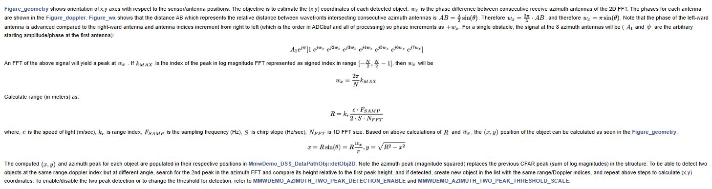

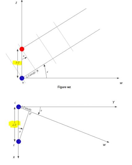

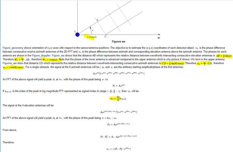

    Here is some information. The MRR demo is based on an early version of the mmwave SDK demo. Information below is taken from the SDK demo information
    It is just at end of the chain, when we calculate the angle. Instead of hard coded ratio between d and lambda,(d being distance between the antennas) d/Lambda = 1/2. The actual value should be used.
    So we need to replace:
    Wz=pi*sin(phi) with  Wz=2*pi*d/lambda*sin(phi) and
    Wx=pi*sin(theta)*cos(phi), with Wx=2*pi*d/lambda*sin(theta)*cos(phi)
    This is referred in AOA , see in yellow below. So the equations should be appropriately corrected for x,y,z calculation.

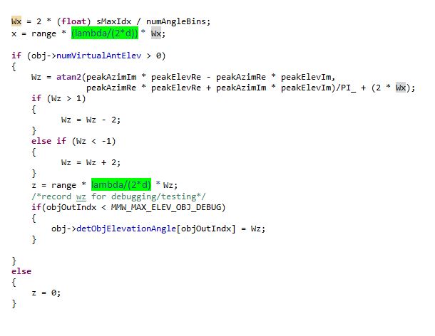

  • Hi Cesar,
    In my "mrr_18xx_dss project", browsing "dss_data_path.c" file:
    "void MmwDemo_interFrameProcessing(....)" calls "uint32_t aziEleProcessing(....)" and it call one of the functions below, that I suppose I should modify for my own Rx antenna separation.
    While the variables Wx and Wz are over there, the equations for their calculation differs from the one you sent me.
    void MmwDemo_XYcalc (.....)
       Wx = 2 * sMaxIdxFlt *obj->invNumAngleBins;
       x = range * Wx;
    void MmwDemo_XYZcalc (.....)
       x = range * Wx;
      Wz = (float) atan2sp(tempIm, tempRe) * (1.0f/PI_) ;
    Claudio

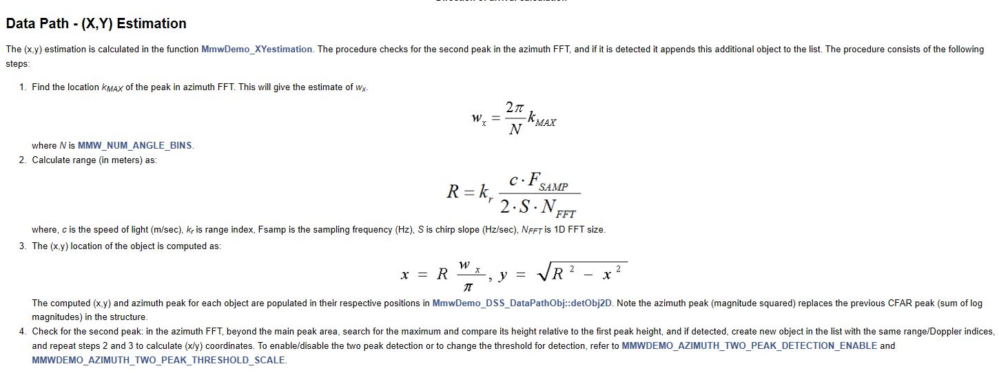

  • Hi Claudio,
    The MRR demo was originally based on SRR demo, which was based on an early version of the SDK.
    Here is what I have found in the SDK 1.05 documentation
    C:\ti\mmwave_sdk_01_00_00_05\packages\ti\demo\xwr16xx\mmw\docs\doxygen\html
    Does this help?
    If not I would have to check with original developer if available
    thank you
    Cesar
    It looks like the other graphs were added in the documentation for the following SDK release
    C:/ti/mmwave_sdk_01_01_00_02/packages/ti/demo/xwr16xx/mmw/docs/doxygen/html/index.html

    Please see updated code
    Thank you
    Cesar
  • Hi Cesar,
    That´s what I needed.
    Thank you
