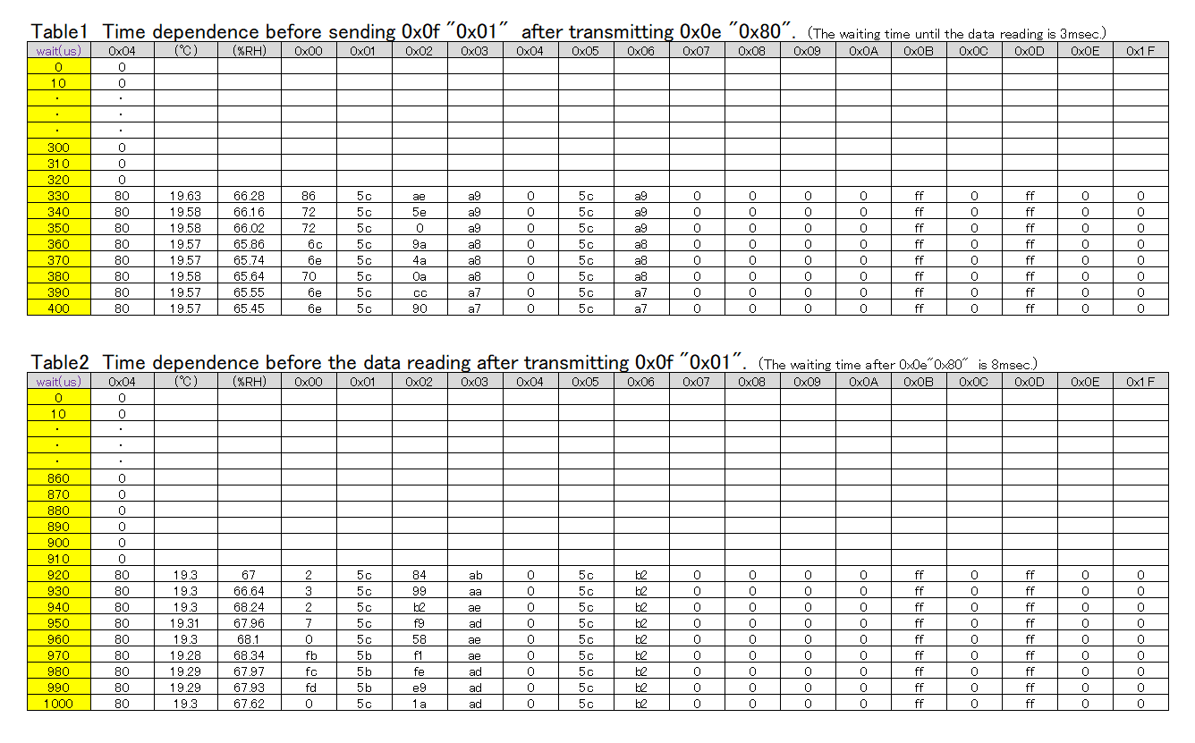

After the power supply injection, the case that humidity becomes 100%RH all the time sometimes occurs like a figure of the attachment. This case happens at the frequency once in about 30 times. In this case, the temperature changes with an appropriate value.
<control procedure>
Add 3.3V --(900msec)--> write 0x0e "0x80" --(8msec)--> 0x0f "0x01"  --(3msec)--> data read … wait…
 (repeat : 0x0f "0x01"  ----> data read … wait …)
I would like cooperation for cause investigation.

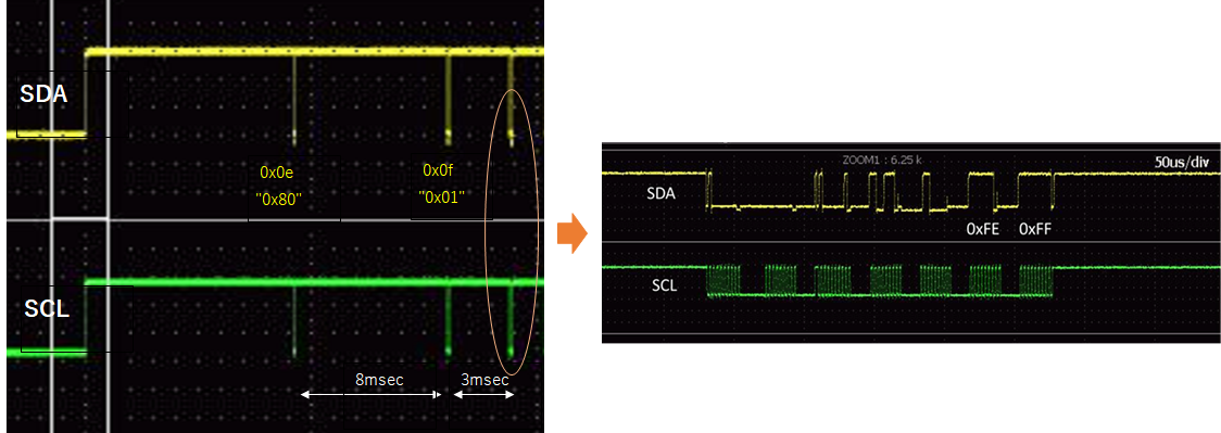

  • Hi,supports,
    As I was not able to attach a wave pattern of I2C, I send it.
    Toshi

    The waiting time after application of input voltage, before beginning any I2C transactions is 3mSec. Please see this FAQ regarding firmware handling of the HDC2010.
    https://e2e.ti.com/support/sensors/f/1023/t/878721
    In here I show the timings after power up and the resulting logic captures.

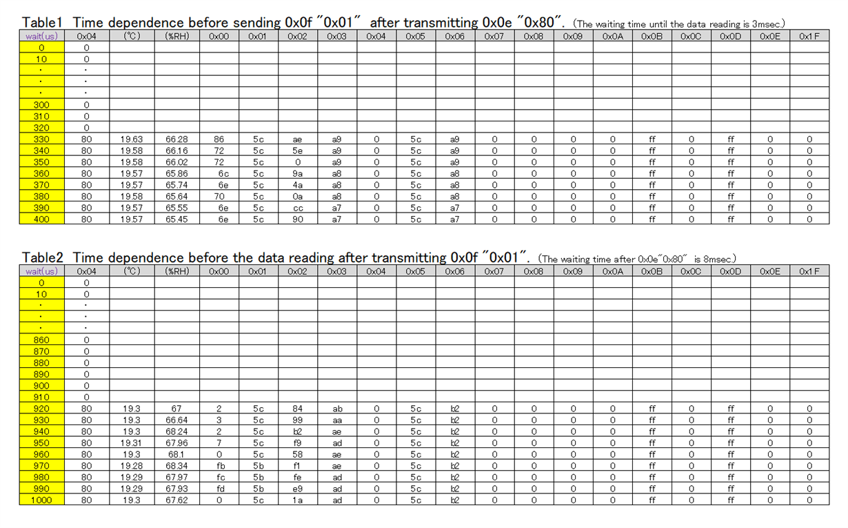

    3.3V is turned on before 900 msec to send a command.
    I confirmed the smallest limit time between commands.
    330usec and 920usec were limit time in this table.
    I think that the total of these time is equivalent to 1270usec.
    I have enough waiting time in comparison with the limit time.
    I am thinking that this trouble may occur in power-on reset process and asking these questions.
    Is there the precaution about the setup of the power supply?
    Please re-examine Qestion.1-3 based on my comments.
    Toshi

    At 14 bit resolution output setting, you need to wait at least 1300uSec (i use 1500uSec) waiting time before asking for data from the part. You can also read register 0x04 for 0x80 before reading registers 0x00 through 0x03 to make sure it is ready and you can also use the INT/DATA READY pin for redundancy.
    Also, I do not use the reset of the part in normal operation - I think it is a waste of clock cycles, you should consider to remove it.
    Please pay close attention to the FAQ. It was made specifically for this kind of question you are asking.
