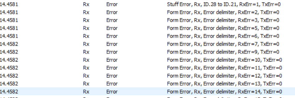

I am using classical CAN transmission under CANFD, but the data received by my CAN analyzer is wrong. Why?

  • I had to test the classic CAN with the CANFD driver.
    This part of the code needs to be compatible with the IWR6843 program, so you must use the CANFD driver.
    I write the code according to the CANFD test in SDK, and the Settings are all consistent.
    Why does this happen?
    Could you please provide more details how you are configuring CANFD driver for CAN mode.
    Are you implementing range RX object ?
    Yogesh

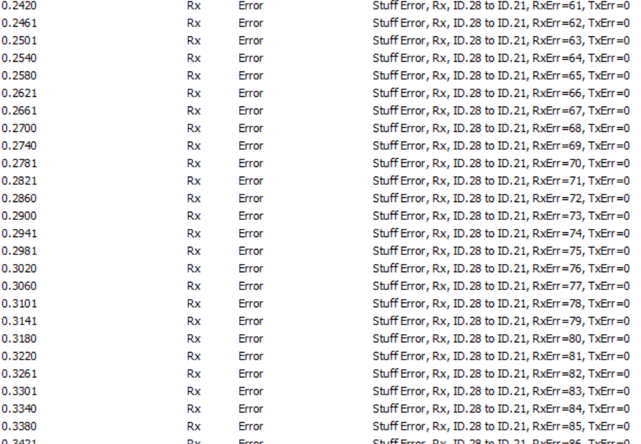

  • For CANFD Vs Classic CAN mode,  please disable these:
    mcanCfgParams->fdMode = 0x0U;
    mcanCfgParams->brsEnable = 0x0U;
    mcanCfgParams->darEnable = 0x0U;
  • I have made the modification as you said, but I still cannot receive the data.
    Is there anything else that needs to be set for using classic can?
    In addition, I saw optionTLV when I checked the test you wrote. Do I need to set it when I use classic can?
  • I printed the message of the sending function from the serial port, and found that the return value of the first frame was -1, and from the second frame, I returned -3502 error each time.
    Why is that?

    volatile uint32_t iterationCount = 0U;
    uint32_t dataLength = 0U;
    uint32_t msgLstErrCnt = 0U;
    uint32_t gDisplayStats = 0;
    uint8_t rxData[64U];
    uint32_t txDataLength, rxDataLength;
    // CANFD_MCANFrameType frameType = CANFD_MCANFrameType_FD;
    CANFD_MCANFrameType frameType = CANFD_MCANFrameType_CLASSIC;
    static void MCANAppInitParams(CANFD_MCANInitParams *mcanCfgParams);
    CANFD_Handle canHandle;
    CANFD_MsgObjHandle txMsgObjHandle;
    CANFD_MCANMsgObjCfgParams txMsgObjectParams;
    uint8_t canInstanceId = 0;
     *************************** Can functions ***************************
    static int32_t PlatformInit(void)
        /* Setup the PINMUX to bring out the XWR68xx CANFD pins */
        Pinmux_Set_OverrideCtrl(SOC_XWR68XX_PINE14_PADAE, PINMUX_OUTEN_RETAIN_HW_CTRL, PINMUX_INPEN_RETAIN_HW_CTRL);
        Pinmux_Set_FuncSel(SOC_XWR68XX_PINE14_PADAE, SOC_XWR68XX_PINE14_PADAE_CANFD_TX);
        Pinmux_Set_OverrideCtrl(SOC_XWR68XX_PIND13_PADAD, PINMUX_OUTEN_RETAIN_HW_CTRL, PINMUX_INPEN_RETAIN_HW_CTRL);
        Pinmux_Set_FuncSel(SOC_XWR68XX_PIND13_PADAD, SOC_XWR68XX_PIND13_PADAD_CANFD_RX);
        /* Setup the PINMUX to bring out the XWR68xx CANFD-2 pins */
        Pinmux_Set_OverrideCtrl(SOC_XWR68XX_PINE15_PADAG, PINMUX_OUTEN_RETAIN_HW_CTRL, PINMUX_INPEN_RETAIN_HW_CTRL);
        Pinmux_Set_FuncSel(SOC_XWR68XX_PINE15_PADAG, SOC_XWR68XX_PINE15_PADAG_CANFD2_TX);
        Pinmux_Set_OverrideCtrl(SOC_XWR68XX_PINE13_PADAF, PINMUX_OUTEN_RETAIN_HW_CTRL, PINMUX_INPEN_RETAIN_HW_CTRL);
        Pinmux_Set_FuncSel(SOC_XWR68XX_PINE13_PADAF, SOC_XWR68XX_PINE13_PADAF_CANFD2_RX);
        // Set gpio_1 up to select canfd mux for can on mistral module
        Pinmux_Set_OverrideCtrl(SOC_XWR68XX_PINJ13_PADAC, PINMUX_OUTEN_RETAIN_HW_CTRL, PINMUX_INPEN_RETAIN_HW_CTRL);
        Pinmux_Set_FuncSel(SOC_XWR68XX_PINJ13_PADAC, SOC_XWR68XX_PINJ13_PADAC_GPIO_1);
        GPIO_setConfig (SOC_XWR68XX_GPIO_1, GPIO_CFG_OUTPUT);
        // //write low to gpio_1
        GPIO_write (SOC_XWR68XX_GPIO_1, 0U);
        return 0;
    void Can_Initalize(void)
        int32_t errCode = 0;
        int32_t retVal = 0;
        CANFD_MCANInitParams mcanCfgParams;
        CANFD_MCANBitTimingParams mcanBitTimingParams;
        CANFD_MCANMsgObjCfgParams rxMsgObjectParams;
        CANFD_MsgObjHandle rxMsgObjHandle;
        gTxDoneFlag = 0;
        gRxDoneFlag = 0;
        /* Setup the PINMUX to bring out the XWR16xx CAN pins */
        PlatformInit();
        /* Configure the divide value for MCAN source clock */
        SOC_setPeripheralClock(gMmwMssMCB.socHandle, SOC_MODULE_MCAN, SOC_CLKSOURCE_VCLK, 4U, &errCode);
        /* Initialize peripheral memory */
        SOC_initPeripheralRam(gMmwMssMCB.socHandle, SOC_MODULE_MCAN, &errCode);
        MCANAppInitParams(&mcanCfgParams);
        /* Initialize the CANFD driver */
        canHandle = CANFD_init(canInstanceId, &mcanCfgParams, &errCode);
        if (canHandle == NULL)
            System_printf("Error: CANFD Module Initialization failed [Error code %d]\n", errCode);
            return;
        /* Configuring 1Mbps and 5Mbps as nominal and data bit-rate respectively
        Prop seg: 8
        Ph seg 1: 6
        Ph Seg2 : 5
        Sync jump: 1
        BRP(Baud rate Prescaler): 2
        Nominal Bit rate = (40)/(((8+6+5)+1)*BRP) = 1Mhz
        Timing Params for Data Bit rate:
        Prop seg: 2
        Ph seg 1: 2
        Ph Seg2 : 3
        Sync jump: 1
        BRP(Baud rate Prescaler): 1
        Nominal Bit rate = (40)/(((2+2+3)+1)*BRP) = 5Mhz
        mcanBitTimingParams.nomBrp      = 0x2U;
        mcanBitTimingParams.nomPropSeg  = 0x8U;
        mcanBitTimingParams.nomPseg1    = 0x6U;
        mcanBitTimingParams.nomPseg2    = 0x5U;
        mcanBitTimingParams.nomSjw      = 0x1U;
        /*5MHz*/
        mcanBitTimingParams.dataBrp     = 0x1U;
        mcanBitTimingParams.dataPropSeg = 0x2U;
        mcanBitTimingParams.dataPseg1   = 0x2U;
        mcanBitTimingParams.dataPseg2   = 0x3U;
        mcanBitTimingParams.dataSjw     = 0x1U;
        /* Configure the CAN driver */
        retVal = CANFD_configBitTime(canHandle, &mcanBitTimingParams, &errCode);
        if (retVal < 0)
            System_printf("Error: CANFD Module configure bit time failed [Error code %d]\n",
                          errCode);
            return;
        /* Setup the transmit message object */
        txMsgObjectParams.direction = CANFD_Direction_TX;
        txMsgObjectParams.msgIdType = CANFD_MCANXidType_29_BIT;
        txMsgObjectParams.msgIdentifier = 0xD1;
        txMsgObjHandle = CANFD_createMsgObject(canHandle, &txMsgObjectParams, &errCode);
        if (txMsgObjHandle == NULL)
            System_printf("Error: CANFD create Tx message object failed [Error code %d]\n",
                          errCode);
            return;
        /* Setup the receive message object */
        rxMsgObjectParams.direction = CANFD_Direction_RX;
        rxMsgObjectParams.msgIdType = CANFD_MCANXidType_29_BIT;
        rxMsgObjectParams.msgIdentifier = 0xD1;
        rxMsgObjHandle = CANFD_createMsgObject(canHandle, &rxMsgObjectParams, &errCode);
        if (rxMsgObjHandle == NULL)
            System_printf("Error: CANFD create Rx message object failed [Error code %d]\n",
                          errCode);
            return;
    static void MCANAppCallback(CANFD_MsgObjHandle handle, CANFD_Reason reason)
        int32_t errCode, retVal;
        uint32_t id;
        CANFD_MCANFrameType rxFrameType;
        CANFD_MCANXidType rxIdType;
        if (reason == CANFD_Reason_TX_COMPLETION)
                gTxPkts++;
                gTxDoneFlag = 1;
                return;
        if (reason == CANFD_Reason_RX)
                /* Reset the receive buffer */
                memset(&rxData, 0, sizeof(rxData));
                dataLength = 0;
                retVal = CANFD_getData(handle, &id, &rxFrameType, &rxIdType, &rxDataLength,
                                       &rxData[0], &errCode);
                if (retVal < 0)
                    System_printf ("Error: CAN receive data for iteration %d failed [Error code %d]\n", iterationCount, errCode);
                    return;
                if (rxFrameType != frameType)
                    System_printf ("Error: CAN received incorrect frame type Sent %d Received %d for iteration %d failed\n", frameType, rxFrameType, iterationCount);
                    return;
                /* Validate the data */
                gRxPkts++;
                gRxDoneFlag = 1;
                return;
        if (reason == CANFD_Reason_TX_CANCELED)
                gTxPkts++;
                gTxDoneFlag = 1;
                gRxDoneFlag = 1;
                return;
    static void MCANAppErrStatusCallback(CANFD_Handle handle, CANFD_Reason reason,
                                         CANFD_ErrStatusResp *errStatusResp)
        /*Record the error count */
        gErrStatusInt++;
        return;
        /*Intialize MCAN Config Params*/
        memset(mcanCfgParams, sizeof(CANFD_MCANInitParams), 0);
        mcanCfgParams->fdMode          = 0x1U;
        mcanCfgParams->brsEnable       = 0x1U;
        mcanCfgParams->txpEnable       = 0x0U;
        mcanCfgParams->efbi            = 0x0U;
        mcanCfgParams->pxhddisable     = 0x0U;
        mcanCfgParams->darEnable       = 0x1U;
        mcanCfgParams->wkupReqEnable   = 0x1U;
        mcanCfgParams->autoWkupEnable  = 0x1U;
        mcanCfgParams->emulationEnable = 0x0U;
        mcanCfgParams->emulationFAck   = 0x0U;
        mcanCfgParams->clkStopFAck     = 0x0U;
        mcanCfgParams->wdcPreload      = 0x0U;
        mcanCfgParams->tdcEnable       = 0x1U;
        mcanCfgParams->tdcConfig.tdcf  = 0U;
        mcanCfgParams->tdcConfig.tdco  = 8U;
        mcanCfgParams->monEnable       = 0x0U;
        mcanCfgParams->asmEnable       = 0x0U;
        mcanCfgParams->tsPrescalar     = 0x0U;
        mcanCfgParams->tsSelect        = 0x0U;
        mcanCfgParams->timeoutSelect   = CANFD_MCANTimeOutSelect_CONT;
        mcanCfgParams->timeoutPreload  = 0x0U;
        mcanCfgParams->timeoutCntEnable= 0x0U;
        mcanCfgParams->filterConfig.rrfe        = 0x1U;
        mcanCfgParams->filterConfig.rrfs        = 0x1U;
        mcanCfgParams->filterConfig.anfe        = 0x1U;
        mcanCfgParams->filterConfig.anfs        = 0x1U;
        mcanCfgParams->msgRAMConfig.lss         = 127U;
        mcanCfgParams->msgRAMConfig.lse         = 64U;
        mcanCfgParams->msgRAMConfig.txBufNum    = 32U;
        mcanCfgParams->msgRAMConfig.txFIFOSize  = 0U;
        mcanCfgParams->msgRAMConfig.txBufMode   = 0U;
        mcanCfgParams->msgRAMConfig.txEventFIFOSize         = 0U;
        mcanCfgParams->msgRAMConfig.txEventFIFOWaterMark    = 0U;
        mcanCfgParams->msgRAMConfig.rxFIFO0size             = 0U;
        mcanCfgParams->msgRAMConfig.rxFIFO0OpMode           = 0U;
        mcanCfgParams->msgRAMConfig.rxFIFO0waterMark        = 0U;
        mcanCfgParams->msgRAMConfig.rxFIFO1size             = 64U;
        mcanCfgParams->msgRAMConfig.rxFIFO1waterMark        = 64U;
        mcanCfgParams->msgRAMConfig.rxFIFO1OpMode           = 64U;
        mcanCfgParams->eccConfig.enable         = 1;
        mcanCfgParams->eccConfig.enableChk      = 1;
        mcanCfgParams->eccConfig.enableRdModWr  = 1;
        mcanCfgParams->errInterruptEnable   = 1U;
        mcanCfgParams->dataInterruptEnable  = 1U;
        mcanCfgParams->appErrCallBack       = MCANAppErrStatusCallback;
        mcanCfgParams->appDataCallBack      = MCANAppCallback;
    int32_t Can_Transmit_Schedule( uint32_t msg_id,
                uint8_t *txmsg, uint32_t len)
        volatile uint32_t                     index = 0;
        int32_t                     retVal = 0;
        //System_printf ("MEssage %x  len %d\n", msg_id, len);
        if(frameType == CANFD_MCANFrameType_FD)
            Task_sleep(1);
            while(len > 64U)
                retVal = CANFD_transmitData (txMsgObjHandle, msg_id, CANFD_MCANFrameType_FD, 64U, &txmsg[index], &errCode);
                index = index + 64U;
                len = len - 64U;
                Task_sleep(1);
            retVal = CANFD_transmitData (txMsgObjHandle, msg_id, CANFD_MCANFrameType_FD, len, &txmsg[index], &errCode);
        else
            while(len > 8U)
                retVal = CANFD_transmitData (txMsgObjHandle, msg_id, CANFD_MCANFrameType_CLASSIC, 8U, &txmsg[index], &errCode);
                if (retVal < 0)
                    continue;
                index = index + 8U;
                len = len - 8U;
            retVal = CANFD_transmitData (txMsgObjHandle, msg_id, CANFD_MCANFrameType_CLASSIC, len, &txmsg[index], &errCode);
            while(retVal < 0)
                //System_printf("Debug: Error transmitting CAN data %x , Errcode %x\n", retVal, errCode);
        return retVal;
    Error -3502 mean the CAN is in use. Could you please confirm you are initializing MCAN clock:
     SOC_setPeripheralClock(gSblMCB.socHandle, SOC_MODULE_MCAN, SOC_CLKSOURCE_VCLK, 4U, &errCode);
    Yogesh
  • Thank you very much for your advice.
    After I add this statement, the CAN analyzer can receive the data.
