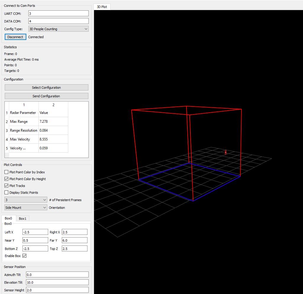

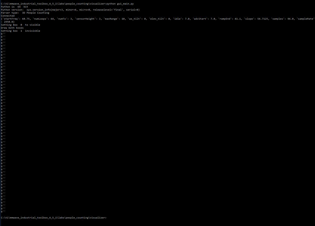

  • Hey Jackson,
    so we was able to flash the board. We went through the User's Guide. In "4. Run the Lab" we followed the instructions in the visualizer folder. We were able to install the mmWave_People_Counting_GUI.
    We could open and configure the Visualizer. It also said connected to the Port Com. But when we launched the Visualizer by clicking Send Configuration, we did not get any Frames.

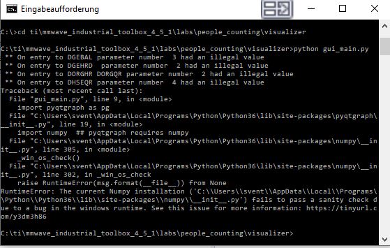

    In the developers Guide it says Python 3.6 64 Bit is requiered. So we also downloaded it installed the librarieres by using the setupEnvironment.bat.
    So we thought we were ready to go after all this. But still we do not get any frames in the visualizer. We also looked up if everything was downloaded and installed properly. But everthing was on place.
    Also the command "Python gui_main.py" did not word. (There is a picture below of the error message    )
    Sven

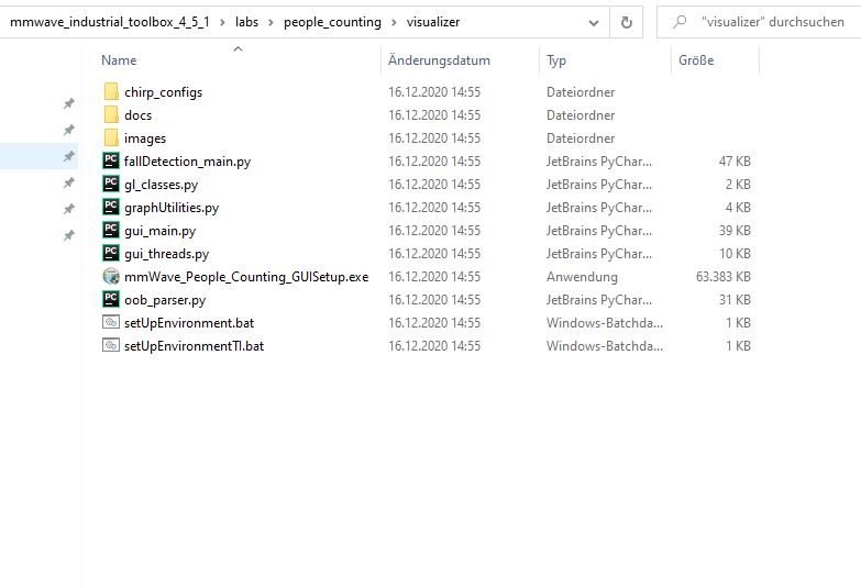

  • Hi Sven,
    The visualizer requires a specific cfg file for each binary file loaded on the sensor. Can you confirm which .bin file you loaded and which .cfg file you selected? They both need to be for the 3D people counting. The other issue can be using an older version of the toolbox, but I see you are using 4.5.1.
    You shouldn't need a python installation to run the .exe, it should install with all dependencies. But running the gui from python source code may help to find the issue. From your cmd window error, it seems the numpy package might need to be updated. Can you try the following command and see if it changes?
    'pip install numpy -U'
    Jackson
  • Hey Jackson,
    I am not sure how i can see which cfg file i loaded on the sensor. Do you mean the image i flashed on the sensor? We used the "3D_people_count_68xx_demo.bin" for the sensor.
    Your command worked! Now i can open it without the error! Nice! But i also get any frames there ...
    Sven
  • Great!
    You must first use the 'select configuration' button before sending it to the device. Which .cfg file are you selecting when pressing this button? If you can post the cmd window output when running from python source that might help.
    Jackson
  • I use the "ISK_6m_default.cfg" from the 3D_people_Counting folder
  • Hi Sven,
    It seems that the device is not responding when you send the cfg file. Can you confirm that the ISK board has been put back into operational mode after flashing it? And has it been reset? And the COM port numbers are still correct? If so please try re-flashing the device as something may have gone wrong.

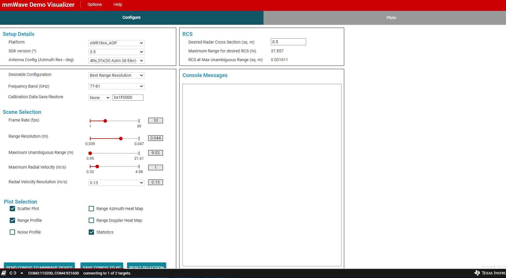

  • You are using the IWR6843ISK board correct? Make sure you choose the 6843 platform in the OOB visualizer.
    Also, one image you had showed you are using the ICBOOST board. Which revision of the IWR6843ISK board do you have? The recent ones are able to connect to the GUI by itself. Have you tried using this board standalone? This would help to isolate the problem and verify the sensor is working.
    Jackson
  • Hey Jackson,
    The one picture was misstaken. I always selected the XWR68XX in the OOB visualizer. I just forgot to do it for the picture...
    We are getting closer. The sensor is working perfectly fine without the MMWAVEICBOOST. It gave no errors while flashing and the out-of-box demo worked perfecly!

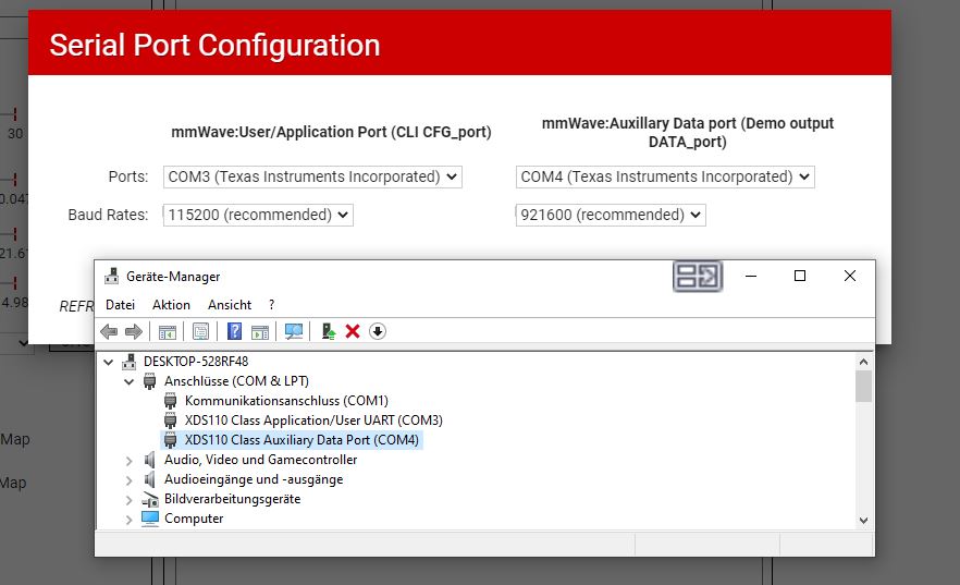

  • Hi Sven,
    Are you certain you are unplugging both the barrel jack power and USB cable from the sensor before trying to connect and flash with uniflash? This sounds like similar issues we see when flashpythonsubprocess gets hung up. If you are reconnecting the USB every time, try killing the flashpythonsubprocess.exe process from task manager. See the post below for more information.
  • Hey Jackson,
    Jeah i always unplug the barrel jack power and the USB cable. But just to be sure I made a video of the whole process. Maybe you can see if I am doing anything incorrectly.
    Is this the right link? Because you didn't mention anything about Baudrate in your last reply. But is it still important for our error?
    I also tried to kill the flashpythonsubprocess.exe from the task manager. It only showed up once. After i killed it, the Console told me after 1/2 s that everything is uploaded. I doubt that it uploaded everything correctl in his short time. After this, the flashpythonsubprocess.exe never showed up again in the Task manager.
    Sven

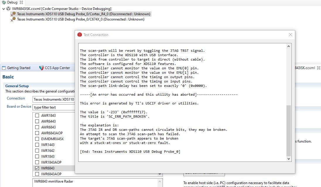

  • Hey Jackson,
    I also flashed the xwr68xx_ccsdebug.bin image now on the device so i can work over the debugger.
    But when i want to test the connection to my device i always get this error:
    Do you know the reason for this?
    Sven
  • Hi Sven,
    1. To start the sensor without using the visualizer there a a couple options. You could write a simple new program that would only send the UART data from the .cfg file needed to start the sensor. Or you can use a 'hard coded config' setup. This would add the cfg parameters in the source code for the device. There is an example here and some documentation on the CLI bypass in the following SDK documentation.
    file:///C:/ti/mmwave_sdk_03_05_00_04/packages/ti/demo/xwr68xx/mmw/docs/doxygen/html/index.html
    2. There will be a UART data stream coming over the COM port with or without the visualizer. If you open a teraterm or putty session and select the COM port you should see the data streaming in. This will show you the sensor is working and tracking, but you will likely need a program to parse and interpret the data to make sense of it.
    3. Does the error above prevent you from debugging or flashing new code? Or does it only show up when testing the connection?
