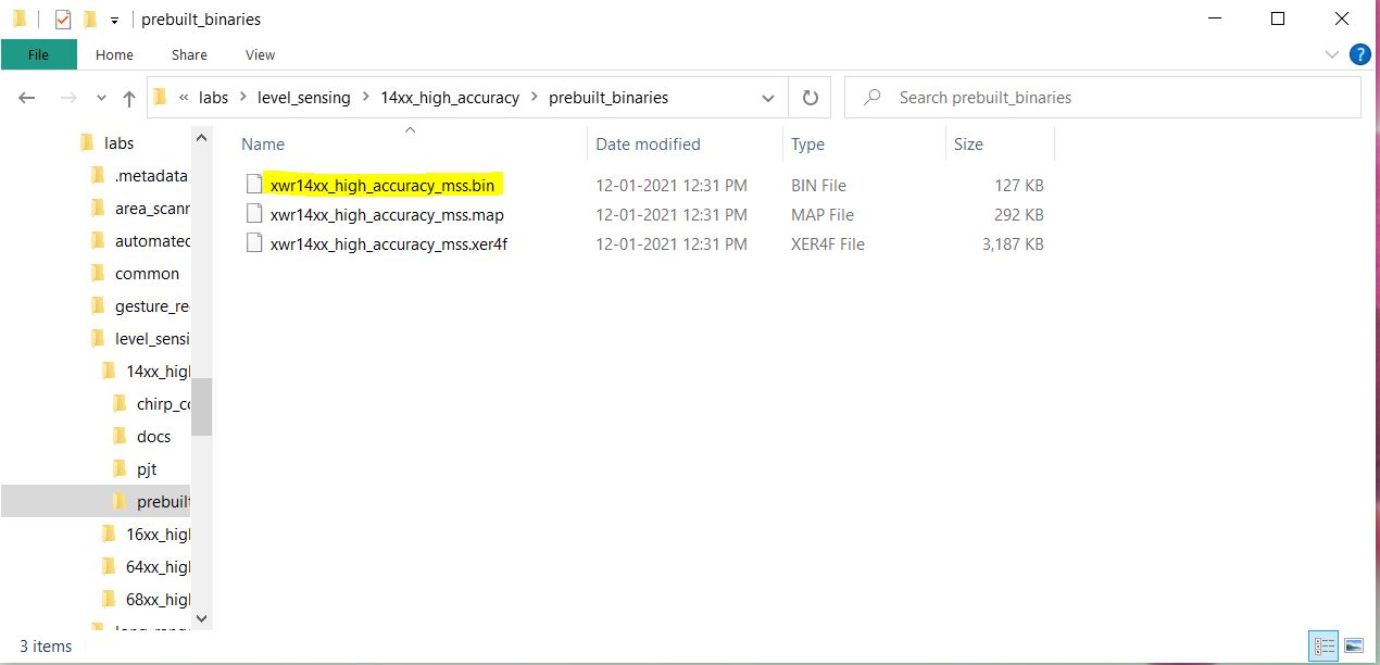

This is Guru, i am working on mm wave IWR1443 ES2.0 EVM module. i want to run fluid level transmitter demo on this. i have flashed SDK Version 1.2 using uni flash and installed industrial tool box - 4.5.1. Now i wanted to flash this xwr14xx_high_accuracy_mss.bin  image but i am getting this error Cortex_R4_0: !!! Aborting flashing of specified files!!!. Below are screen shots. Please help how to proceed further.

  • Hi Gururaj
    You should be using IWR1443BOOST with ES 3.0 for this project, this has been the active silicon revision for more than two years now.
    If you want to run using your ES2.0 EVM you will want to flash the binaries as per the instructions in a prior Industrial Toolbox, should be 3.6.1 or earlier. Though please keep in mind we do not support IWR1443 ES2.0 and recommend you upgrade.
