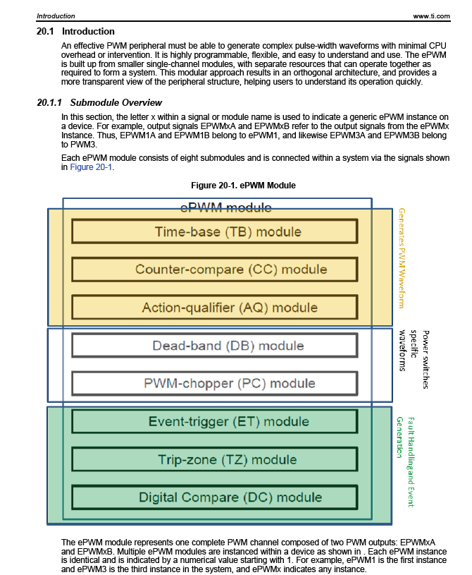

    Does the IWR1443 need an external MCU for this application? Would if be possible to output a PWM signal from one of the IWR1443 pins which could drive an RC circuit into an op amp to make a 4-20mA drive circuit?

  • Hi Joshua
    I can confirm device does have PWM capability and it can drive a 4-20mA circuit, though there are currently no software drivers for running PWM. Please see the Technical Reference Manual  for more details.
    Also this app note please see this app note for more info on 4-20mA implementation.
