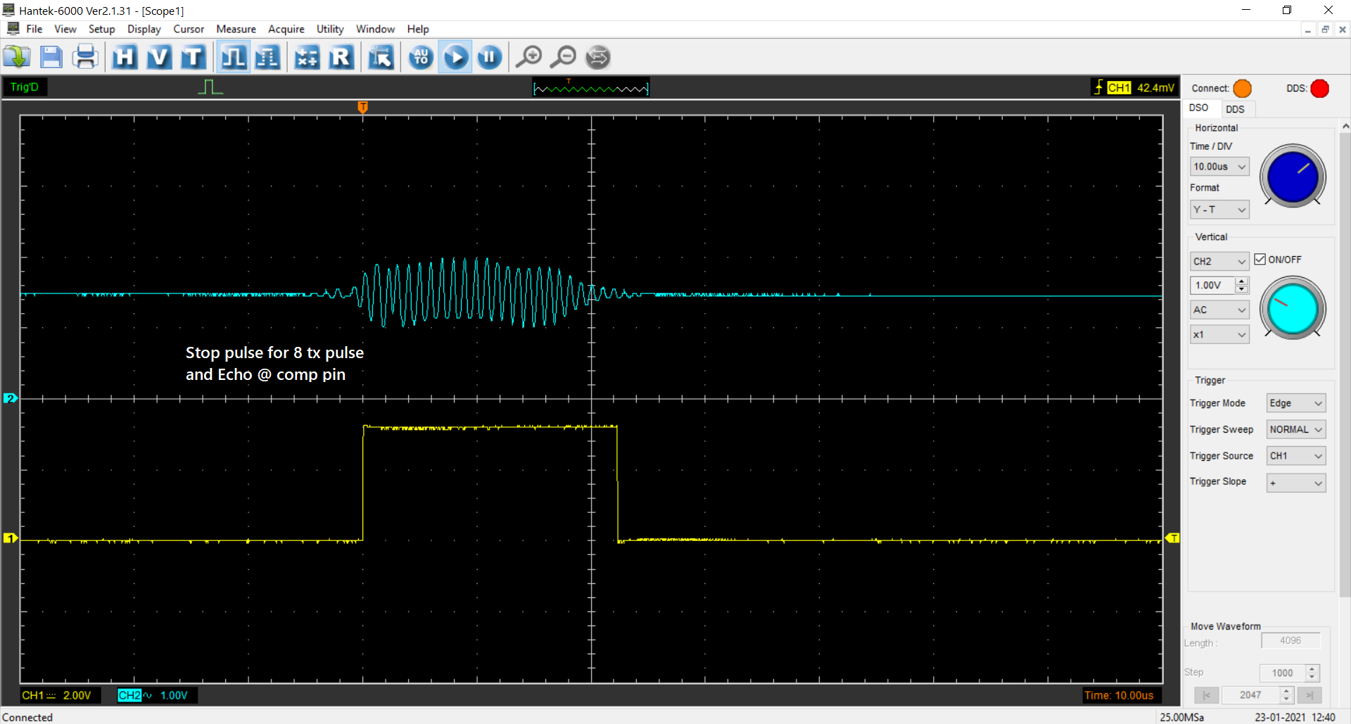

    Below I have given the snap shot of schematics and the waveforms. We have tested up to 203cm, we could able to get water level but some time we get time out and the time out timer value is 2708 uS.  We have taken the waveform from the actual product when it is floating in the water.
    TX and RX waveforms look okay. It looks like the schematic did not upload correctly.
    As seen below in the standard ToF diagram, the TIMING_REG and TOF_TIMEOUT_CTRL control the echo-listen period. In these tests, is your device set to stop listening around 2708 us? That is very close to the expected ToF from a 203cm test. What is the recorded ToF when the 203cm test is successful?
