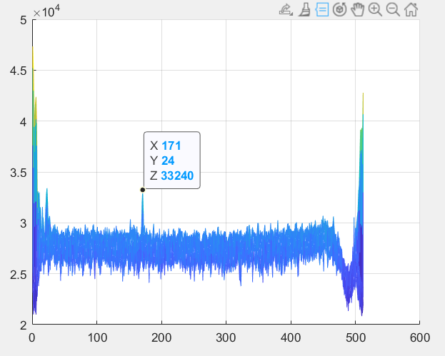

Team,
Customer is seeing the peak below, when testing our boost EVM:
What is the cause of this peak?
The frequency of this peak is about 3.18MHz on the board we designed. Are there any frequency components on the board that might cause this peak?
We use the same PMIC and same power structure as the TI 1843Boost EVM.
