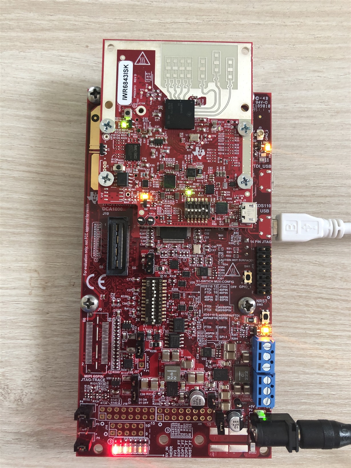

we have the Board MMWAVEICBOOST in combination with the IWR6843ISK. We've been using the 3D people counting 68XX-Demo application from the industrial toolbox. So far we had always managed to flash the device, but after downgrading the software version as specified in XDS110_firmware_downgrade.pdf from the user's guide, we haven't been able to flash the device anymore. Even after trying a different binary.

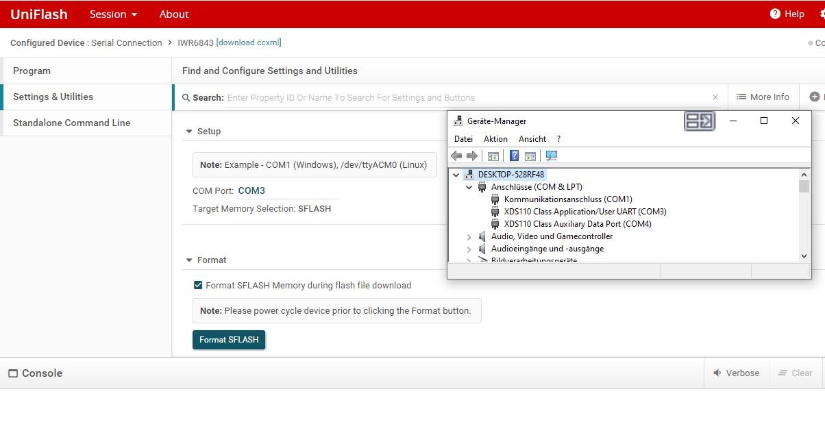

  1. Please make sure that you have set the right SOP jumper (SOP0 and SOP2) on EVM in order to put the device in flashing mode. Do the power cycle after putting the jumpers then start using Uniflash.
  2. Make sure the COM port number is correct in the Uniflash ‘Settings & utilities’ TAB. This COM port should be the number which is populated as a “XDS110 Class Application/User UART”.

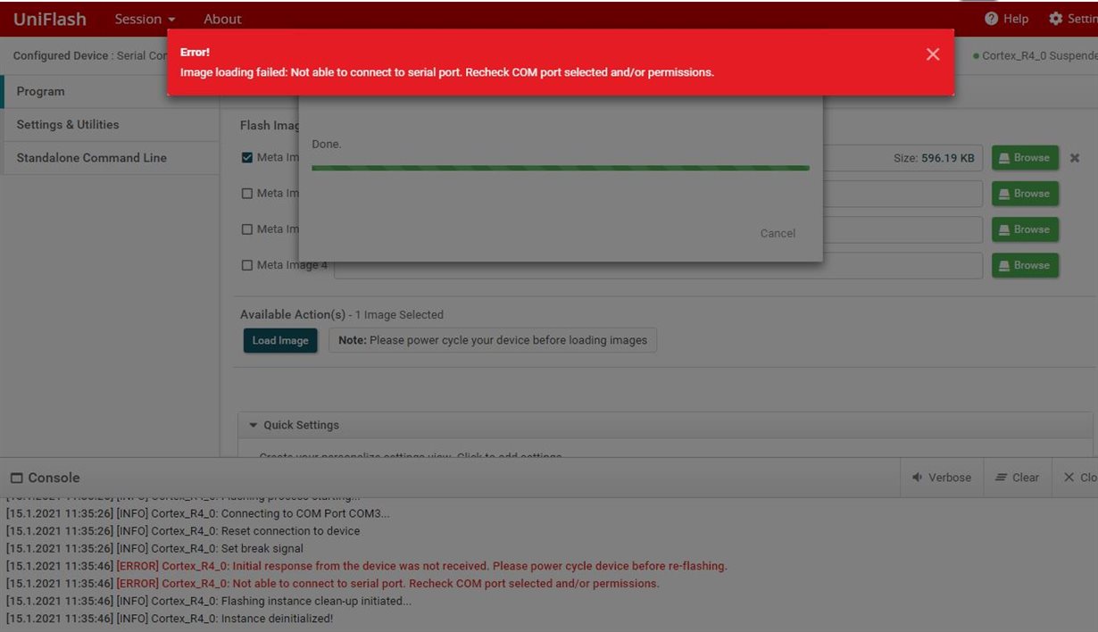

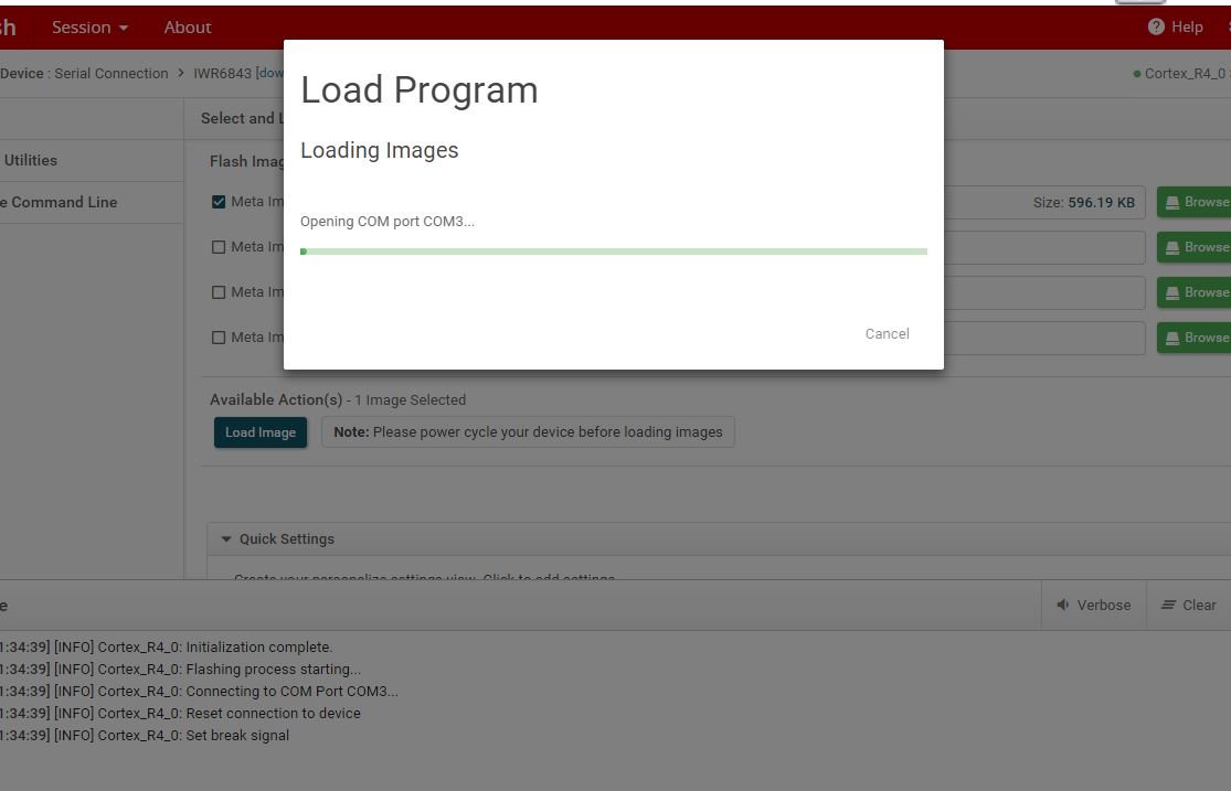

but it still doesn't work. We also tried pushing the reset button of the board and disconnected the PC from the network. We only started Uniflash and didn't have anything else running  in the background. See pictures below.

    The firmware downgrade requirement seems to have been fixed, as of our current testing. If you upgrade the firmware to the most recent release will the flashing work again? If you were able to flash the binary files before the downgrade and haven't changed any settings, it is also possible something went wrong with the downgrade process. Please try it with the most recent sw and let us know if you still see issues.

    It seems with the install of the XDS tools 9.2, the correct binary file is named 'firmware_3.0.0.1.3.bin'. This should be installed in the same /xds110 folder as before. Please try loading this file with the command 'xdsdfu -f firmware_3.0.0.1.3.bin -r'. This should install the new firmware.
    However, this firmware version shouldn't prevent you from flashing the sensor image. It seems the COM port might need to be reset. If the firmware upgrade doesn't help, please try the following.
    1. Close Uniflash
    2. disconnect power and USB from the ICBOOST PCB
    3. Set the jumpers for flashing mode
    4. Connect the barrel jack power to the ICBOOST
    5. Connect the USB cable to the ICBOOST
    6. Open uniflash and setup for IWR6843.
    7.Set the com port and try flashing.
    The power and USB cable sometimes need to be reset between flashes in a specific order. Hopefully this works.
