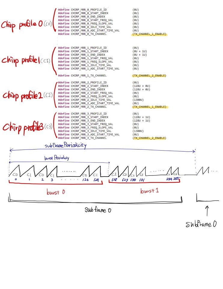

I would like to know the method configure the chirp setting likes the figure below.
number of subframe is 1,
number of burst is 2, (burst1, burst2)
number of chirp profile is 4. (c1, c2, c3, c4)
But I don't know which parameter, in MRR DEMO, should be modified to operate the AWR1843 with 2 bursts.
And how to assign the 3rd, 4th chirp profile to 2nd burst.

    I attach the figure as below. it is MIMO.
    And read the "src/common/cfg.c" file and modifed some value in "rlAdvFrameCfg" such as below.
    """""""""""""""rlAdvFrameCfg""""""""""""""""""""
    subFrameCfg.forceProfileIdx = 0
    subFrameCfg.numLoops = 64
    subFrameCfg.numOfBurst = 2
    subFrameCfg.numOfBurstLoops = 1
    subFrameCfg.chirpStartIdxOffset = 128
    subFrameCfg.numOfChirps = 2
    subFrameCfg.chirpStartIdx = 0
    subFrameCfg.subFramePeriodicity = SUBFRAME_MRR_PERIODICITY_VAL
    subFrameCfg.burstPeriodicity = BURST_PERIODICITY
    subframeDataCfg.numAdcSamples = number of adc sample * 2
    subframeDataCfg.totalChirps = 256
    subframeDataCfg.numChirpsInDataPacket = 1
    Is it correct value to operate the chirp signal as the represented figure below?

    I can't say for sure without experimenting with this on my own, but it seems to be on the right track. The subFrameCfg.chirpStartIdxOffset = 128 would ensure that the second burst starts from chirp index 128. For the screenshot you provided, the total number of chirps defined are 4 at indices 0, 1, 128, 129, so it should achieve the desired outcome.
