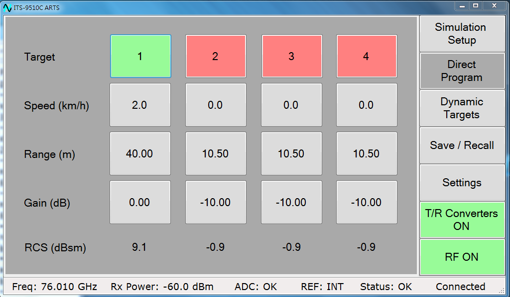

    The radar simulator we used is ITS-9510C and the test is done in our chamber. The distance between radar and simulator is 2.5 m.

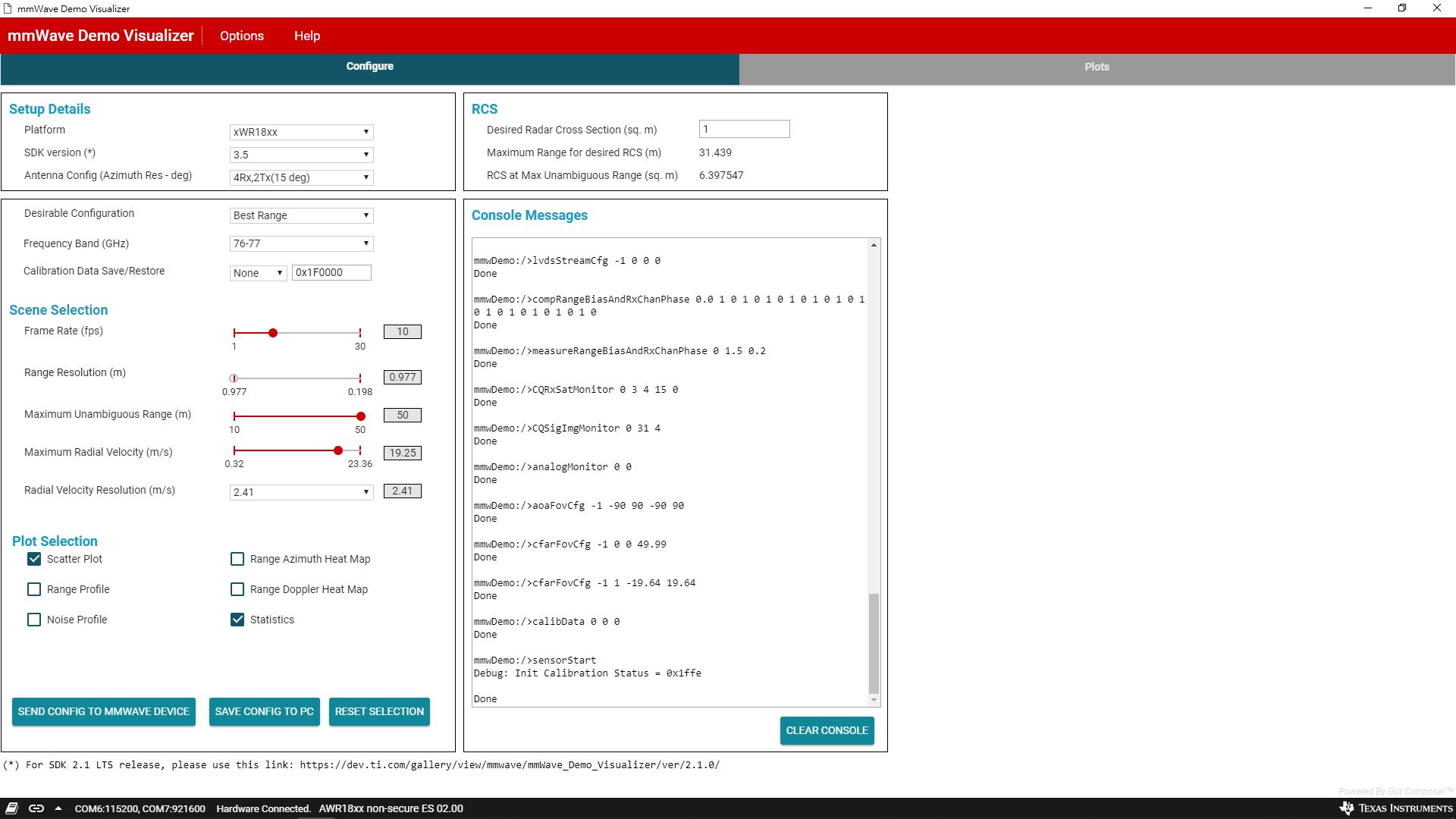

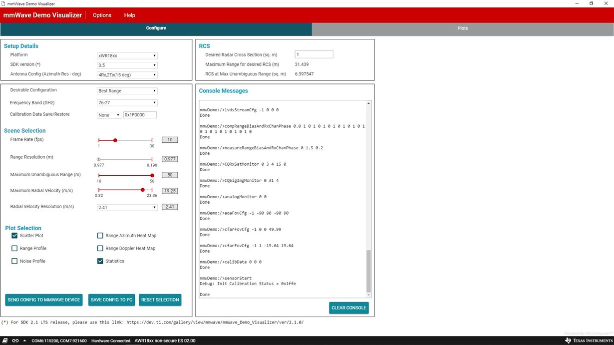

    After that, we applied the same config to both demo but the xwr18xx processes more unstable result.
    The setting and results of xwr16xx is shown as below.
    The setting and results of xwr18xx is shown as below.
    The radar simulator setting is shown as below.
    BTW, we also done some experiment on demo code of xwr18xx
    1. Compare with a 32-bit FFT processing calculation is implemented on DSP, and a 24-bit FFT processing calculation is implemented on HWA, is there any overflow or not-enough precision issue to make the AoA unstable?
    2. We have tried to modify “fftMode.butterflyScaling”, “source.srcScale” and “dest.dstScale” of dopplerprochwa and  aoaprochwa DPUs, but the AoA unstable is still occur.
    Do you have any comment about AoA unstable issue?

    I checked with the team, we have not observed something like this with our tests with target simulators. We have a few theories. Could you do the following to help us understand the issue better?:
    1. Attach the configuration and a few seconds of captured output data capturing the instability (record start and stop in the demo visualizer). Could you also do the same for the 1642 device in the same setup without the instability? Please enable range and noise profile before capturing the data.
    2. I can see that the peak in the range profile for the 1642 device is more prominent as compared to the 1843 device. Could you increase the RCS and test with the 1843 device to see if a stronger signal eliminates this issue?
    3. Could you see if the same behavior is observed while using a strong reflector? This is to rule out the radar simulator as a potential cause.
