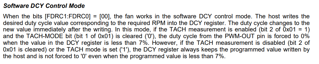

I have following customer request, can you please confirm the use case?
To give information about the application:
At this stage, I will not use the remote temperature sensor feature, I will adjust the duty cycle and see if I can drive the fans at different voltages and drive at the required rpm.
